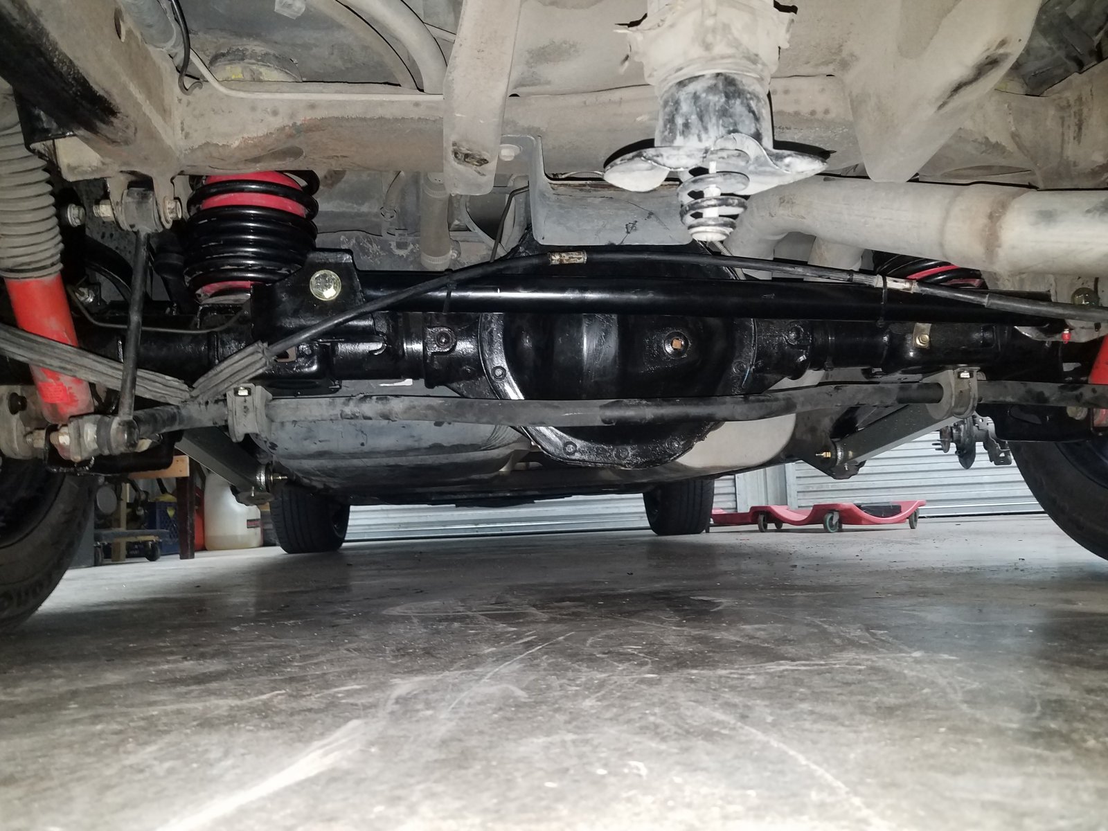

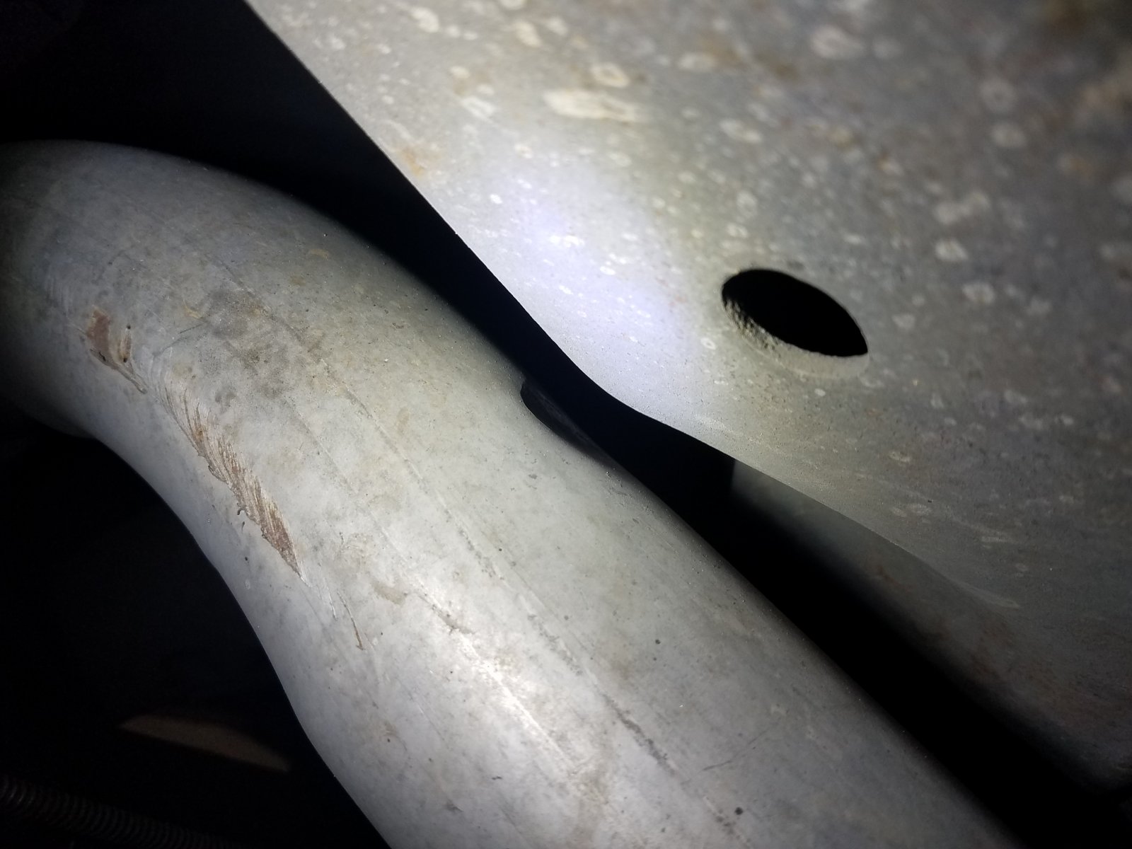

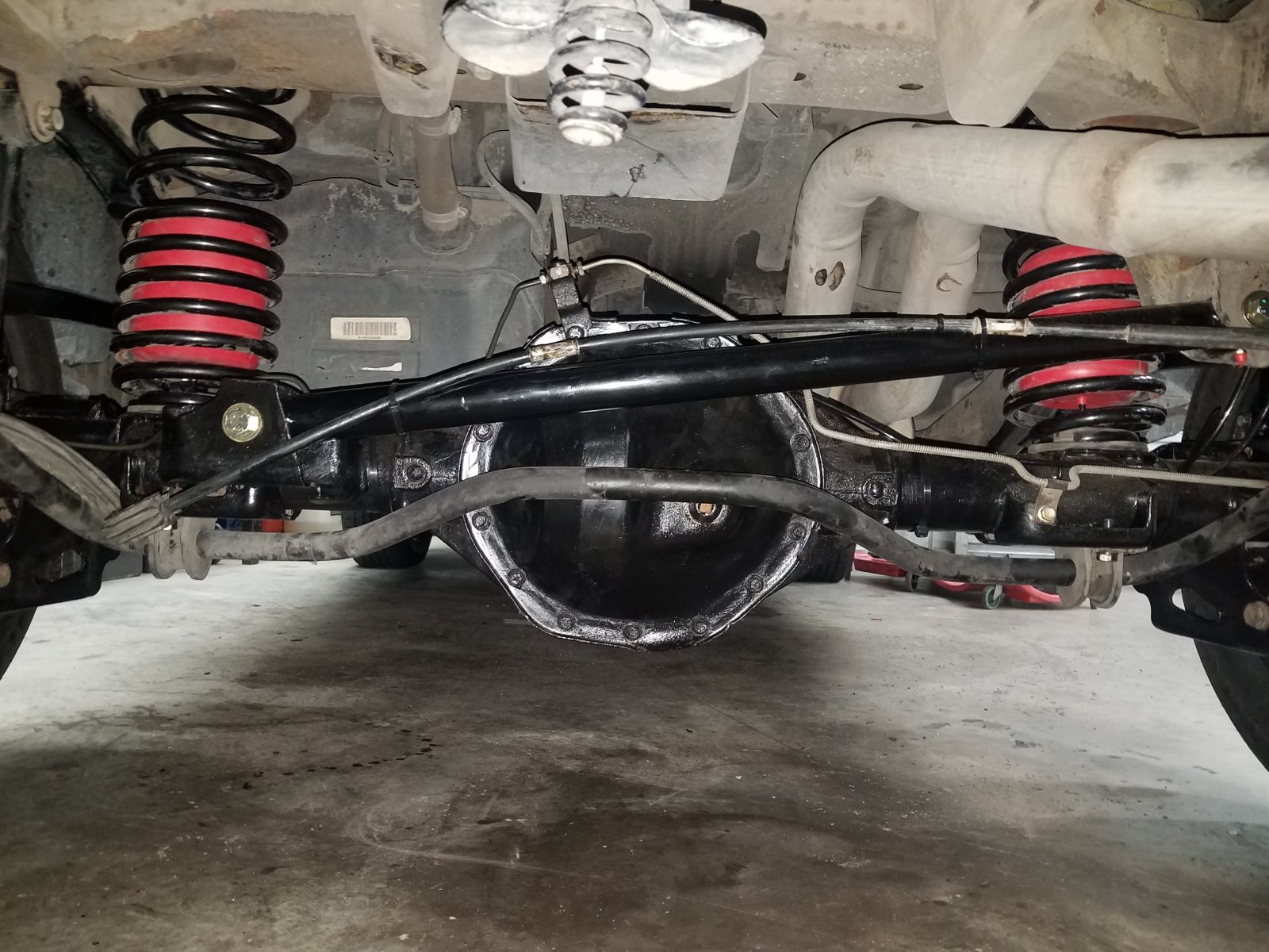

Actually on hard launches the exhaust is now hitting the spare tire cross member. Kinda strange since I didn't low it any more. I guess the bump stops were limiting it before. When I get air in the bags it may cure it but I will likely notch a little out.

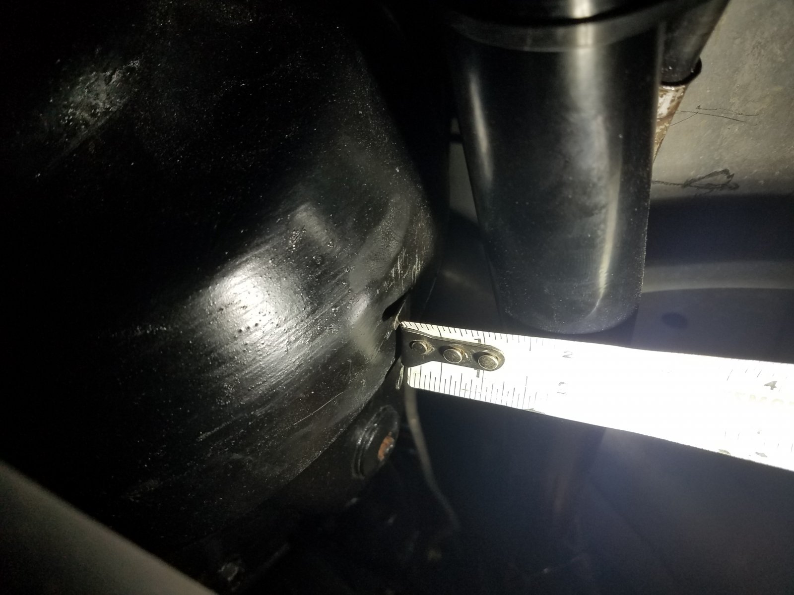

Also I have a little less than 1" between the panhard and diff cover. Glad I got the QA1 curved bar. Going to email some companies tomorrow and see if their covers will fit but I'm thinking not. Not a big deal since the 9.5 isn't known to suffer terribly from carrier deflection.
Sway bar ended up with plenty of room so I'm still on the hunt for a hellwig!
I will try to update the first post tomorrow with a breakdown of what parts and mods were actually needed.

Strange I was going to update the first page with an exact breakdown of what parts need to be ordered and modified to do this swap. However it doesn't give me the option to edit my post like it does all the other posts in this thread.
So you have a GMT800 SUV and you want a better rear end for well under $1,000. Find yourself a rear end from a GMT900 SUV with RPO code AXN which has the 9.5" ring gear, 14 bolts on the rear cover and 33 spline axles. I used one out of a 2011 Yukon Denali.
Parts needed to buy:
-AXN coded axle with your choice of gear ratio
-U joint that is GM 3R on one side for the factory drive shaft and 1350 on the other. Part number (5U211-Neapco)
-QA1 Panhard bar (With the bend in it) Part# QA1-5262
-Zipties to secure parking brake to panhard bar
Parts needed to reuse off your original 10bolt rear end:
-Parking brake/splash guard
-Brake rotors, calipers and pads
-Brake lines from both sides
Overall the swap was very easy and can easily be completed in 1-2 days.

up a few posts i have the spohn adjustable car with the del-phere ends (straight) and its only a few mm from the cover. pretty large diameter but i doubt the hellwig will have much more room

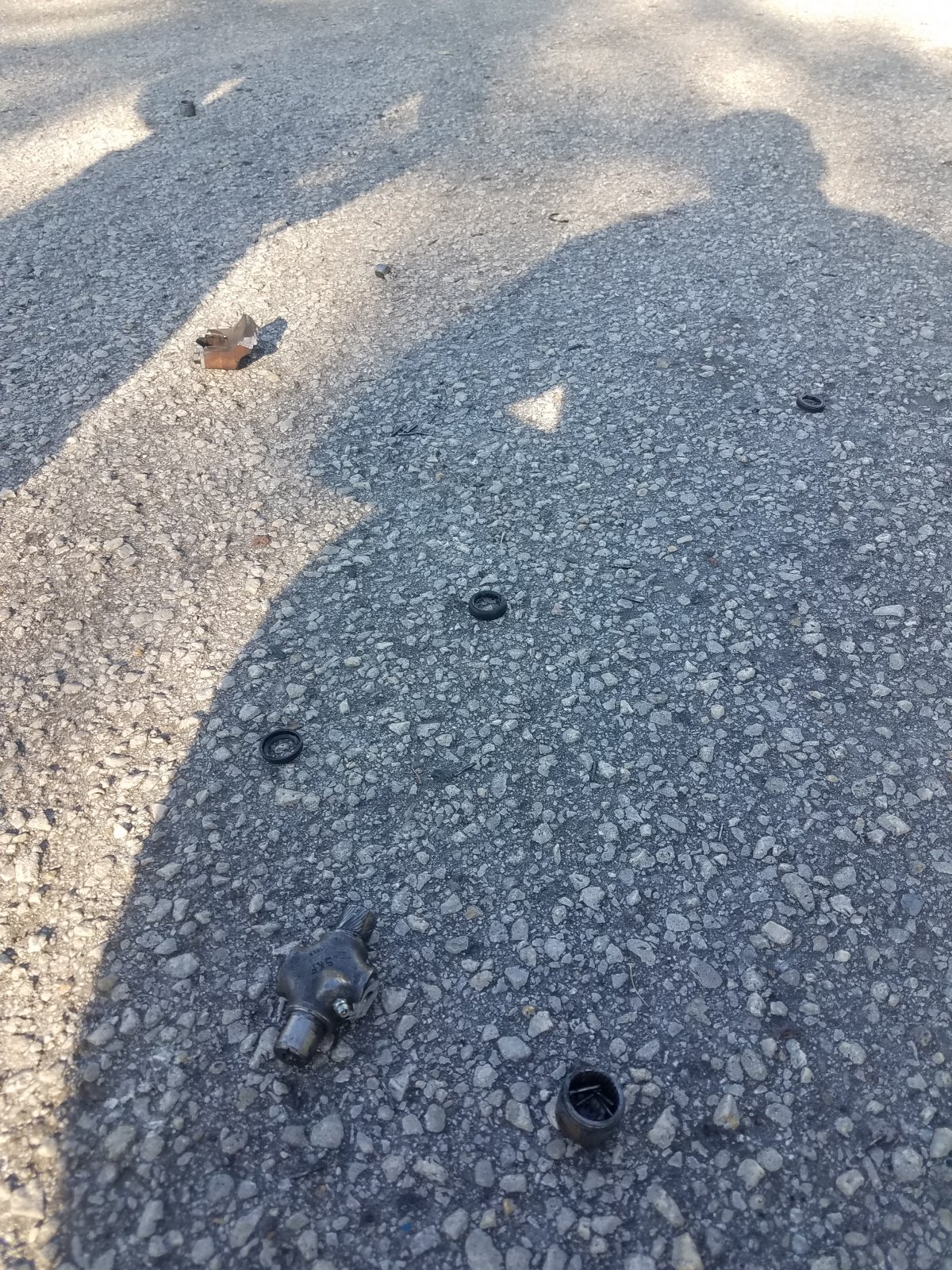

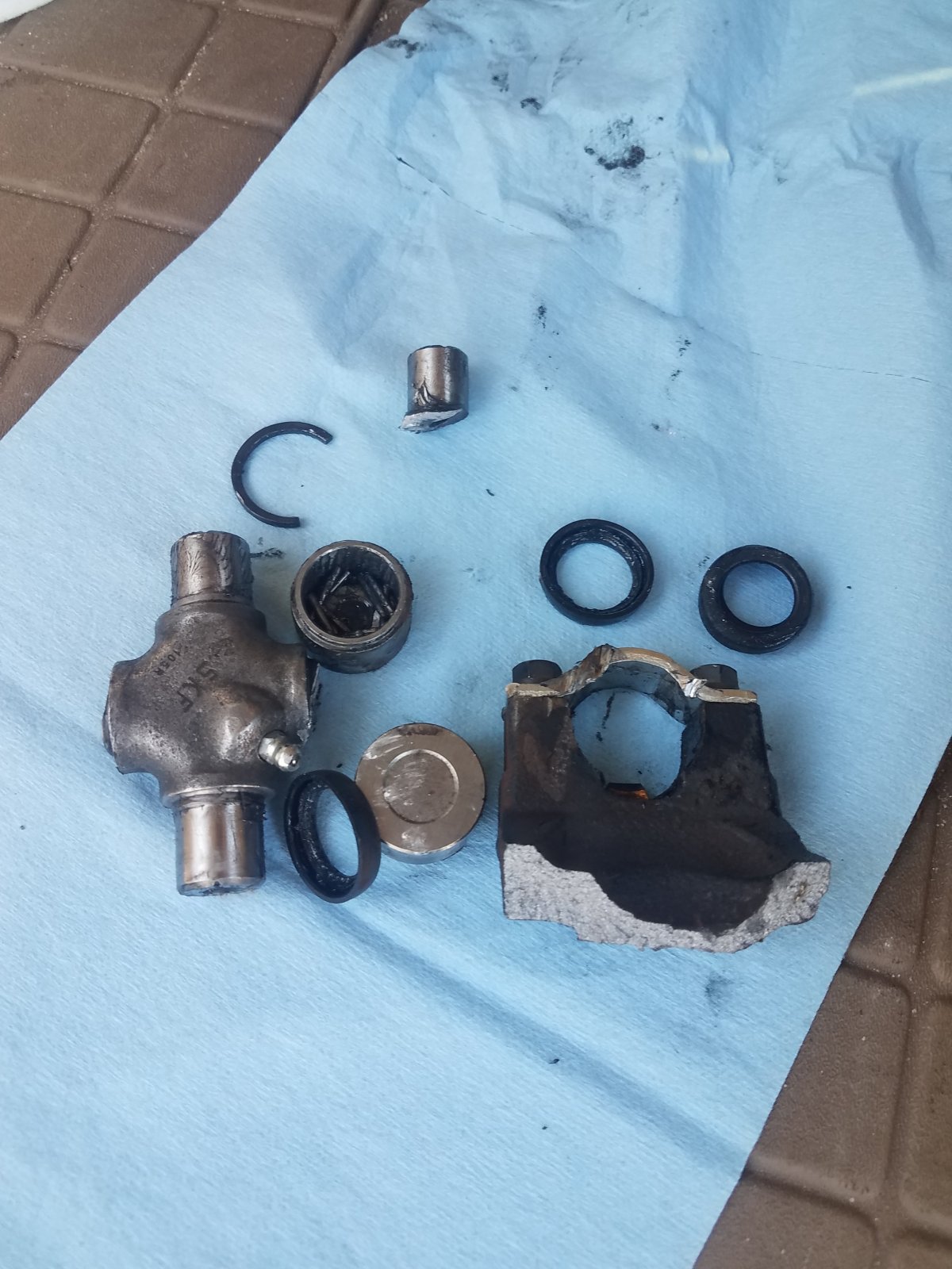

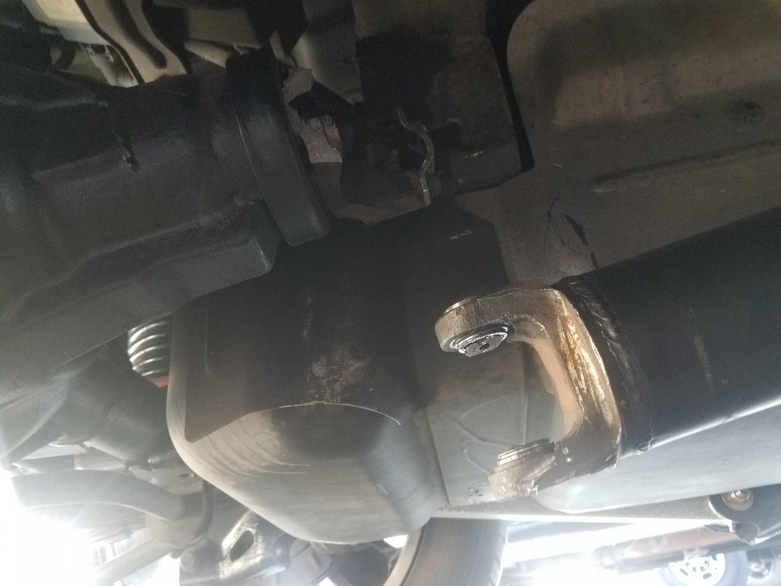

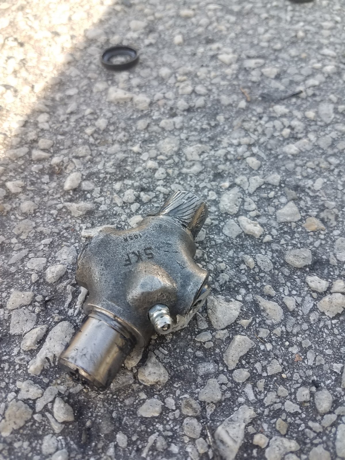

was that the convertible ujoint from 1310 to 1350?
go non-greasable joint... if you dont trust the oem yoke i think a few manufacturers make them... check spicer, moser, strange, yukon
Yep the conversion thingy. It was greasable which was really the only one I could find in stock at the time but I think the yoke broke first.
A buddy's theory which makes sense is that at the junk yard the axle was likely dropped on the yoke causing a micro crack. It did appear to have been drug on concrete a time or two because the OEM diff cover was all bent up on the bottom when I got it. So makes sense. I'm gonna go get whatever yoke and U joint that is in stock at Advanced Driveline down town. Hopefully an upgraded yoke and non greasable joint. I'd pull the shaft and have it redone for a 1350 so I can run a straight 1350 but the shop is several weeks backed up.

My buddy is actually gonna throw a yoke and U joint in it tomorrow while I'm at work. Hopefully tomorrow I can do the same thing except I'll spritz the tires with some tire shine to help lesson the initial impact of the clutch dump. I'll also cross my toes and hope the new stuff stays together.
