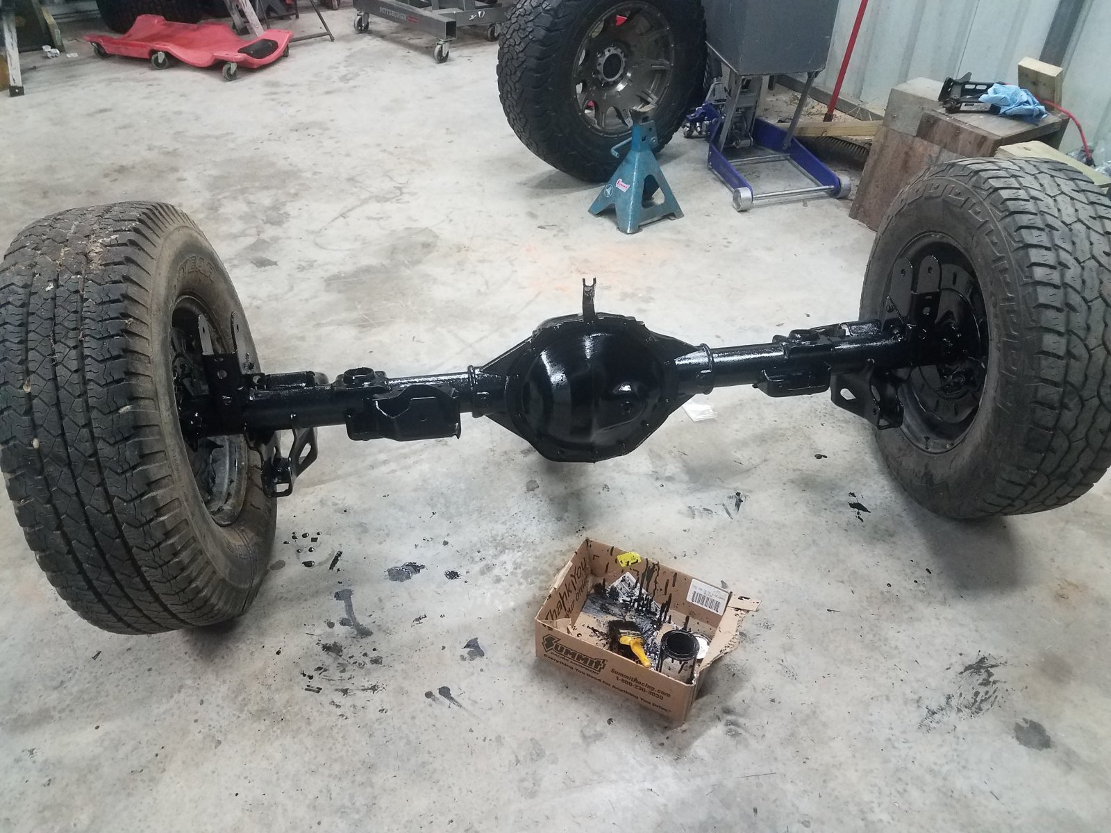

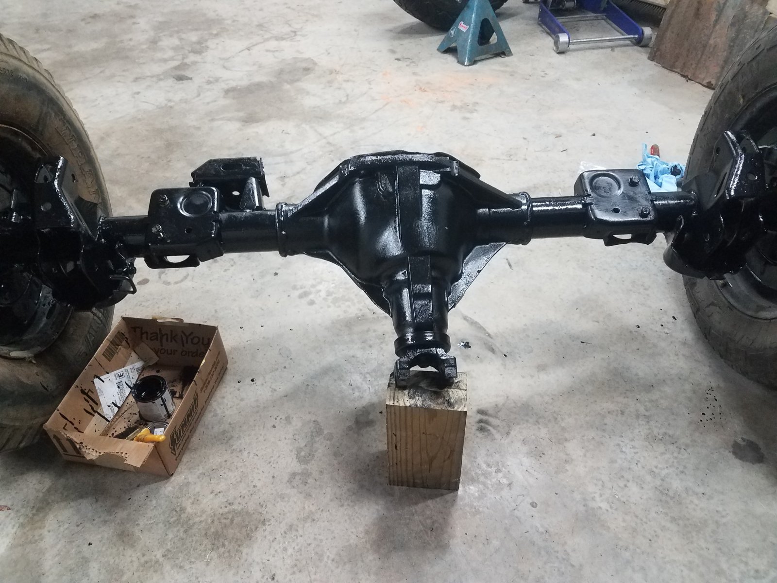

Tomorrow evening I'll pull the links to compare them to my gmt800 links, hose the thing off and remove the already cut parking brake cable.

Weather was terrible this weekend but managed to get a little done. Got the links, sway bar, brake lines and parking cable removed. Didn't realize the GMT900 trucks had rear ABS sensors. Ended up cutting the wire at the sensor so water doesn't get in the hole. Also beat the brake heat shields straight again and hit it with some purple power to get it ready for paint this week.

I'm basically waiting for the Spohn lower links to get in and a set of lug nuts. I got a set of Maypop tires to use as rollers so when the lug nuts get in I'll tractor the axle to my garage and paint it up. I'm really hoping there is a considerable amount of room between the diff cover and the panhard so I can get a fancy looking diff cover and panhard bar.

Another nice reason to get GMT900 axle is the fact that they are likely to have less miles and look cleaner overall. For example this one I just got was the absolute cheapest one I could find and its what I would consider an 8/10 for outside appearance and 9/10 for inside.
