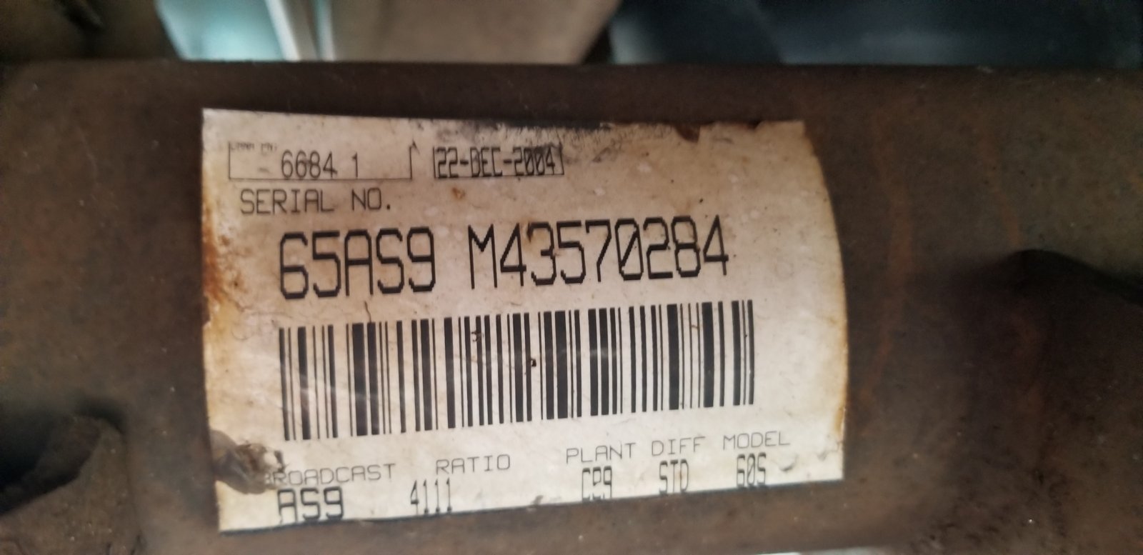

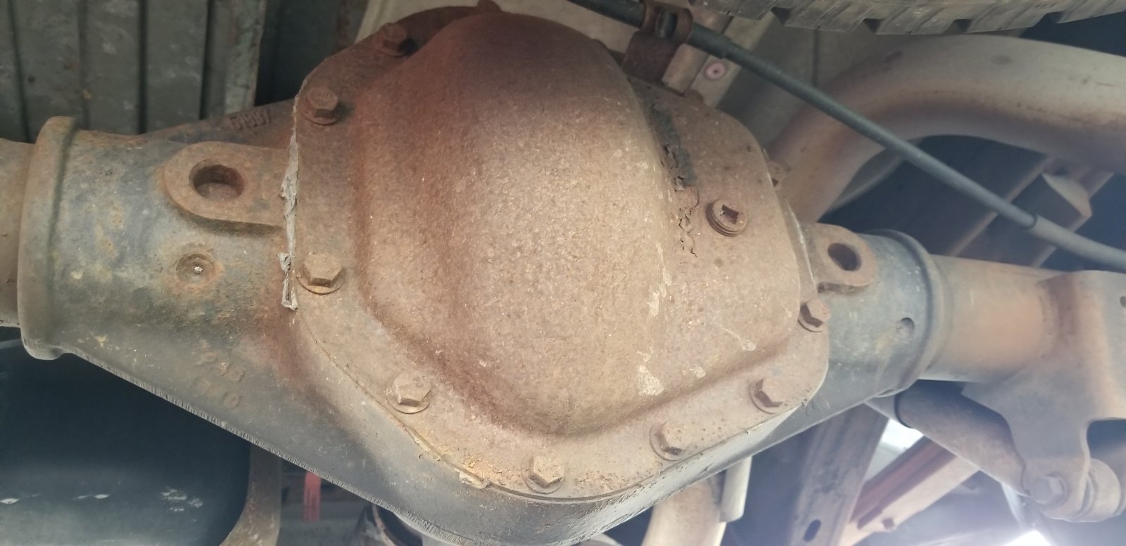

Damn! Sorry to get your hopes up. I could've sworn I saw an AXN on the sticker.
Sorry if I got your hopes up Dan.

Damn! Sorry to get your hopes up. I could've sworn I saw an AXN on the sticker.View attachment 243708 View attachment 243709 View attachment 243710
12bolt? Must be a 2015+ right?
