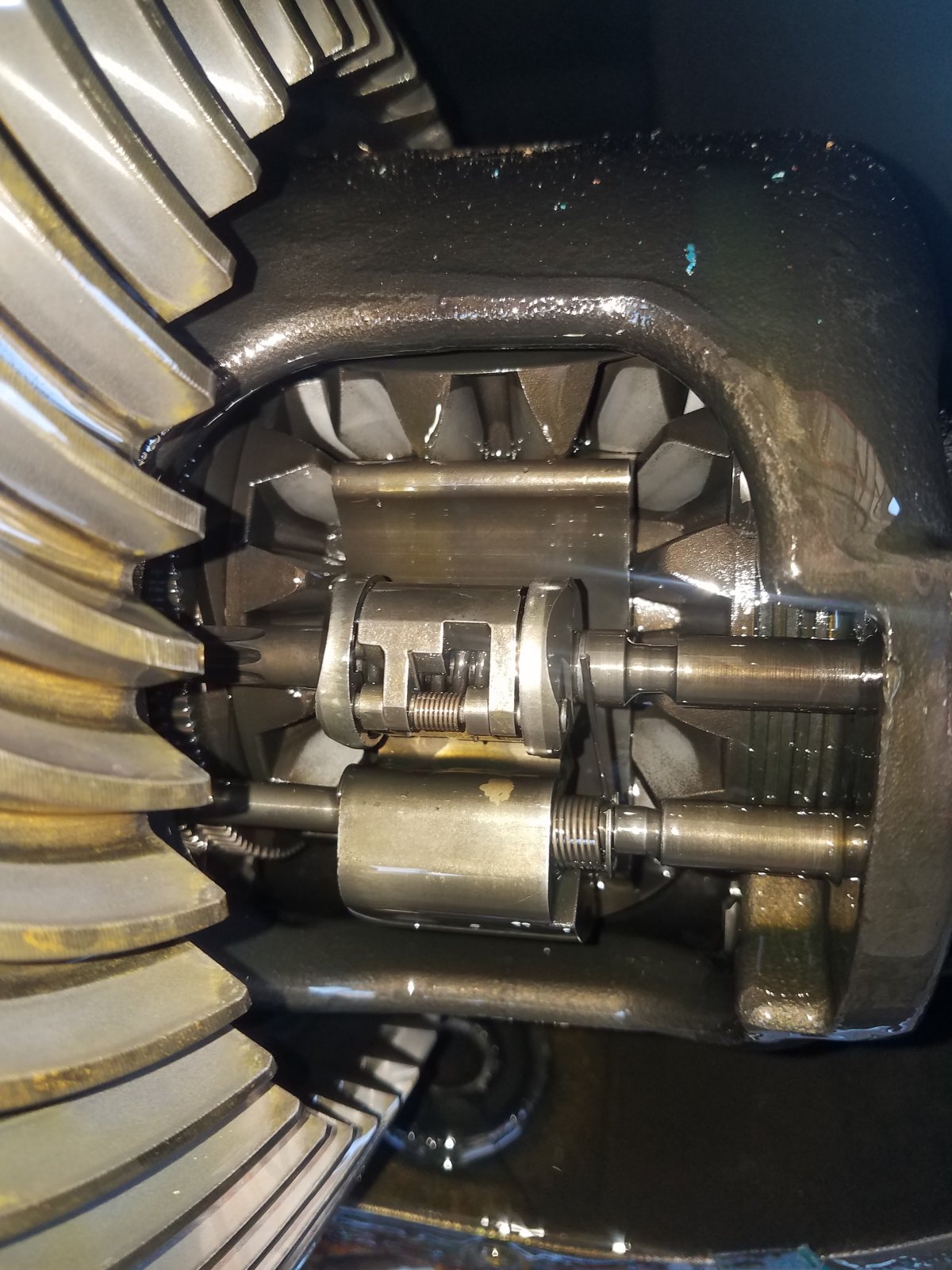

Got a good bit done tonight. Gonna have to source different or make my own brake lines. Need a different U joint strap for the 1350 on the axle side. Other than that parking brake is good to go shocks are bolted up as are upper links. Lowers are bolted to frame just gave up bolting to axle because I had to go do some data logging for a buddy.
Used a huge stainless fender washer and some grade 8 bolts to add to the bling bling of the lower links.

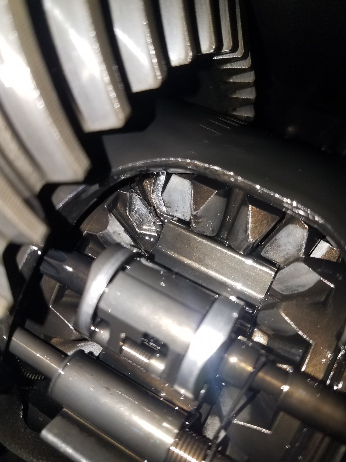

Crazy how big the 9.5 looks shoved up in it's new home. Also here's some G80 spider gear missing teeth from the 10bolt. Guess it was on it's way out.

Yikes, just in time eh?
On the GMT900s with the 9.5 axle, there are two part numbers specific for brake lines for use with that axle. 176-1541 and 18J4618. I remember Randy saying he didn't need new lines when he installed his but I kept the numbers just in case.
Yep I had no idea it was ready to blow. The PO said he blew up a Yukon Duragrip when the truck had 4.10s or 3.73s. After that he found a used G80 and 3.42 gears to stick in it. So I assume it looked nice and new a year or so ago.
