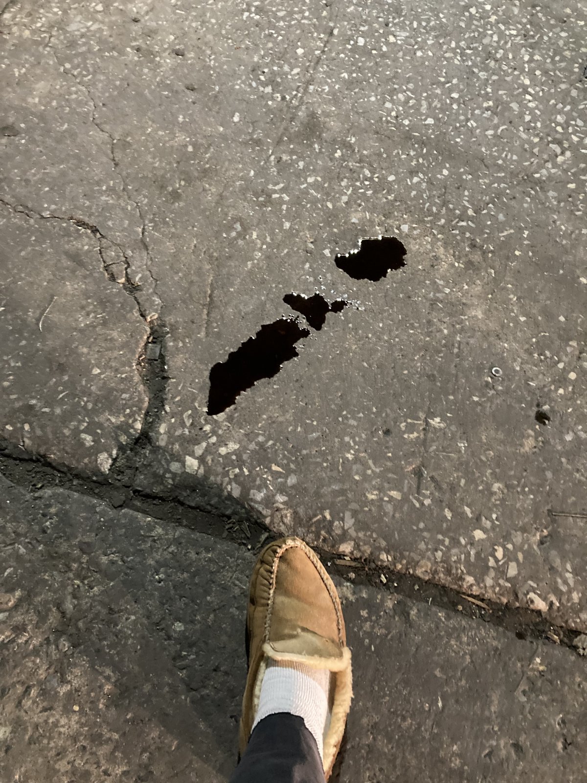

Where's she leaking from?
Also, looks so much better. Good job brother. Glad you got it done before the weather. Just started snowing here about 30 min ago. Grass is covered and starting to stick to the road.
Rear main or oil pan

Have you done the updated valve cover? That seems like an excessive leak and thought if you hadn't changed the cover, it may be building crankcase pressure and making the leak worse
Updated valve cover, catch can, new VLOM, billet oil pressure block off. Only thing left is front seal/oil pan/or rear main. It leaked a full quart this past week. I have to top it off every Sunday. My parking spots look like grease pits. Sick of it.

Good mechanic can have that rear main seal swapped in a day, if it's on a lift. That sucks buddy
randeez
Sep 29, 2017
8,170
25,874
south florida
thats quite a bit of oil to be losing at a time
2wd? makes scooting the trans back 10x easier
the RMS itself comes complete with the rear plate and takes about 10min to swap

Should I bother with such high mileage? I'd rather just get the new engine and be done with it. Start saving for a trans refresh afterwards.
Does the engine run good otherwise? If so, I would just say do the rear main seal and keep on trukin'. That's a lot of oil loss.
The seal itself is very inexpensive. It's all the work though. If this was a rusty piece of junk, probably not worth it, just keep topping it off. But your truck looks pretty clean. I'd go for the rear main seal.
OTOH, a fresh new engine/transmission is a good amount of cash.

qt/week is prob cheaper
I did contemplate fulling the front diff/shaft/axles to at least put a new pan gasket and see if that makes any kind of difference. At least cut it in half. Plus the p/u tube o-ring and oil deflector. I just keep getting this feeling I am on borrowed time with the valve train.
