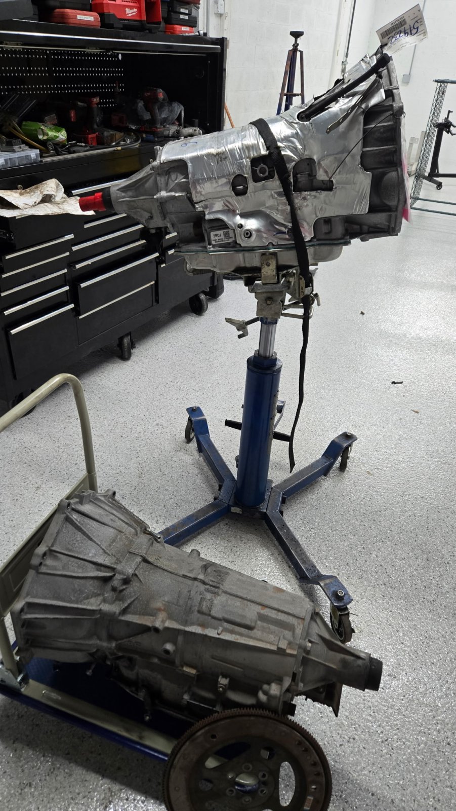

I had a local custom builder do the 10L80 swap on my 2012 Tahoe. The same guy swapped my 5.3 for a tuned and cammed 6.2L L97 motor about 2 years ago. The increased horsepower eventually took out my 6L90 with 135k miles on it. He used the PSS harness, I bought a 2024 10L80 with 4k miles on it out of a wrecked 1500. He used an OEM converter that matched up to the 10L80 and he had to figure out the right flywheel for spacing. He also upgraded the trans cooler and lines. The 10 speed has drastically changed the performance of the truck. First gear is super short and then right into the power band.
The stock TCM tune needed quite a bit of adjustment but I think part of that was because it’s not my stock 5.3 motor. Gas mileage has dropped 3mpg. The trans is holding in gear a little longer than we would like but when we make further tuning adjustments nothing changes with the shifts. My guy has some custom builder friends that did a 10L80 swap in a TBSS. He’s gonna reach out to them for some input on tuning it further. I expected some issues like this so if you want to do some custom work be patient and prepared for delays and issues. I don’t drive far on a daily basis so I can deal with the lower mpg especially for much better performance. All in all I am very happy with the swap. My guy also had a hard time getting in touch with PSS but he did say that once he got them on the phone they were very helpful.
