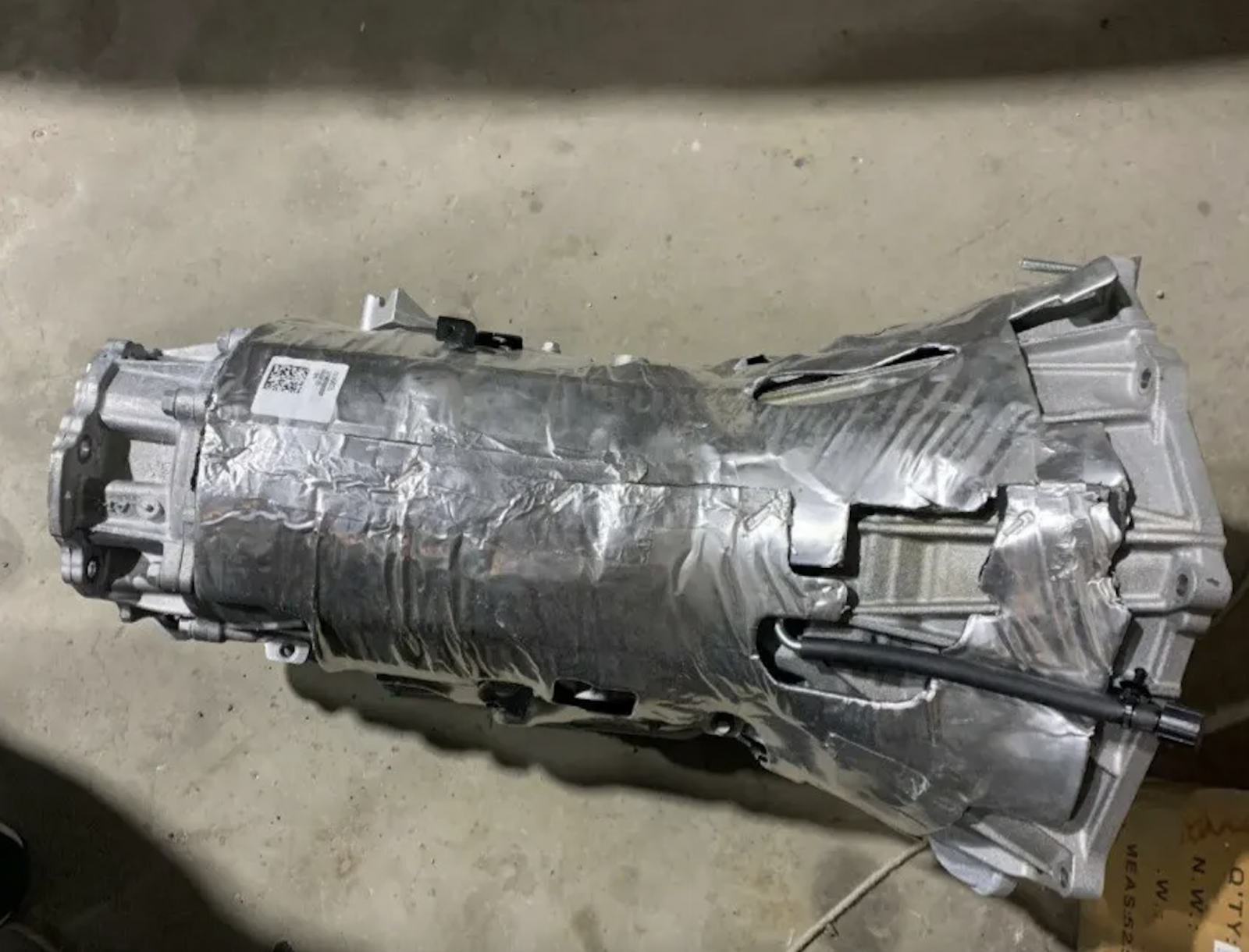

10L90 from a 4x4 with 20k miles, currently listed on eBay for $2,500 buy-it-now, free shipping included
