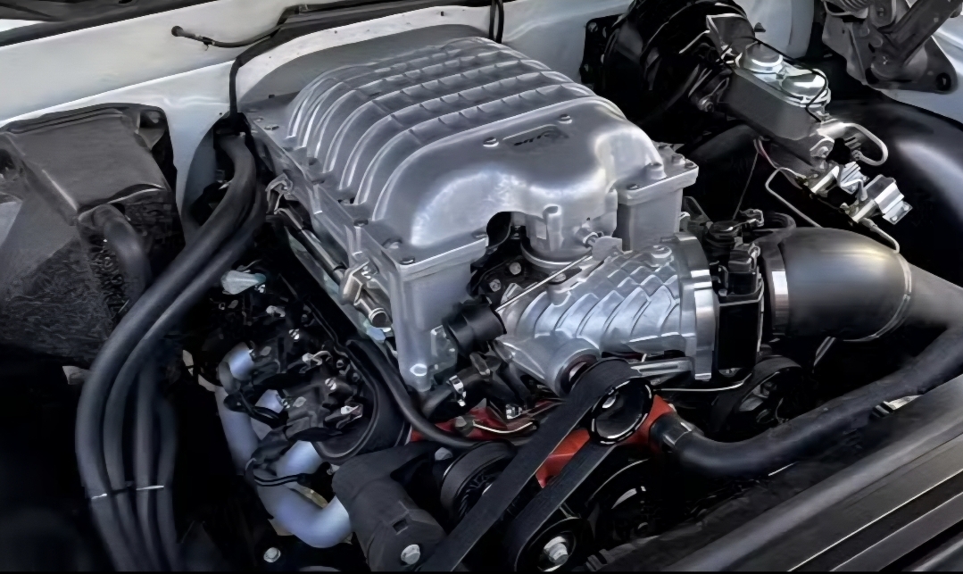

Exactly. And to top it off add a Hellcat supercharger on top.

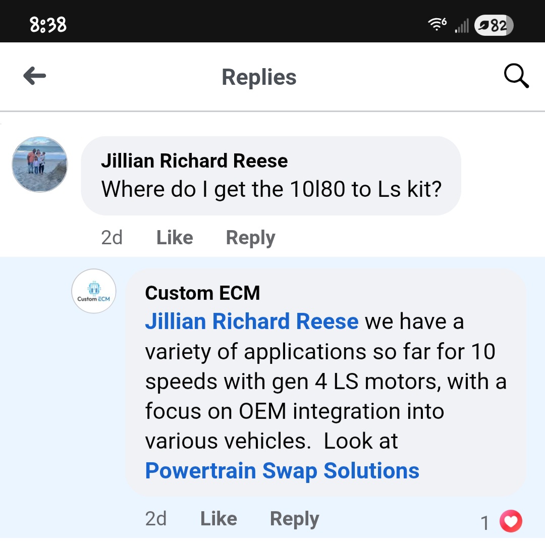

There’s another company that’s been doing 10l80e 10 speed swaps also.
Custom ECM
(I don’t have Facebook so not sure how far that link gets you).
Not sure if they’ve done any GM full-size SUV’s, but they have done an F Body Camaro and a Hummer H2. I think they’re a little newer to the 10 speed swaps than PSS.

Here is their website
Just FYI this is one of the comments on a video on the Facebook page. For those who want factory looking swap
Bigburb3500
Jun 7, 2024
851
1,333
Just FYI this is one of the comments on a video on the Facebook page. For those who want factory looking swap View attachment 470760
Thanks! I’m reaching out to them to see what they can guide on because they seem a lot more responsive based on the Facebook page.

I’ve been digging around on Custom ECM’s Facebook page. I think Powertrainswap is still the only game in town as they developed most of the swap “kit” and Custom ECM provided the coding to keep the truck happy and factory fresh. Still researching.

Re-upping with some new info. Got a response from Custom ECM and they said the 10sp should bolt right up to a LS with only the top most bolt not lining up. Leave it out and you are good to go. 6L90 in my truck might even have the correct 6 bolt flex plate but that might be the only major modification/addition needed.
