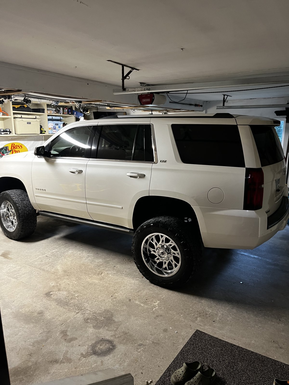

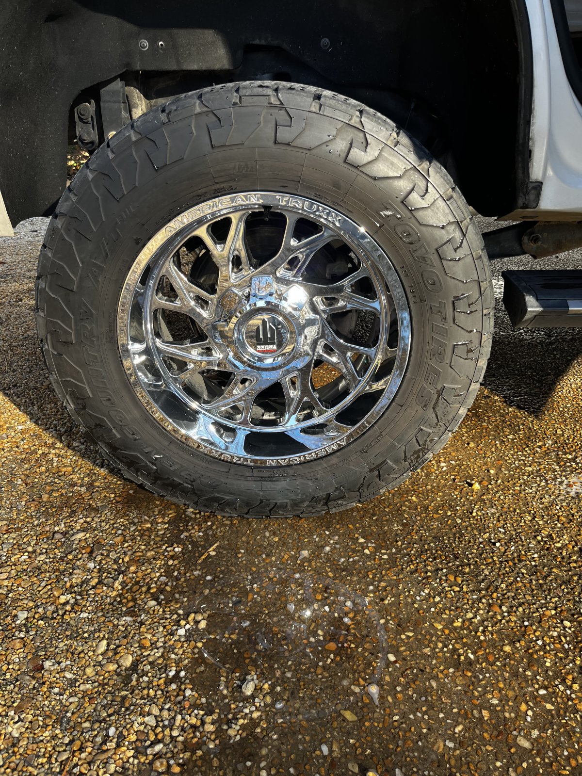

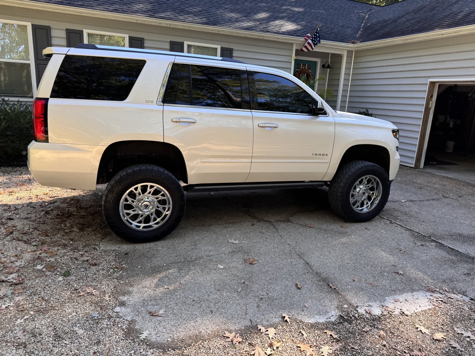

2015 LTZ Bds 6 inch lift American truxx 20s with 35 1250 Toyo open country at
Slight trimming on bumper plastic. Almost doesn’t fit under the 7’ garage door.

What does that kit have in terms of a rear spring?

This kit was designed to keep the magnaride and air shocks. The springs are larger springs no spacer. I have replaced the air shocks and front struts with bilstien 5100s

Looks like they use Pro-ride coil springs. I would be curious how much of a lift they deliver by themselves.

More than likely somewhere around 4-5”, to give it a level stance.
