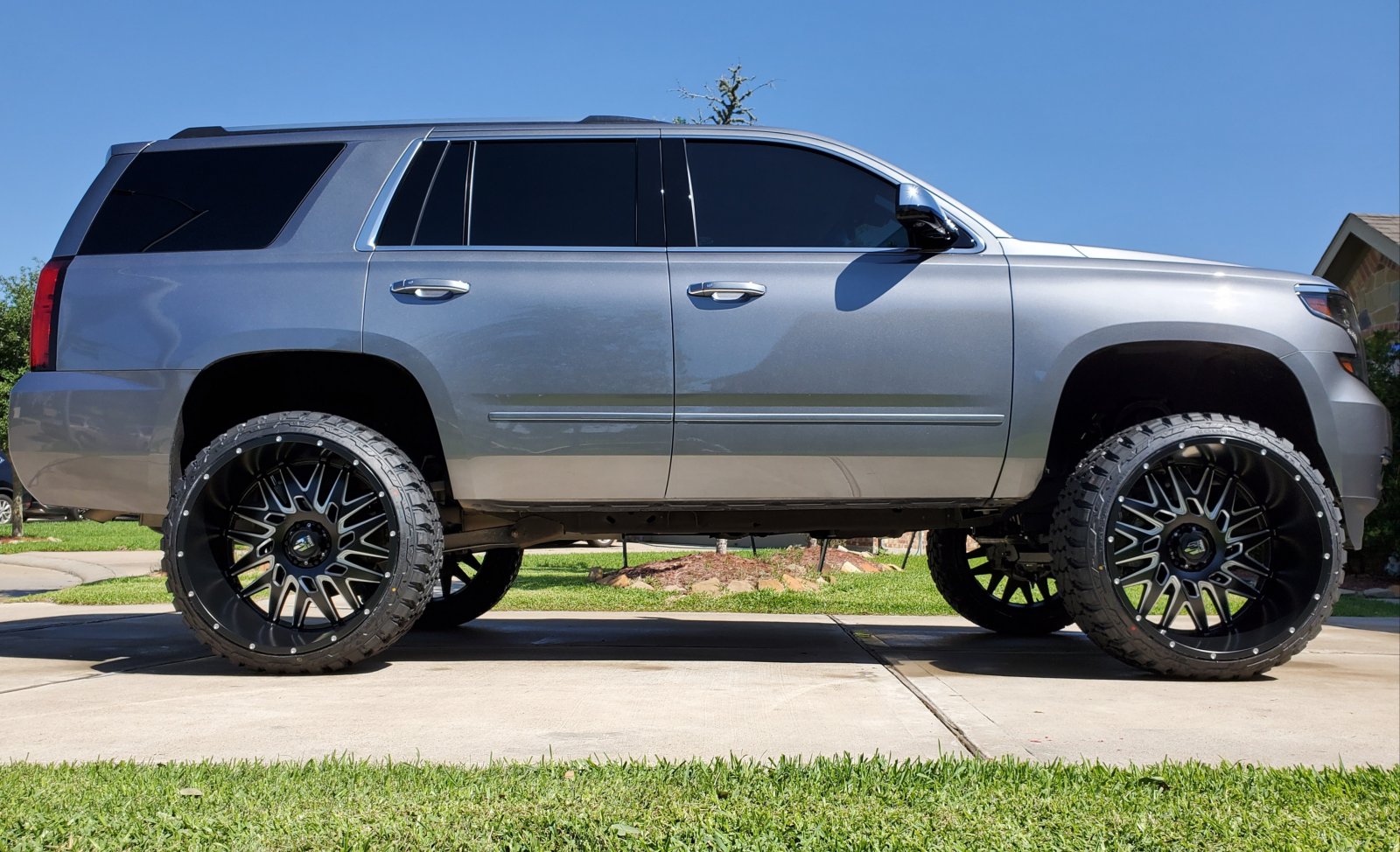

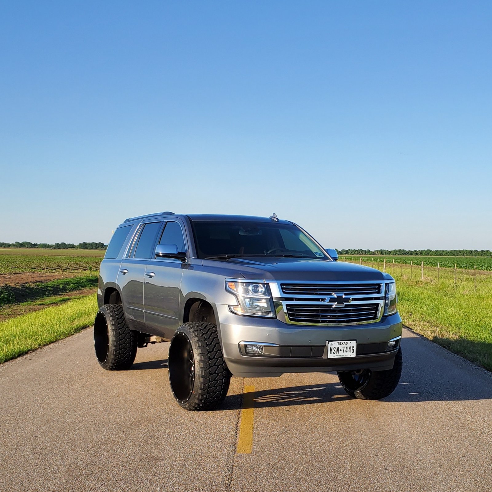

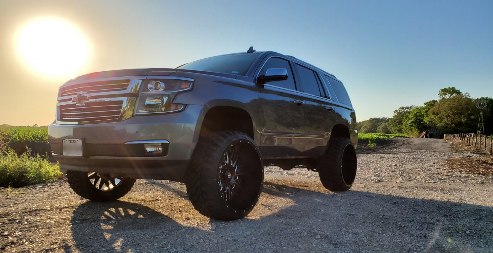

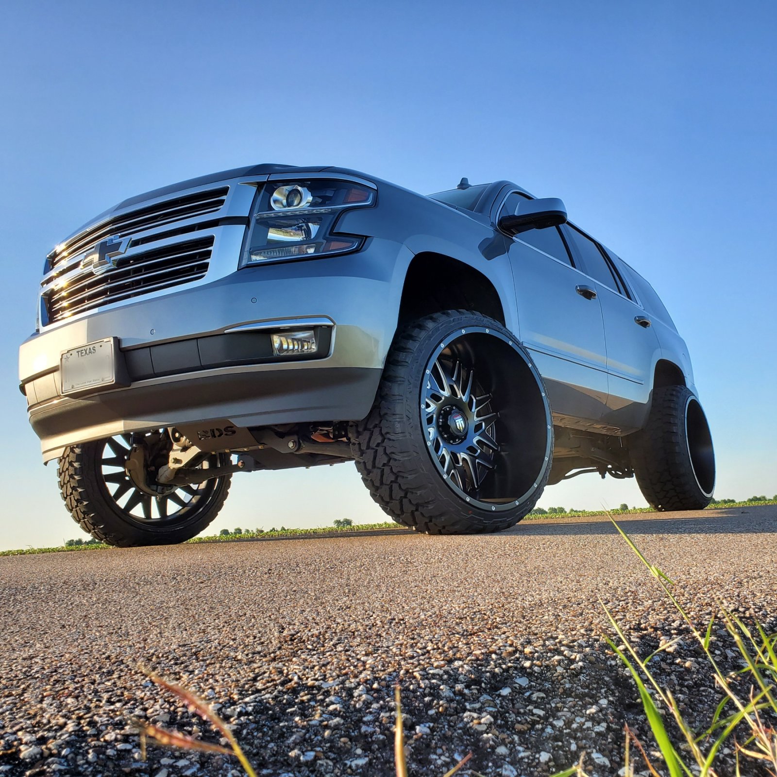

Last week I pulled the trigger and ordered a 6 inch BDS lift kit and some American Truxx 26x14 DNA wheels with a set Fury MT tires in 35's. Everything was installed over the weekend and I'm extremely pleased with how it all turned out...my only gripe is the steering seems a bit loose compared to what it was. Other than that its a blast to drive!

Wow! Any rubbing with that wheel setup?
Yea, theres no way in hell that thing will steer like it did before given your tire/wheel setup.

Yeah I get some minor rubbing right before I get to full lock but it took some major trimming to get there.

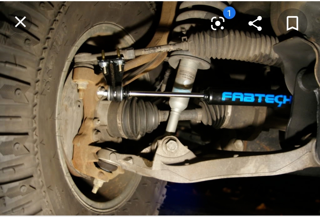

Would a steering stabilizer help firm up the steering a bit?

where do you put a steering stabilzer or even 2 on a rack and pinion electronic power steering system? thought that was straight axle concept

I've seen them on lifted Silverados. I could not find a silverado pic, the pic below is from . F150

Any close up shots of what needed trimed?
Awesome looking setup, I haven't decided which setup to go with on my 17 Tahoe.
Scott
Thanks, I'll try to get some pictures tomorrow but to fit that combo the amount of trimming/cutting involved definitely isn't for the squeemish or faint of heart...it was a ton
