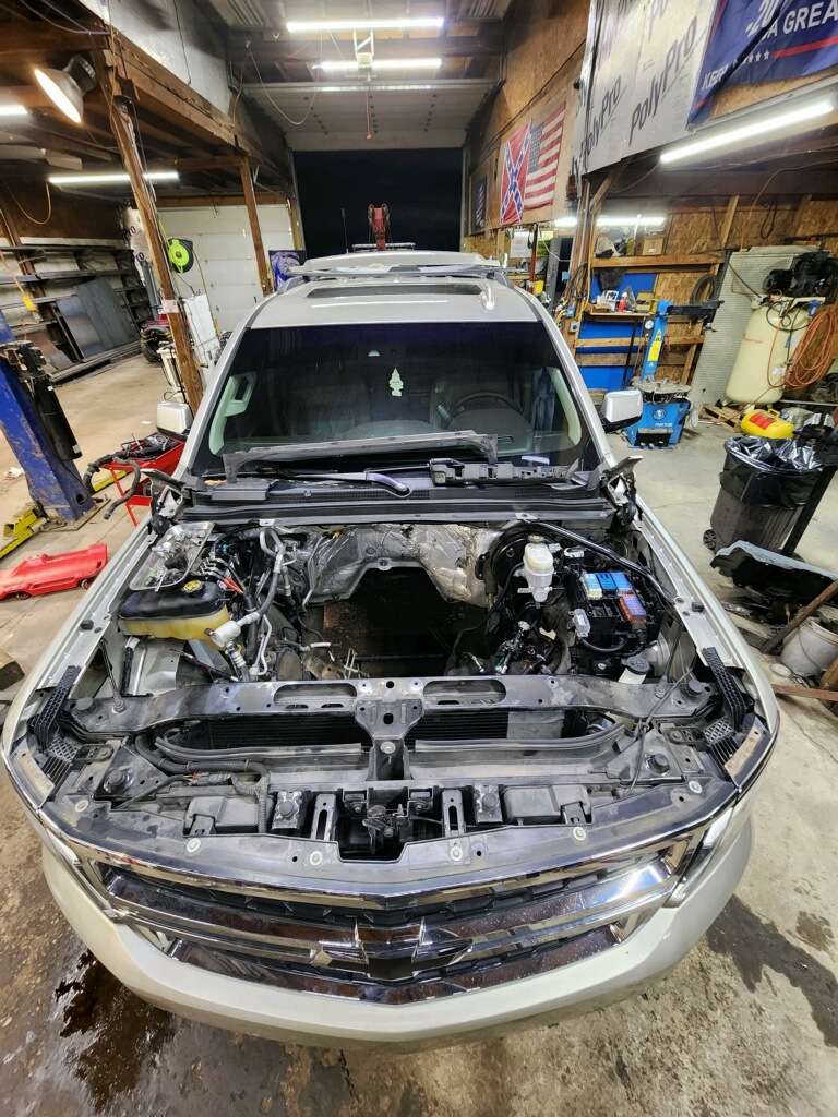

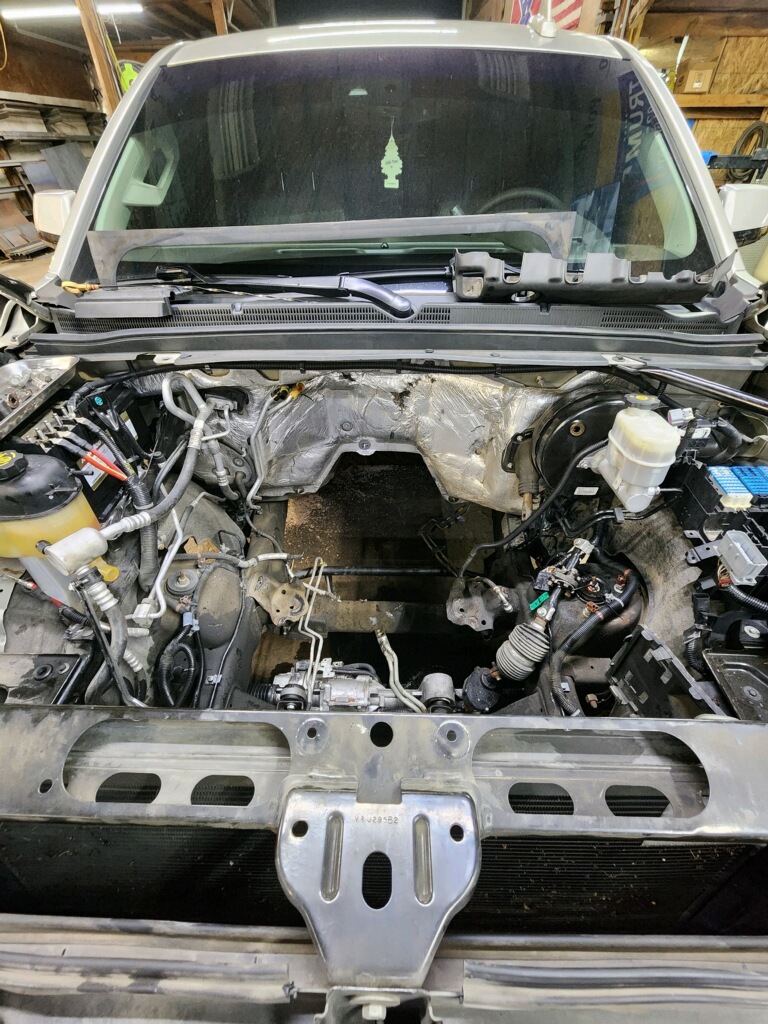

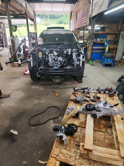

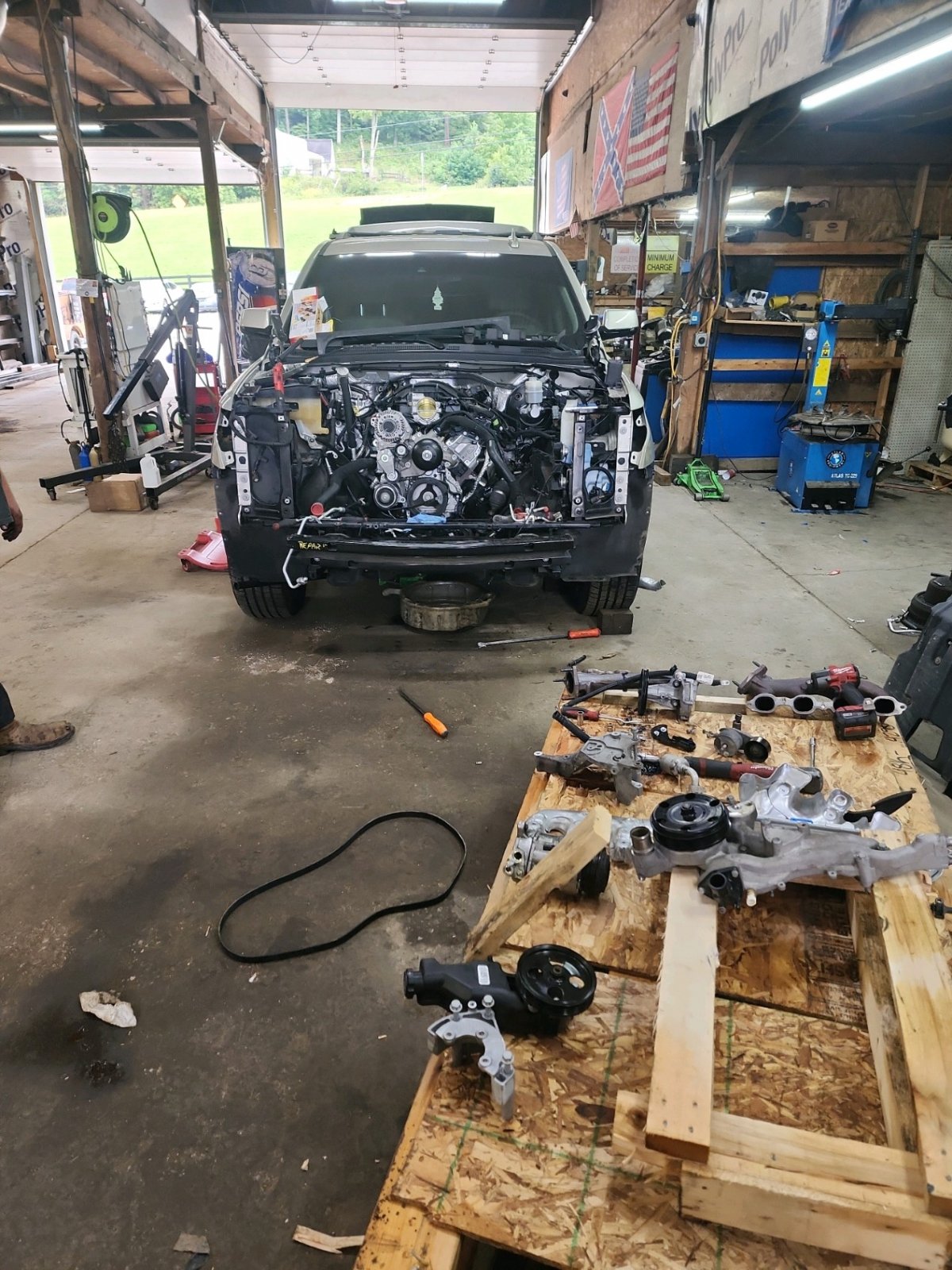

My technician is in the process of pulling my old engine and transmission out today! I believe the current plan for the vacuum pump/brakes is to tap into the pcv system for the vacuum needed to the booster. He rattled it off real quick and talked over my head a little lol.
I did google and it seems that most who delete the vacuum pump have had the most success when running a vacuum off of the pcv system. I'm not 100% on the details but he seemed to believe it'd work fine.
Details still to come on the power steering. I will update when I know more! Pics of it in the operating room, lol!!

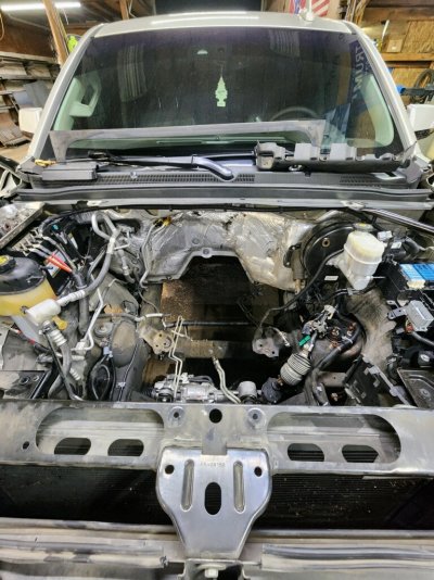

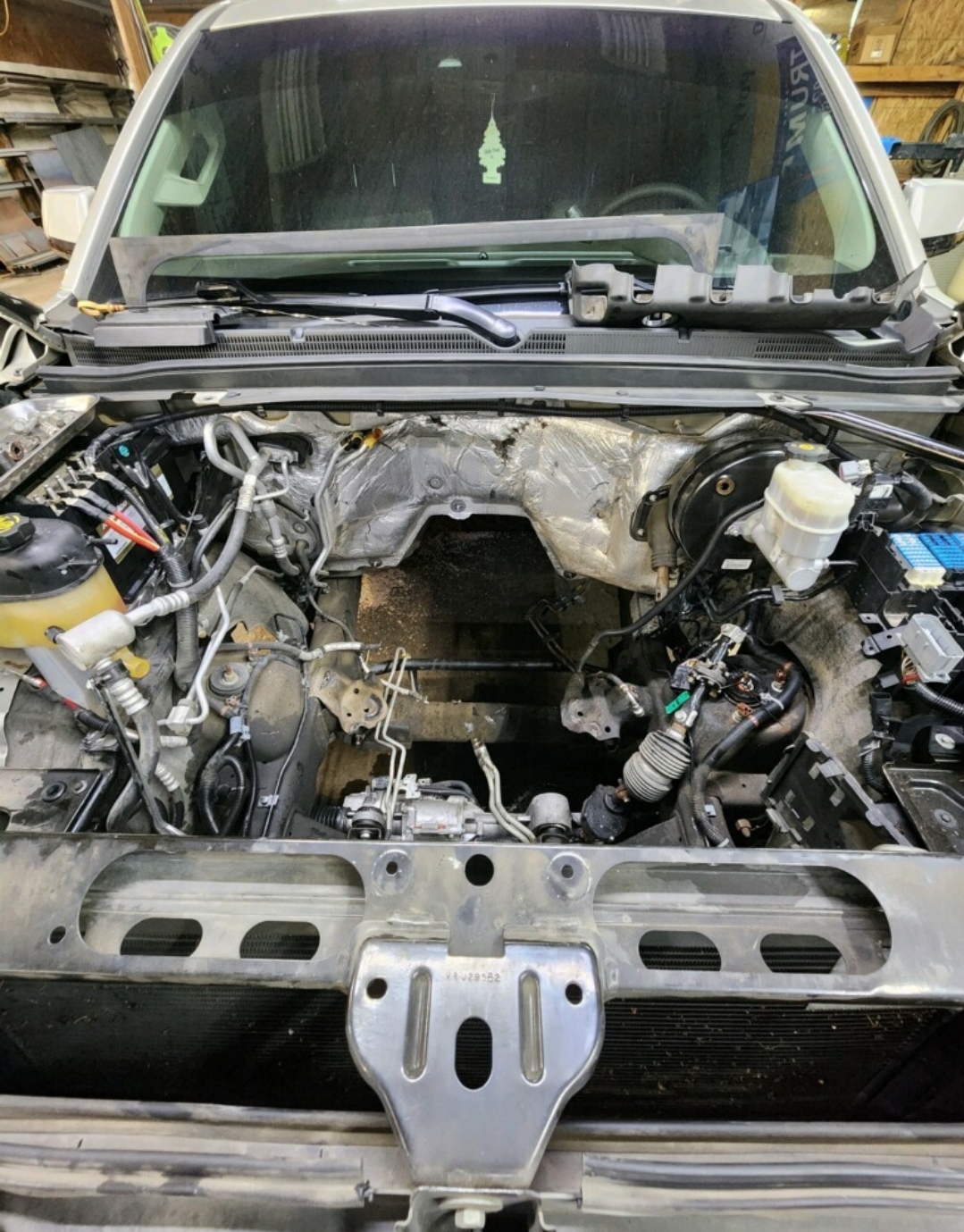

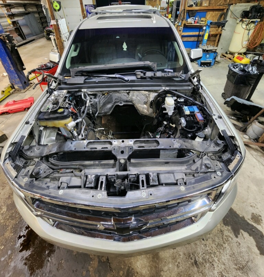

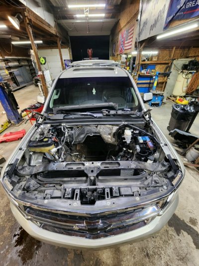

I may be missing the bigger picture here, but my Suburban has the electronic steering gear, as seen in the pictures. No power steering fluid reservoir or fluid to contend with. From what I am seeing (pictures were sent from my technician), could he not just install the new engine and hook my existing electronic steering gear back up like before? Isn't the steering linkage/gear an isolated part from the engine?
I am still gambling on being able to retain my electronic steering gear that is in the Suburban. I am concerned if trying to convert to hydraulic, there may be more issues than are worth dealing with. We are retaining my factory ECM and TCM. Wouldn't my existing steering gear just plug back into those connections as before?
Either way, I guess we'll find out soon enough. My technician seems deeply motivated to get this job done, and he is a very creative problem solver, so I am hopeful that he can come to a viable solution.

My bad... Reading the thread, i gathered it had Hydro Steering. (thats why I said "stay" in my post)
If you already have the E-Steer, than everything is already present, and its a matter of a electrical connection, and the new motor clearances.. If thats the case, you should be golden.

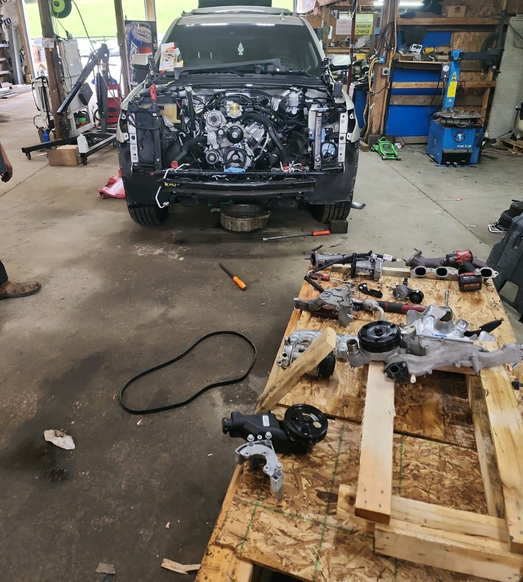

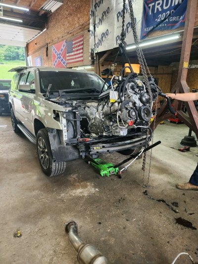

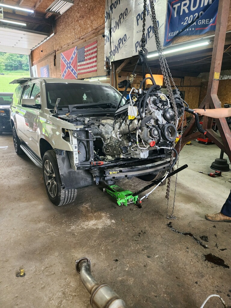

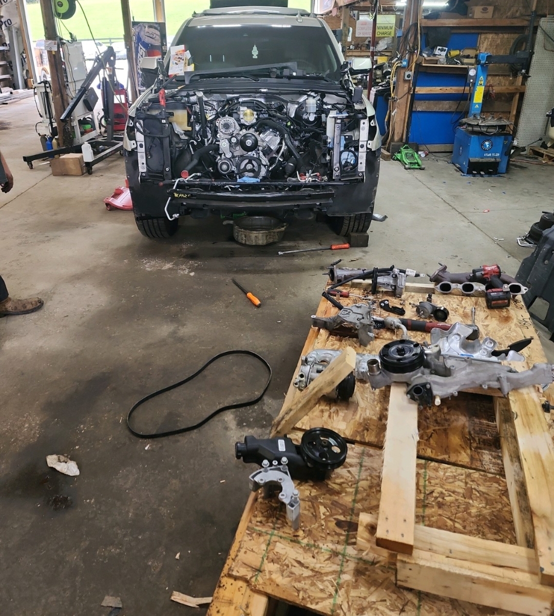

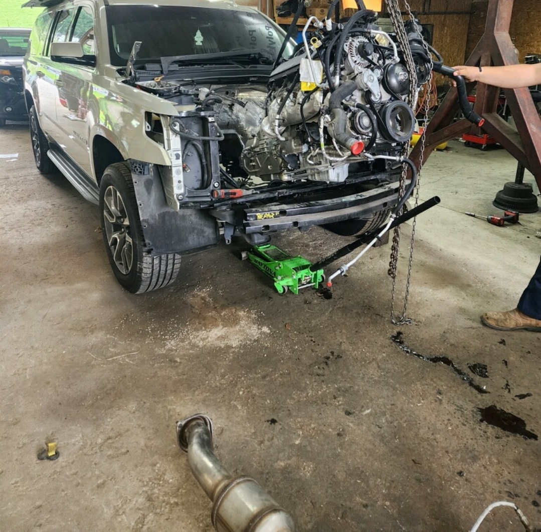

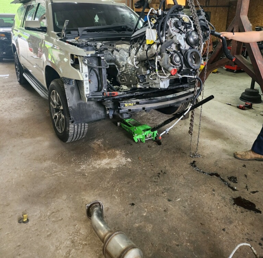

UPDATE!! New engine and transmission is being transplanted!! Man I'm EXCITED!!

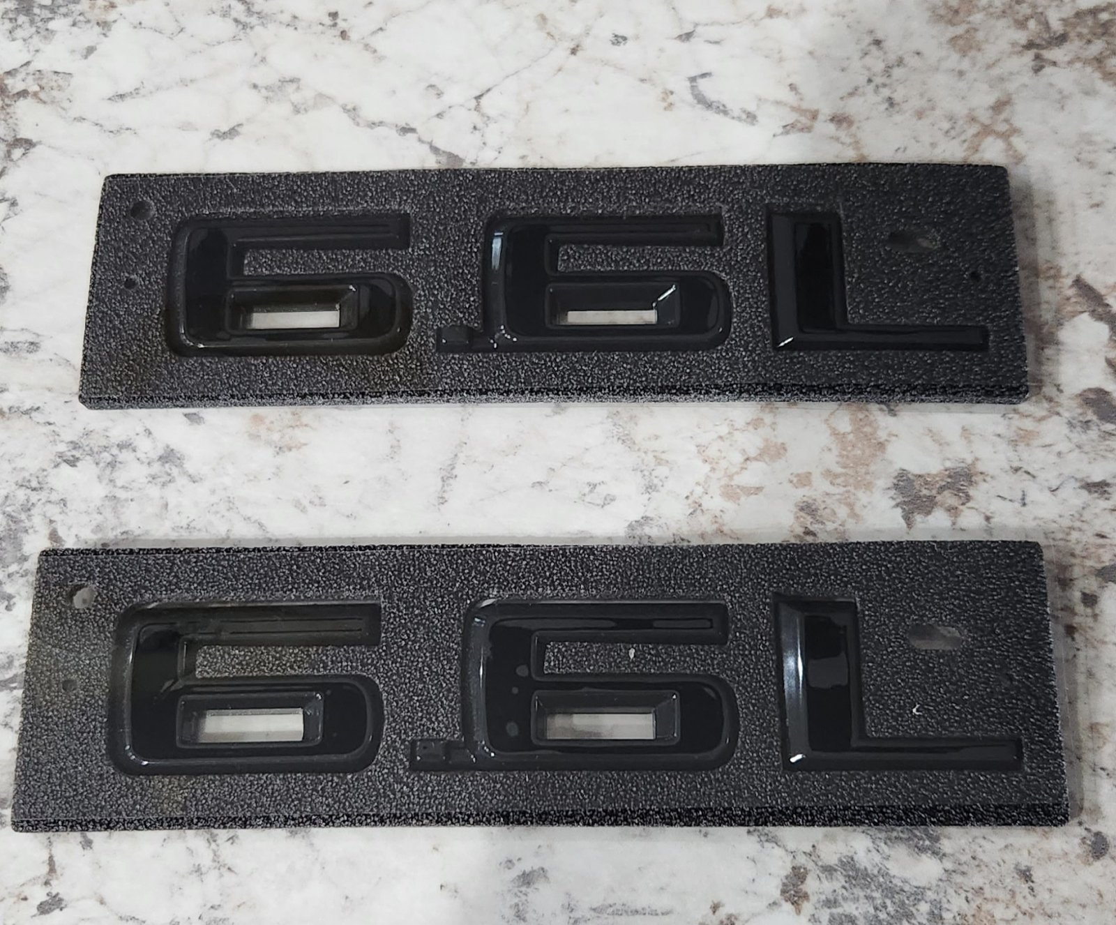

Also I got some subtle badging that I will be putting on. Not sure if I'll use the hood line, similar to the 6.2 Silverado, or maybe the lower right corner of the lift gate....
View attachment 408446View attachment 408447
I can't wait til you get it running.
If it was mine, I'd put the badging on the rear gate. Nice and subtle--plus they'll be able to see what just kicked their ass.

Are you going to try to use the stock cross over pipe, with cats? I would suggest it. Looks like you got both cats and all 4 O2 sensors. Thats like 1000 in parts right there.
L8T BURB
L8T BURB
Jul 3, 2023
149
371
Kentucky
I'm hopeful that I can use the cats and cross-over from the donor engine. The diameter of the piping, diameter of the cats, and the overall angles of it could be too big but we shall see. I don't have pics for a good side by side comparison, but the downpipe and cats from the 6.6 are MASSIVE compared to the 5.3 downpipe and cats.
If I have to end up using my 5.3 downpipe and cats, at least I'll have the donor stuff to sell and offset my costs.
