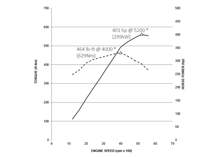

Looking at the TQ curve of that engine... Thats just bonkers. at 1000rpm, your already at 350 tq, and it maxes out at 4100 RPM with 464 TQ.. Man... Thats going to be a fun engine..

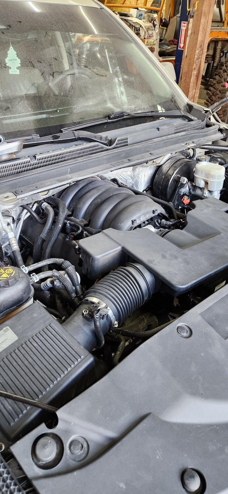

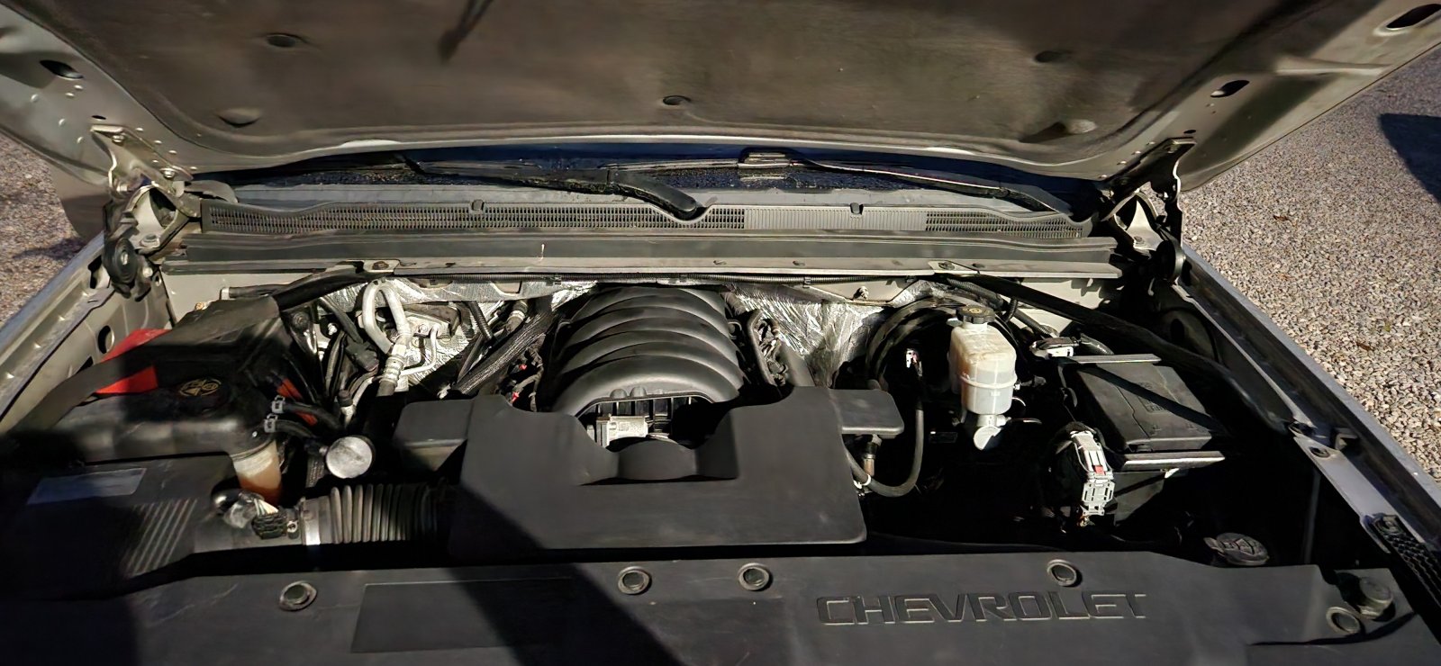

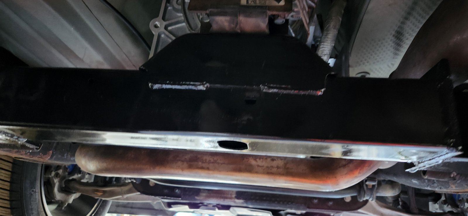

UPDATE!!
Engine and 6L90 trans are in! Front clip is back on! Now we are down to the tuning and driveshaft. Technician stated that there was around 50 error codes when it was first started, and he quickly got it down to under 20 codes. I'm not savvy in tuning whatsoever, but he says that's a great step lol! He mentioned that he's having a little issue getting the 6L90 to communicate with the vehicle. I'm hopeful that we can get that resolved. We have used all harnesses and ECM/TCM from the 2015 Suburban. He is attempting to use the 6.6 intake and throttle body. Time will tell if he can get those systems talking to the 5.3 ECM properly. He had to modify the transmission cross member to accommodate the additional size of the 6L90. Seems the only things remaining are dialing in the tuning, and getting the proper slip yoke, and custom driveshaft built. I'm VERY excited!!
33,162
51,352
UPDATE!!
View attachment 410505View attachment 410506View attachment 410507
Sounds like great news. Can't wait to see a video of this beast showing what she's got.

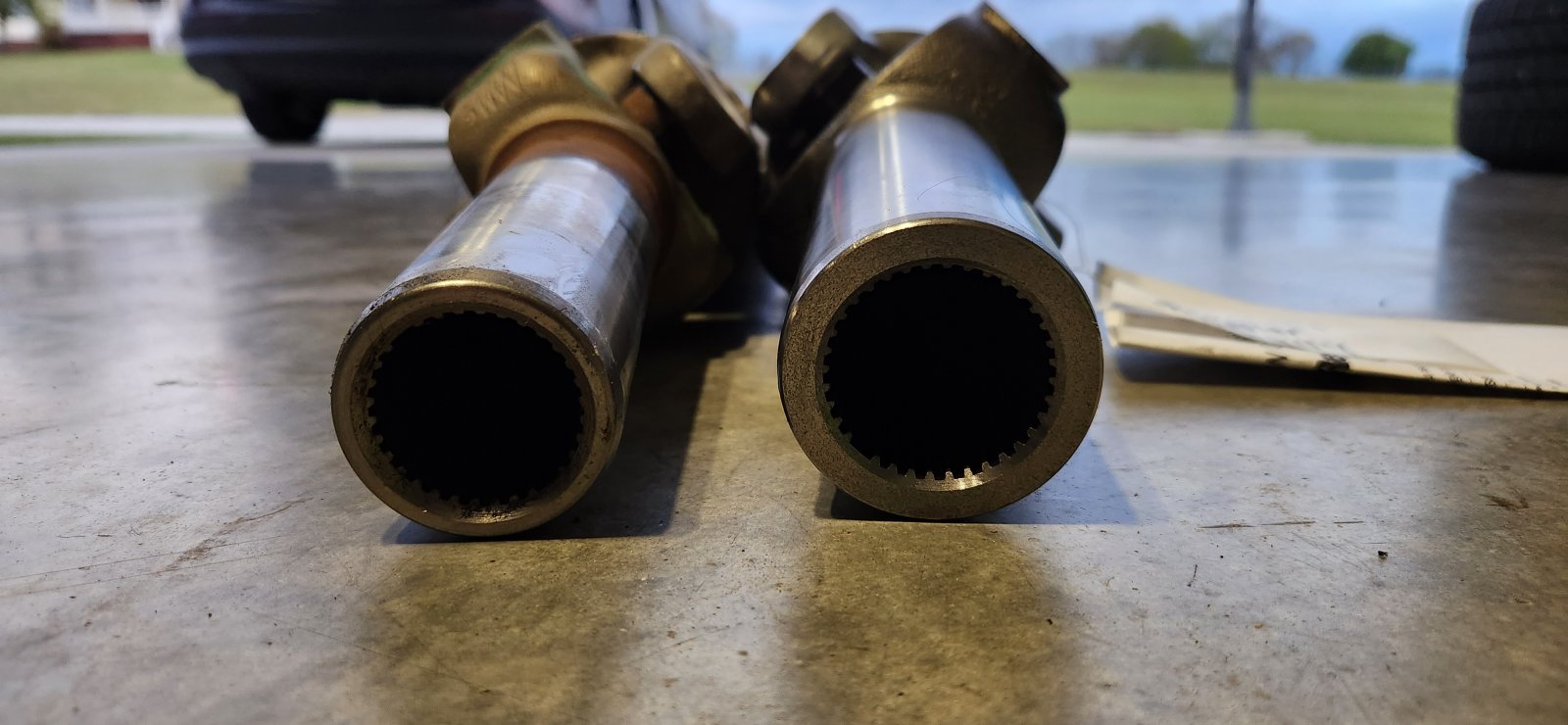

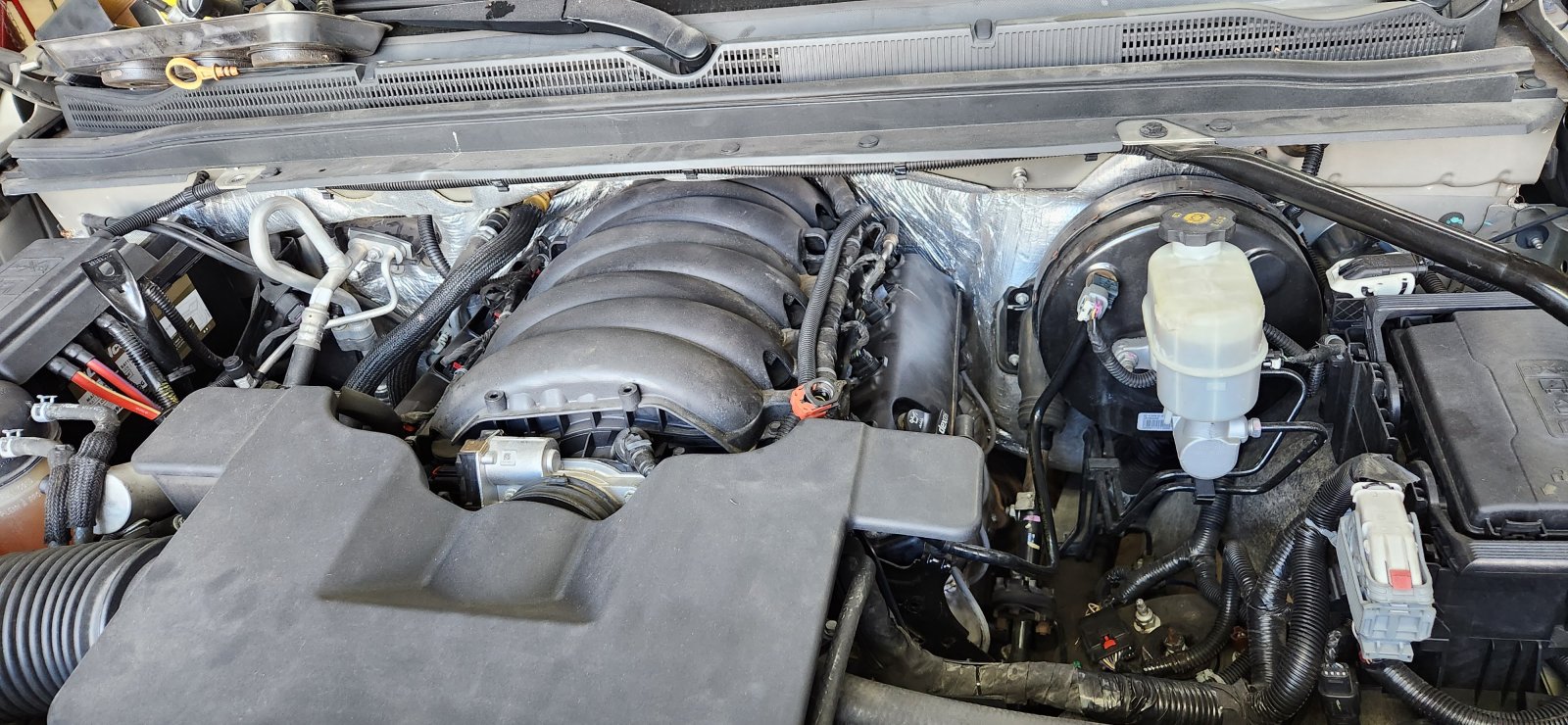

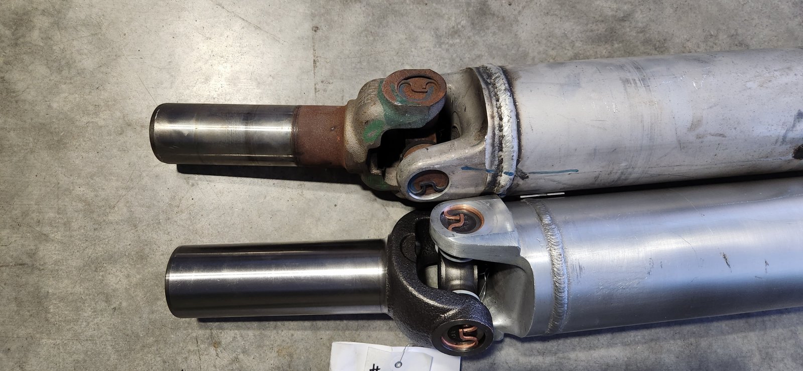

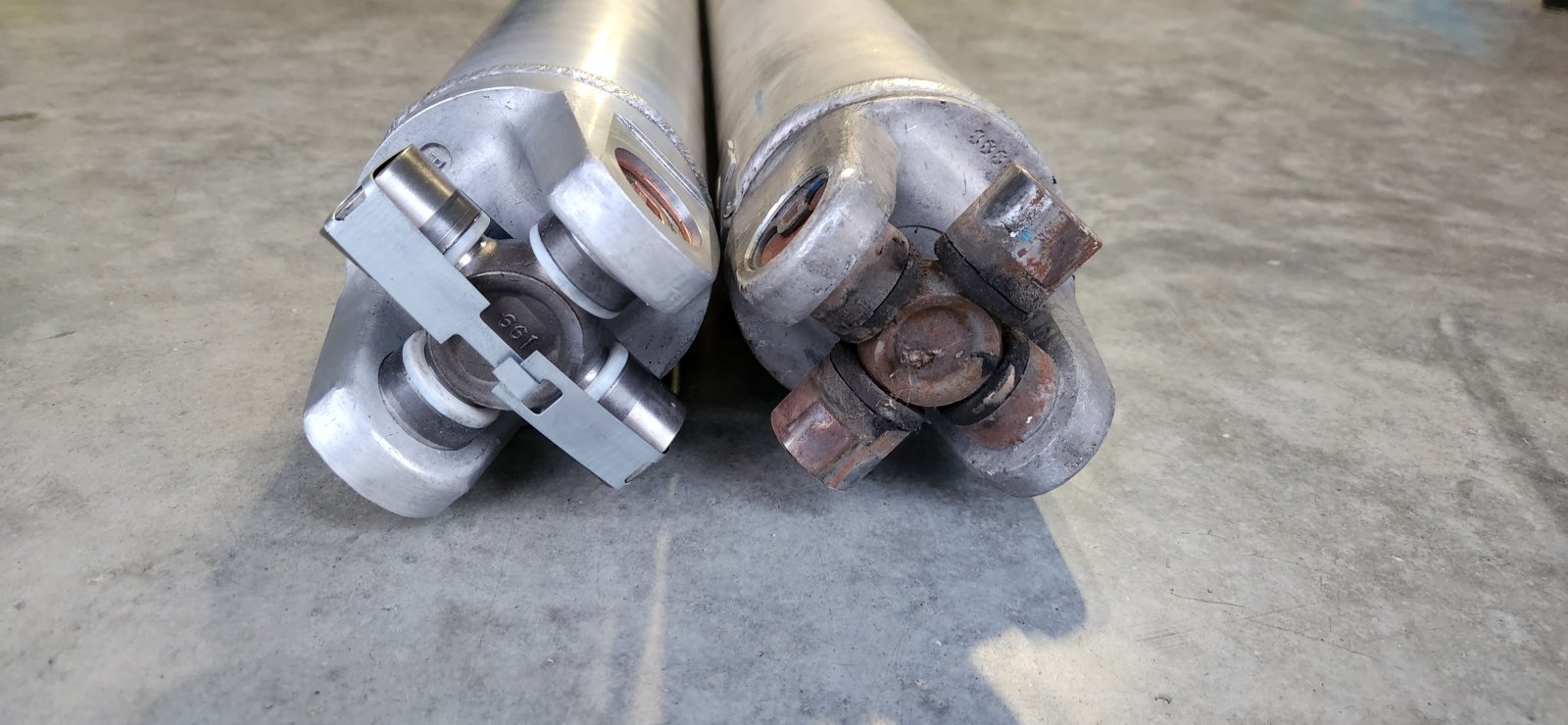

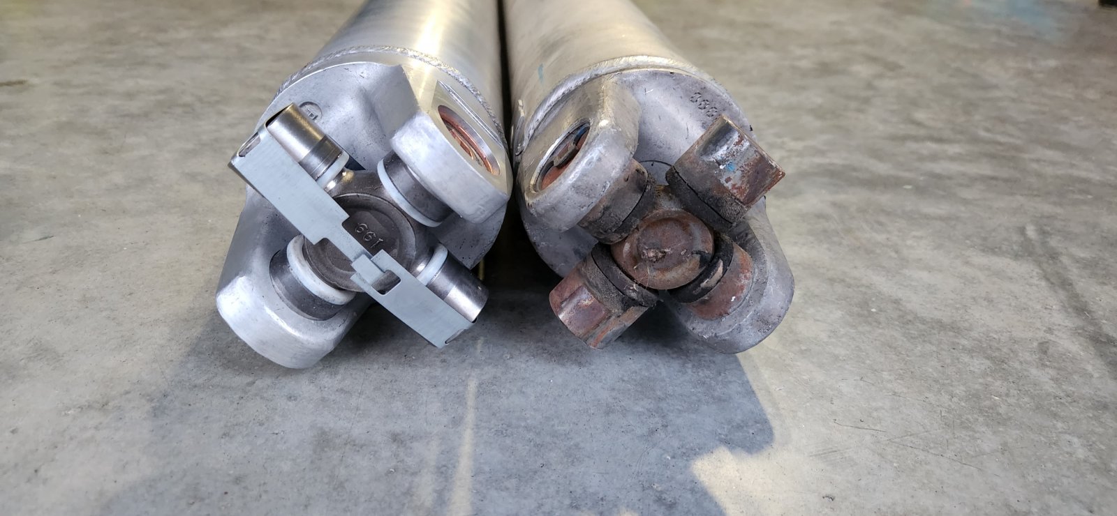

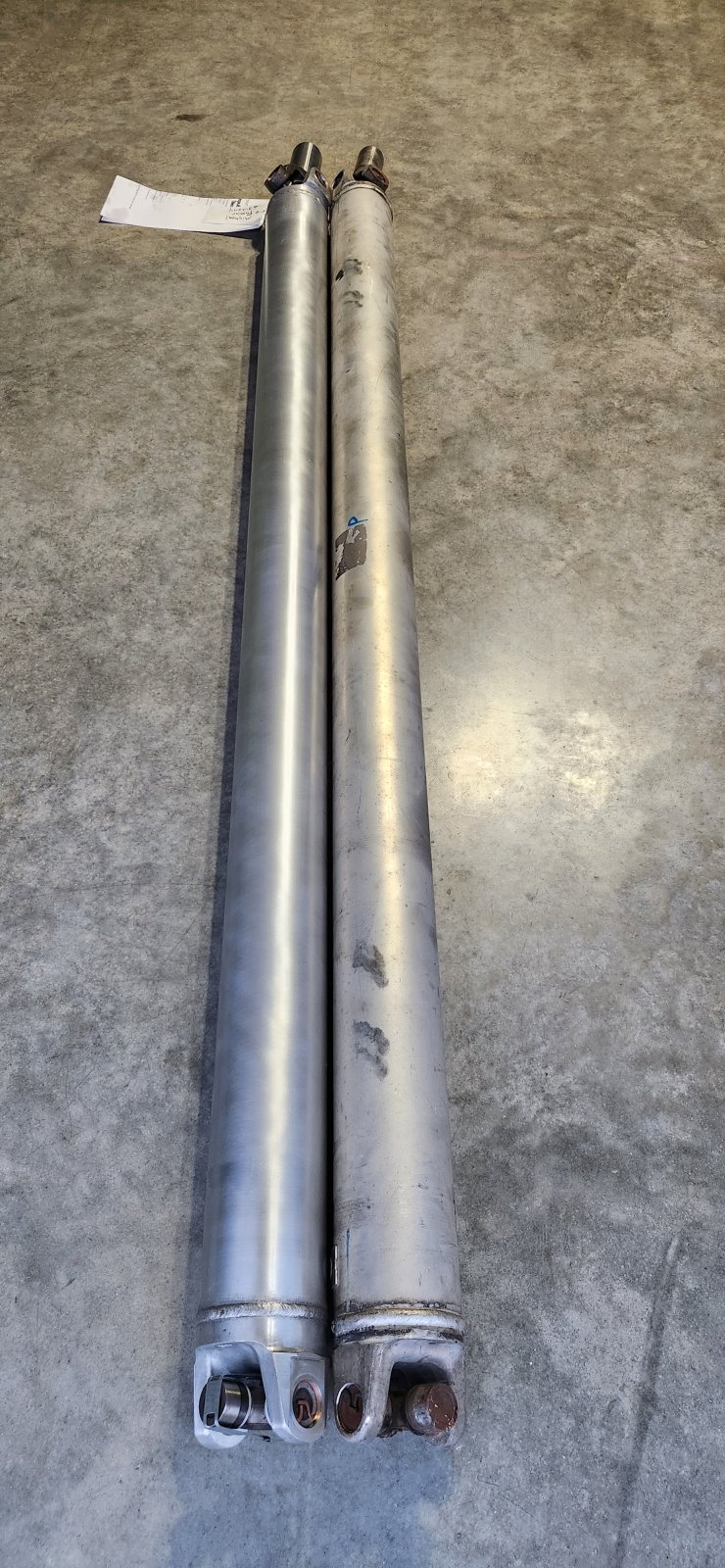

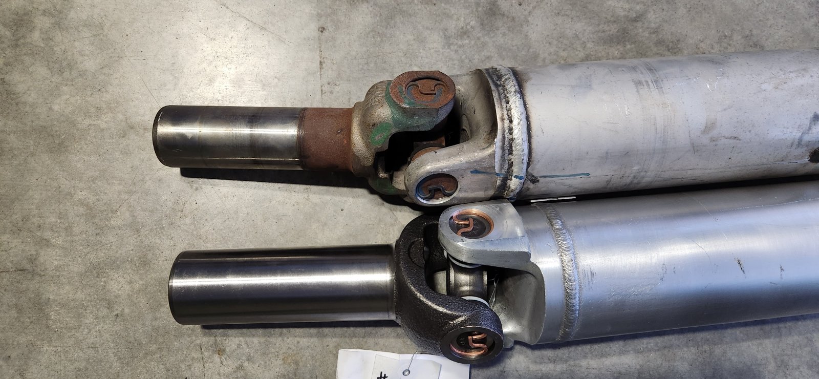

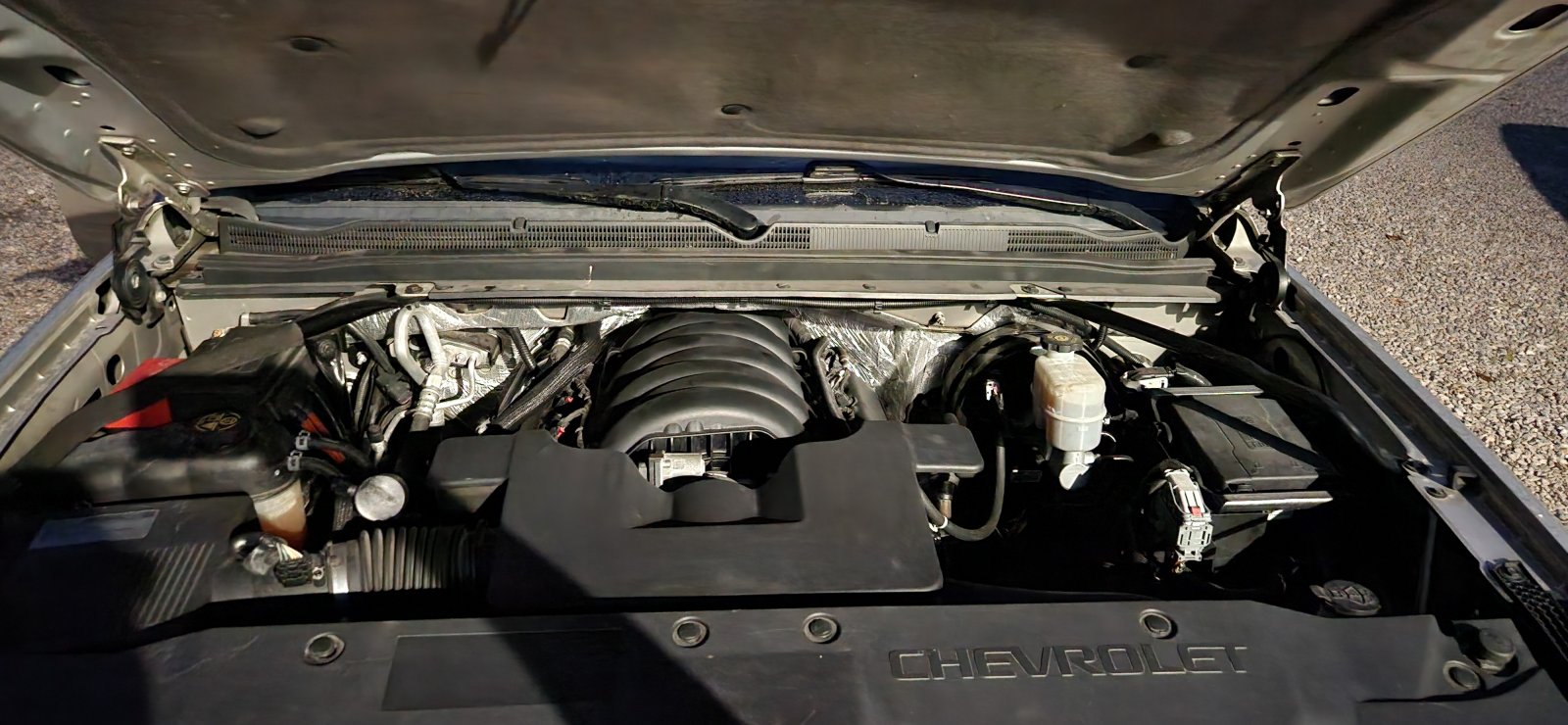

Here again with another update!!
It is now running, and has NO codes! We've been waiting for the driveshaft to be built, and just got it back today. My technician says he'd like to log around 100 miles on it to work out any miscellaneous issues that may pop up in tuning or otherwise.
Keep in mind, this is a 6.6 engine and a 6L90 trans...neither of which were ever meant to be in this vehicle, so hearing it run was pure music to my ears!!
The only issue we have left to deal with is the intake/throttle body. My ECM didn't seem to like the 6.6 throttle body, so we installed the 5.3 intake and throttle body on the 6.6 and it ran good with no codes. The intake on the 6.2 and 6.6 are identical part numbers from GM, but different throttle bodies. So I grabbed a throttle body from the 6.2 to see if we can get it talking with the 6.6 intake and my ECM.
I am attaching a few pics of the driveshaft differences, and one pic (all I could get) of the Suburban. Peep the MASSIVE difference on the slip yoke end of the driveshaft. This new one is beefy! It's made of 1/8" aluminum, and it's so much thicker than the stock, it sounds and FEELS metal. I'd hate to think how thin the factory shaft is. More details to come!!

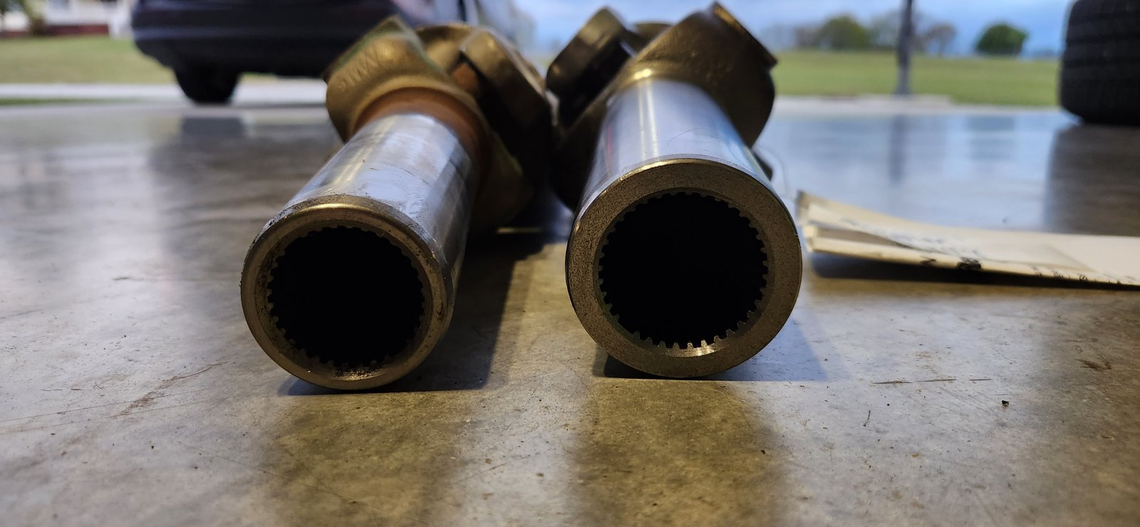

View attachment 412031View attachment 412032View attachment 412033View attachment 412034View attachment 412035

To answer a couple of previous questions...
The power steering works just as it did before! We simply discarded the power steering pump assembly on the 6.6.
Also the 6.6 does not have provisions on the block for the belt driven vacuum pump that operates the braking system, so we tapped into the pcv to get vacuum for the brakes, and it's smooth!
