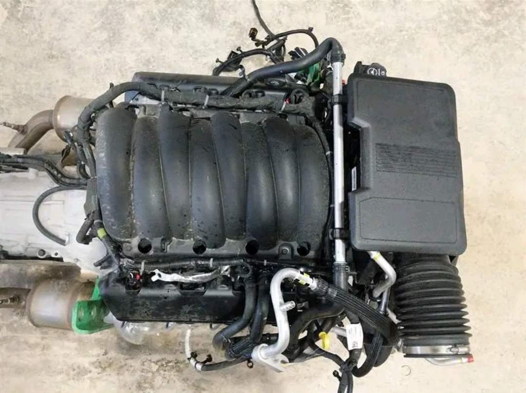

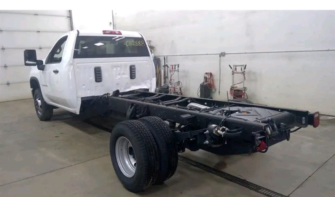

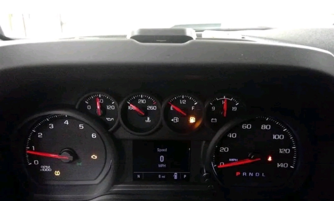

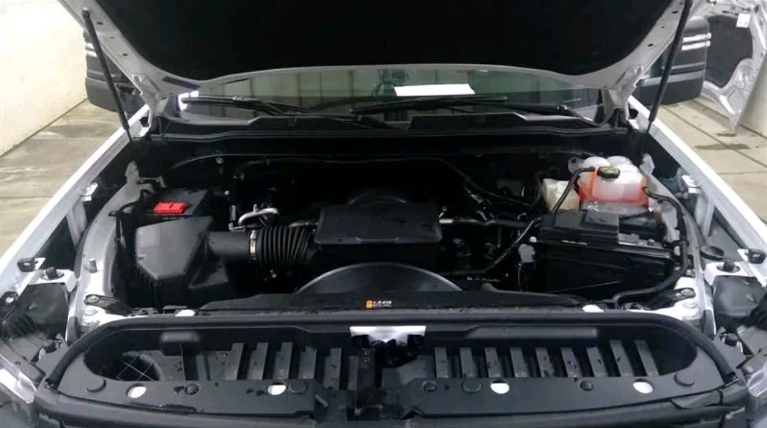

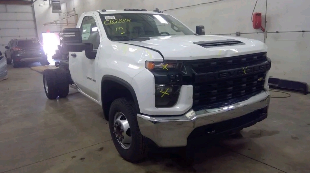

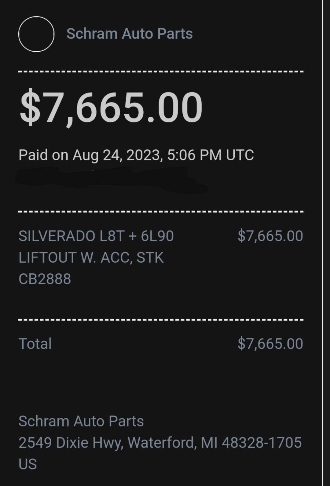

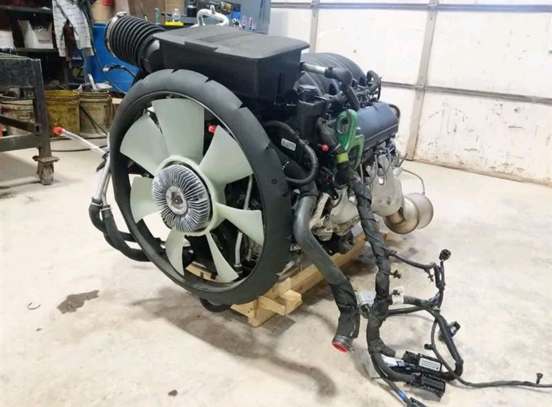

UPDATE!!
Engine/transmission has been purchased! The seller will be palletizing and prepping for shipment by weekend, and I should receive it by the middle of next week! I'm freaking PUMPED!!
Here are some pics of the donor vehicle and engine/transmission...
