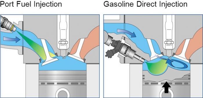

Where does the fuel get "injected" in these "direct injection" engines?
2001 Yukon SLT
2012 Yukon Denali XL
2011 Yukon Denali RIP 5/20/18
Hi-psi
Mar 10, 2018
305
455
Atlanta, GA
As the name implies, directly into the cylinder. So as @bobsr described above, since you don't get the "washing" effect of the atomized fuel going over the intake valve, DI engines have a higher occurrence of carbon buildup.
