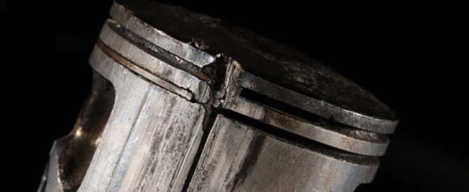

I purchased my first 6.2L in 2012 (Sierra Denali) after having recurring problems with 2008 Sierra 5.3L. I have on occasion been forced to use 87 or 89 because that pump was out of service at the time (broke or no fuel). In those instances I could feel the difference in performance because leaving my house in one direction I have a 5 mile up-hill grade and I noticed the hesitation with 87. While you may not hear anything these engines are affected LSPI (low-speed pre-ignition). See pic below on the results of LSPI.

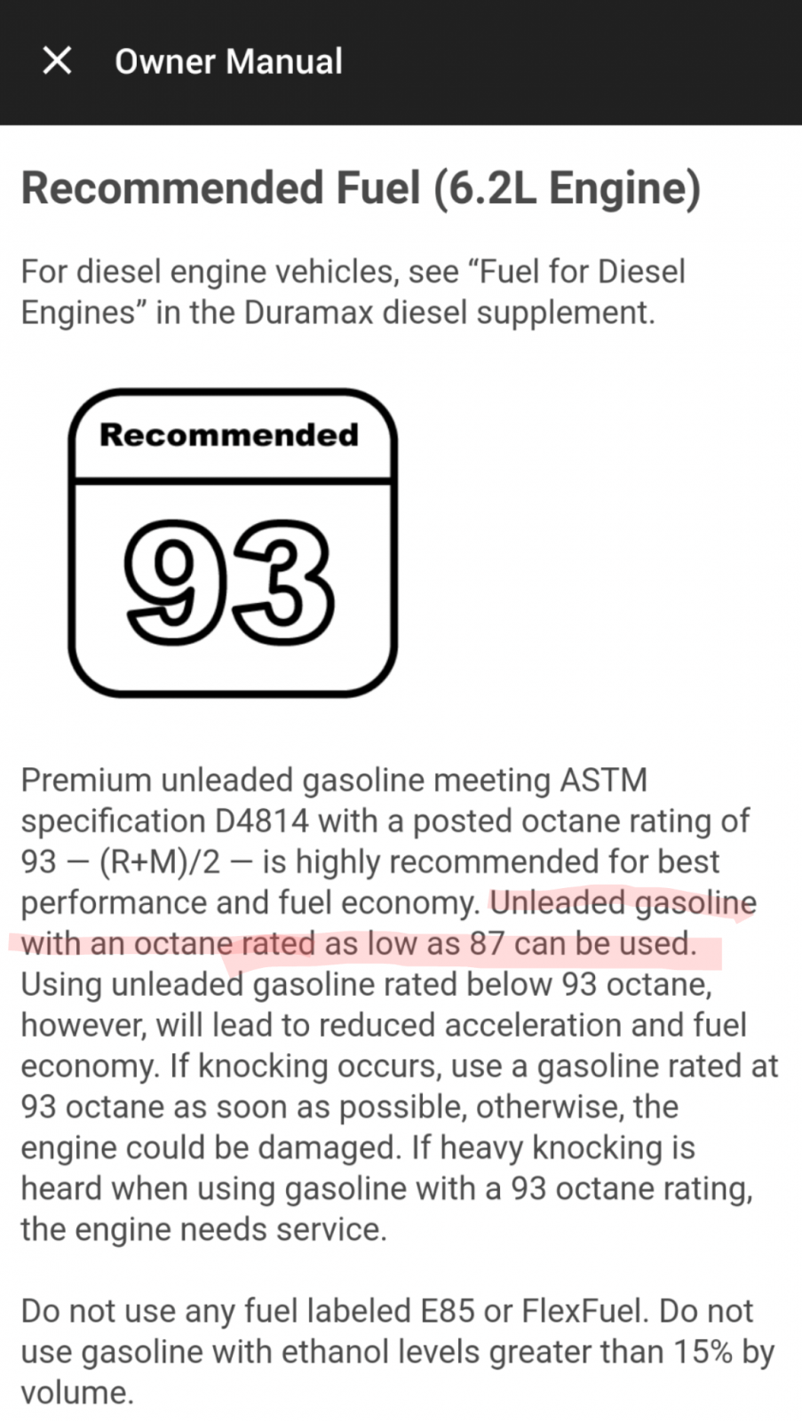

We had a 6.2 in our '11 Escalade and then a 5.3 in our '15. For our '21 Yukon XL Denali we went with the 6.2. The Suburban was a little bit of a turd.
Also we ran premium for the first 3000 miles or so in the '21 and then went with regular for 3000 miles. The MPG gain was around 14% but premium cost 35% more here. We run just cheap regular now as we always have before.
And from the manual you can run as low as 87.

Yes, as the highlighted sentence says, it can be used. Then continue reading after the highlighted part
