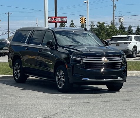

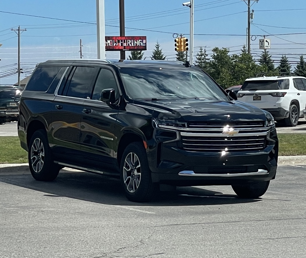

Sorry guys, didn’t see the replies until now. Bought a brand new ‘22 Burb LT today, woot woot!!
