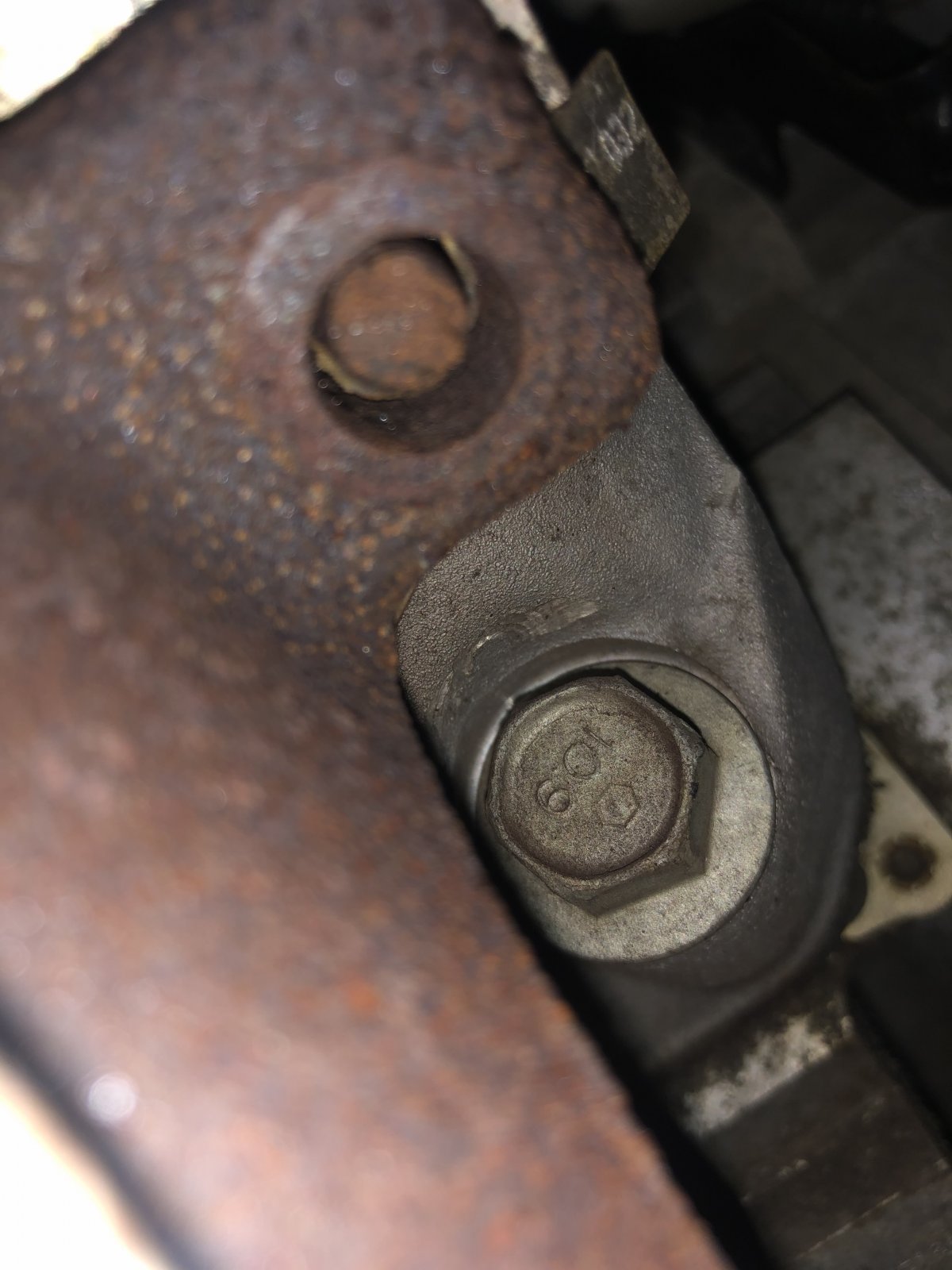

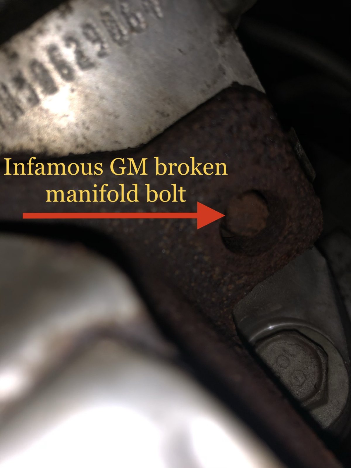

Do you park indoors? Even in Buffalo I’m not sure that you need to change your oil weight. Just keep the fluids changed and topped off properly. You have close to the same mileage I have on my Denali. Your concern should be with the transmission and torque converter more so than the engine.
That’s not to say ignore the engine, but if it’s well maintained they can last several hundred thousand miles.
These do have a lifter failure and some of them have issues with the “pill needing to be flipped” on the trans cooler lines, but realistically the only other thing you might want to keep an eye out for are the motor mounts and your coolant ‘Tee’s’ at the firewall. Since yours is a ‘14, most of the other issues from ‘07-12 were already addressed before yours was even assembled.
Did you take a chance to look at your manifold bolts yet? Here is a photo of what you’re looking for.
