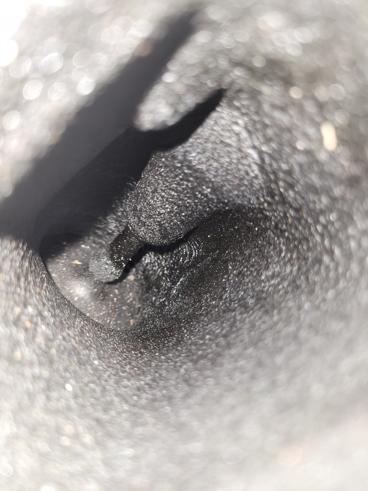

Take off the intake and look at the valves, I read some place the the carbon build up could cause valves to stick open and may cause lifters to collapse.
I walnut shelled blasted the in take valves on my new to me 255,000 mile Yukon and it ran much better, had a lot of carbon build up.

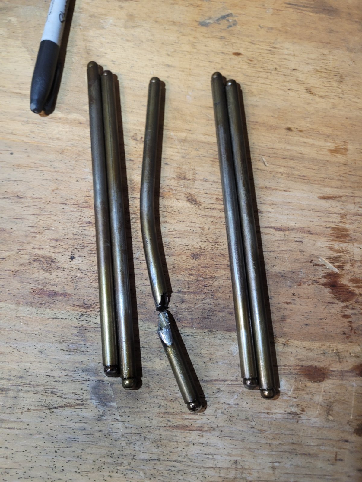

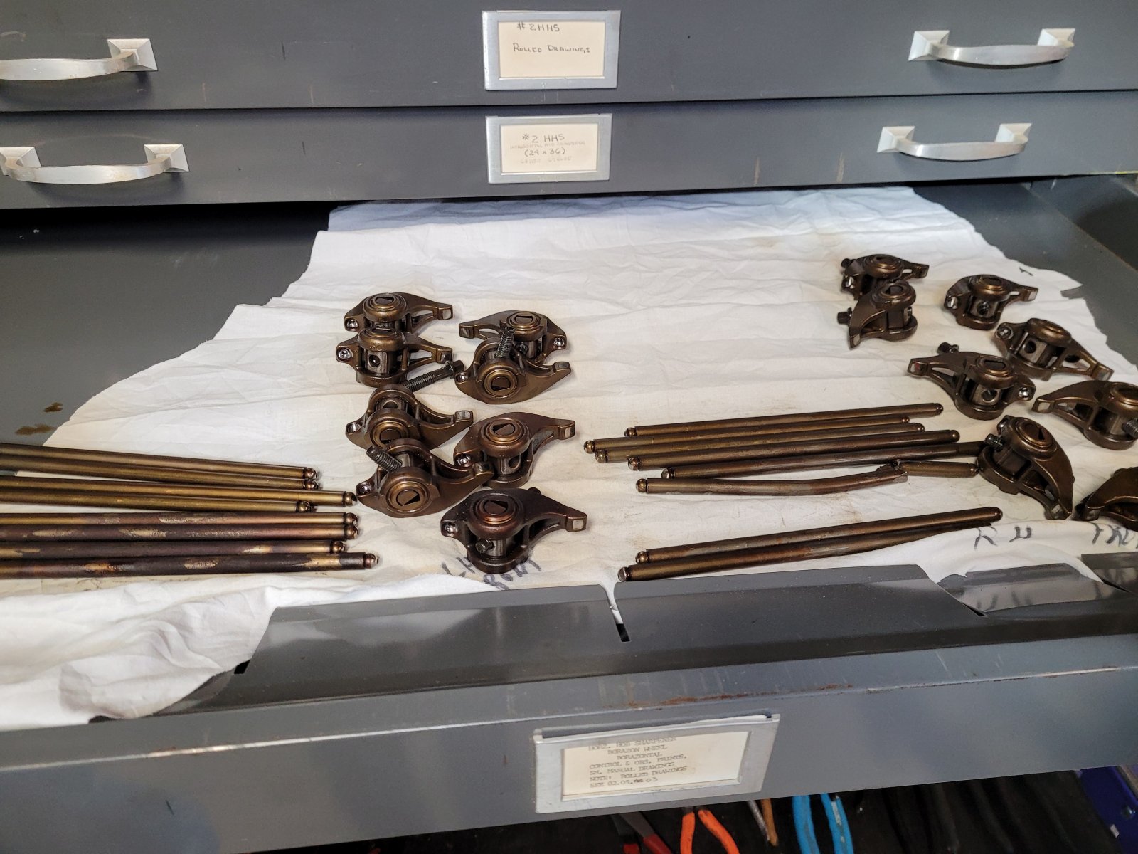

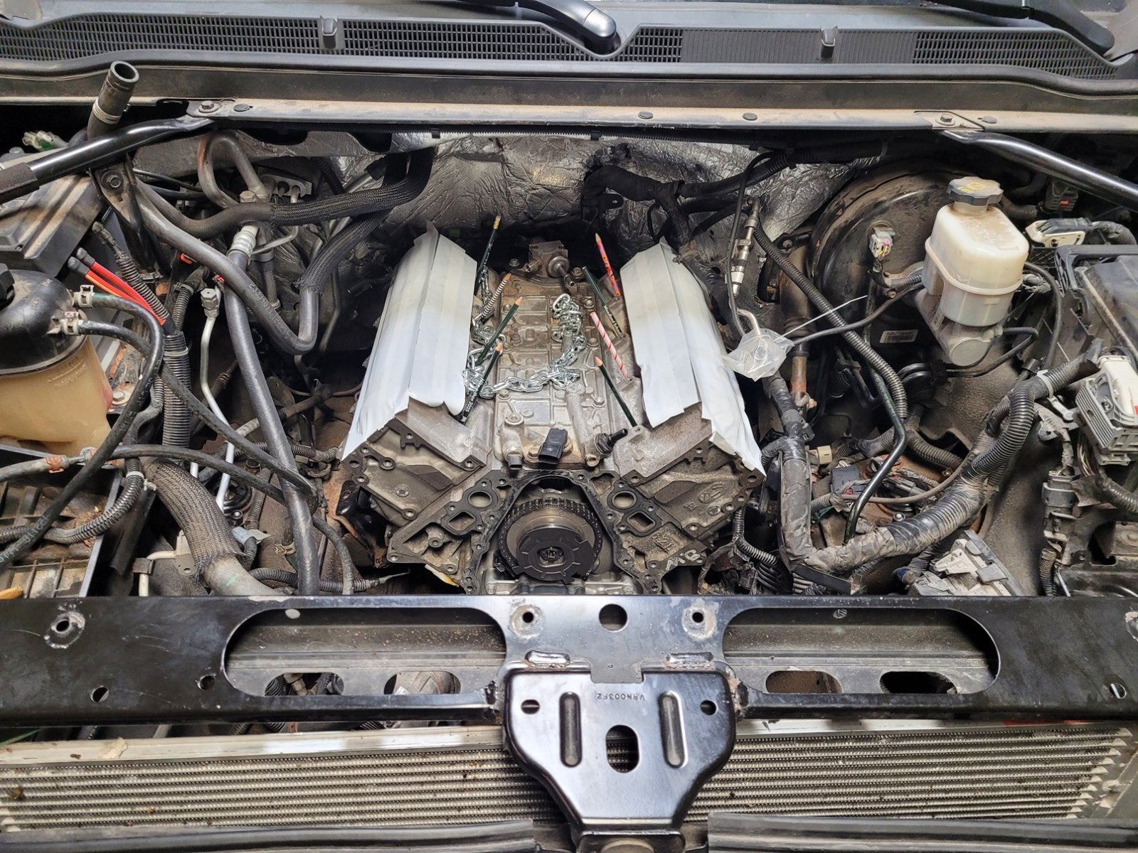

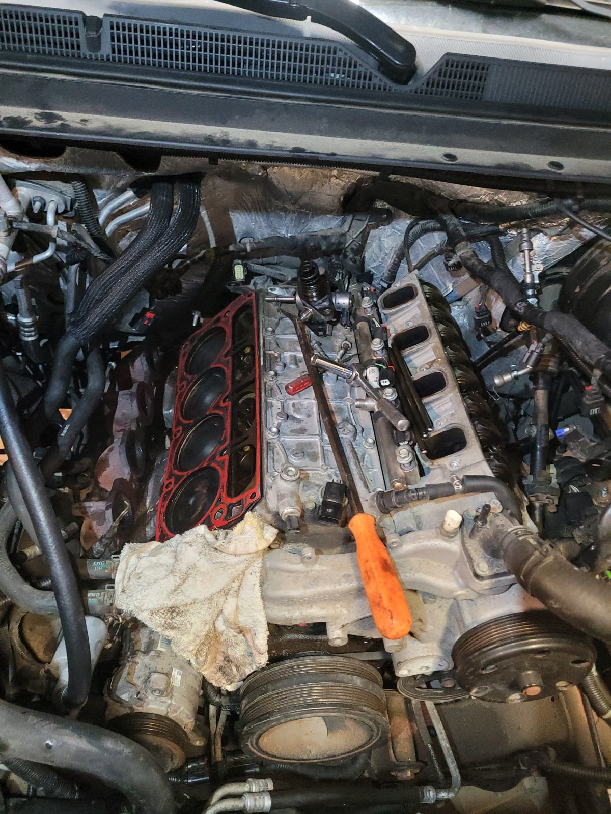

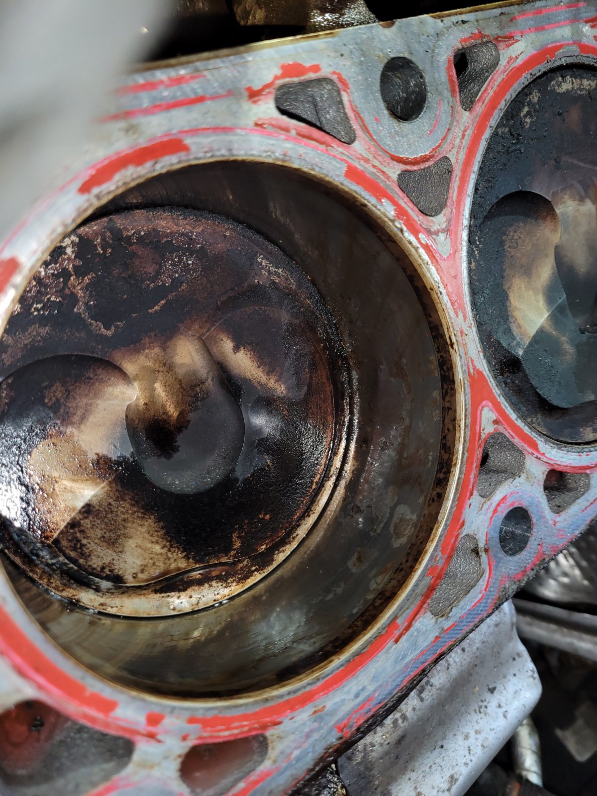

Well my work schedule has me on the road with no real end in sight, so between last Saturday night and early sunday morning I did finally get the head off.
One bent/broken push rod, likely caused by a bad lifter. I had good supervision sunday morning as well.
I wont be home until next friday, so in the mean time I need to get parts ordered. I am doing a full AFM delete, I will keep it stock as this is the wife's truck that mostly just does the school run with occasional towing in the summer.
Will I be able to do this swap with the block in the truck? Camshaft and all?
What is a recommended AFM delete kit? I am looking for something all inclusive, or close to it. As far as tuning, what are my best options? Tuners are something completely new to me.

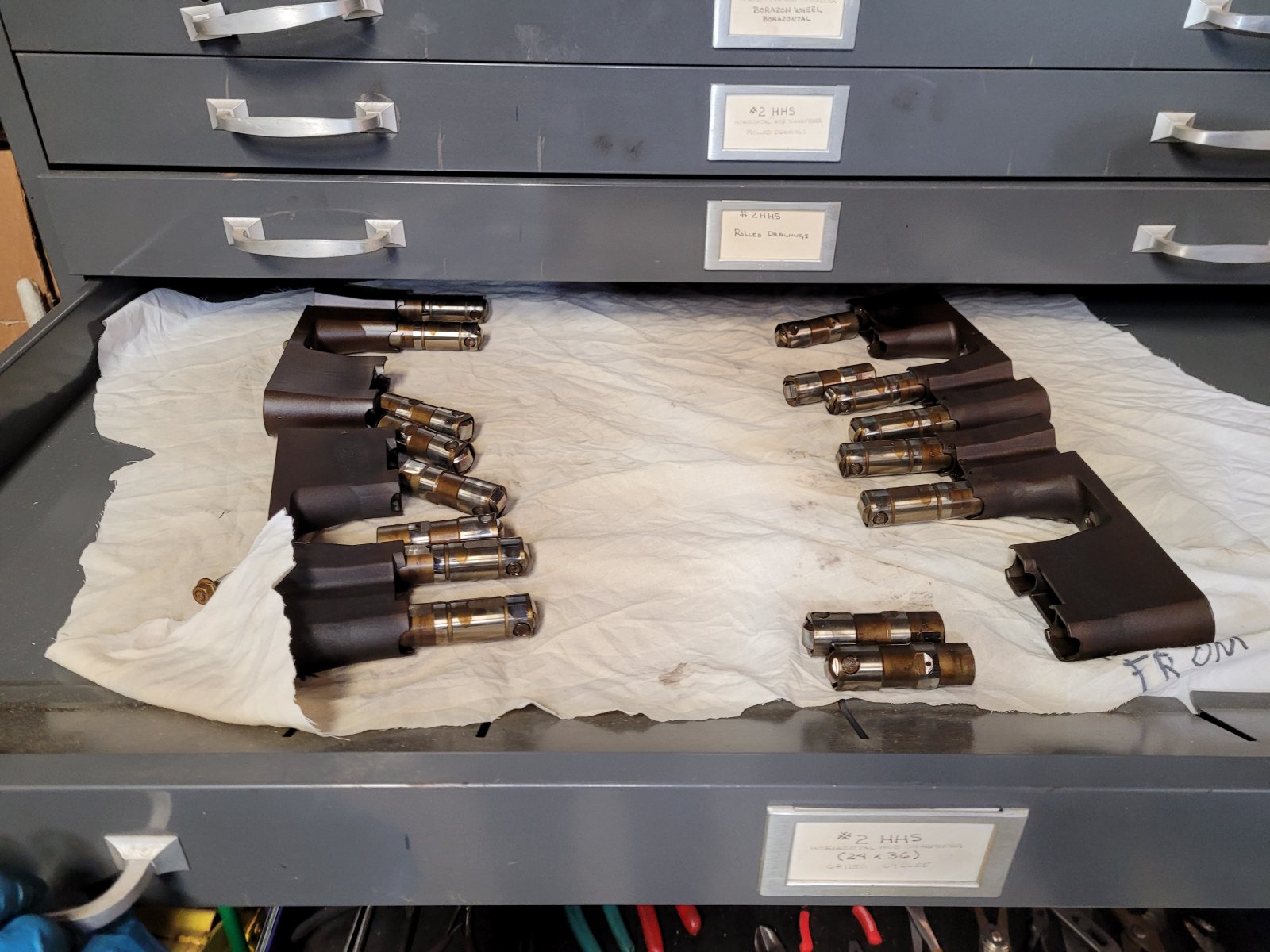

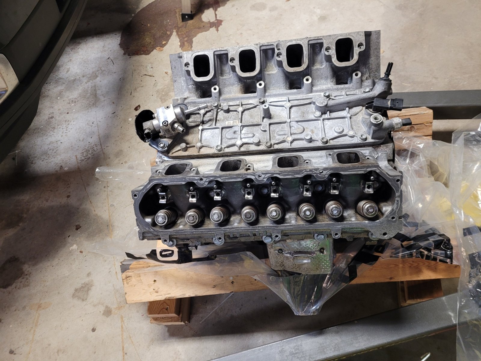

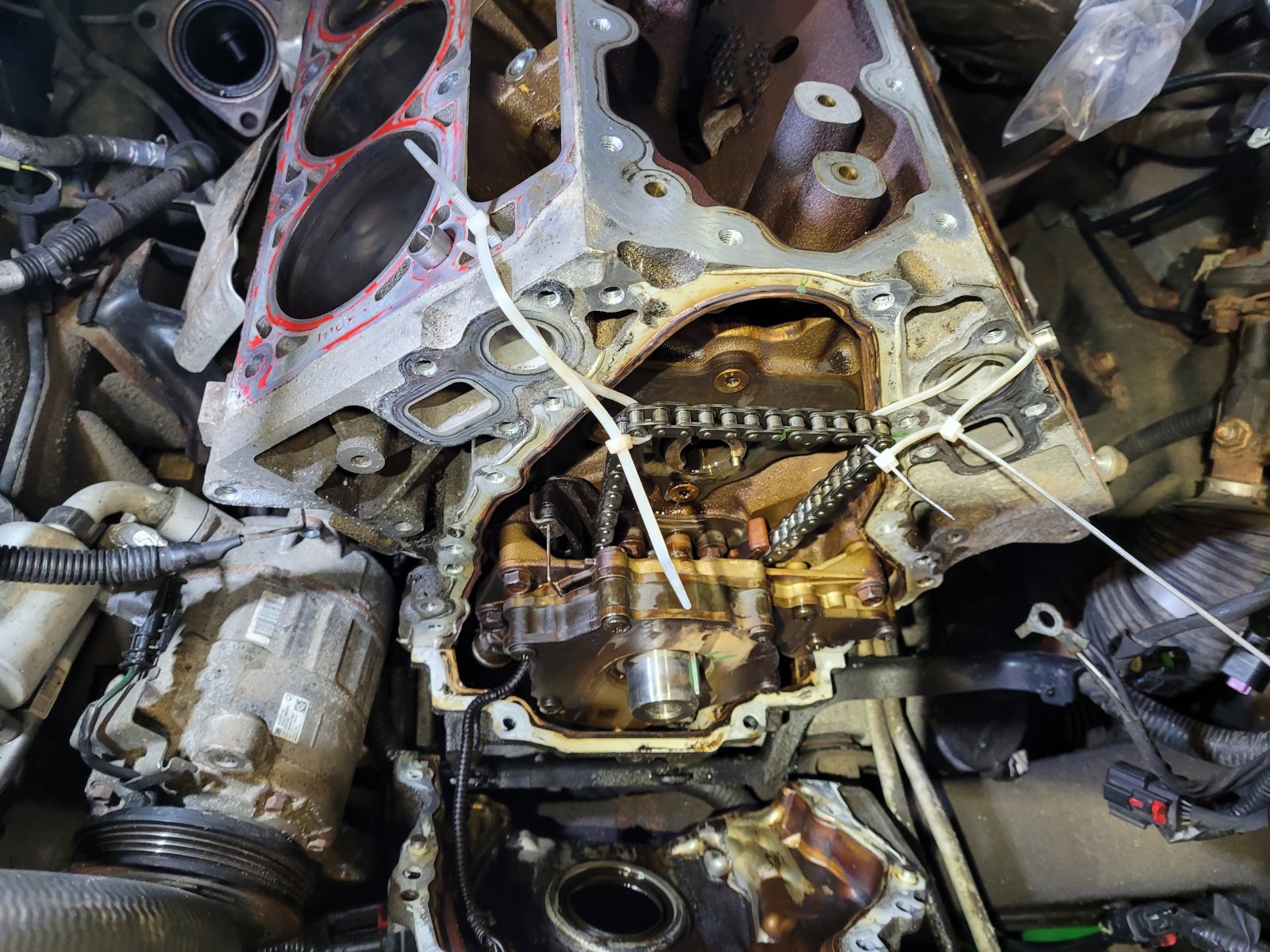

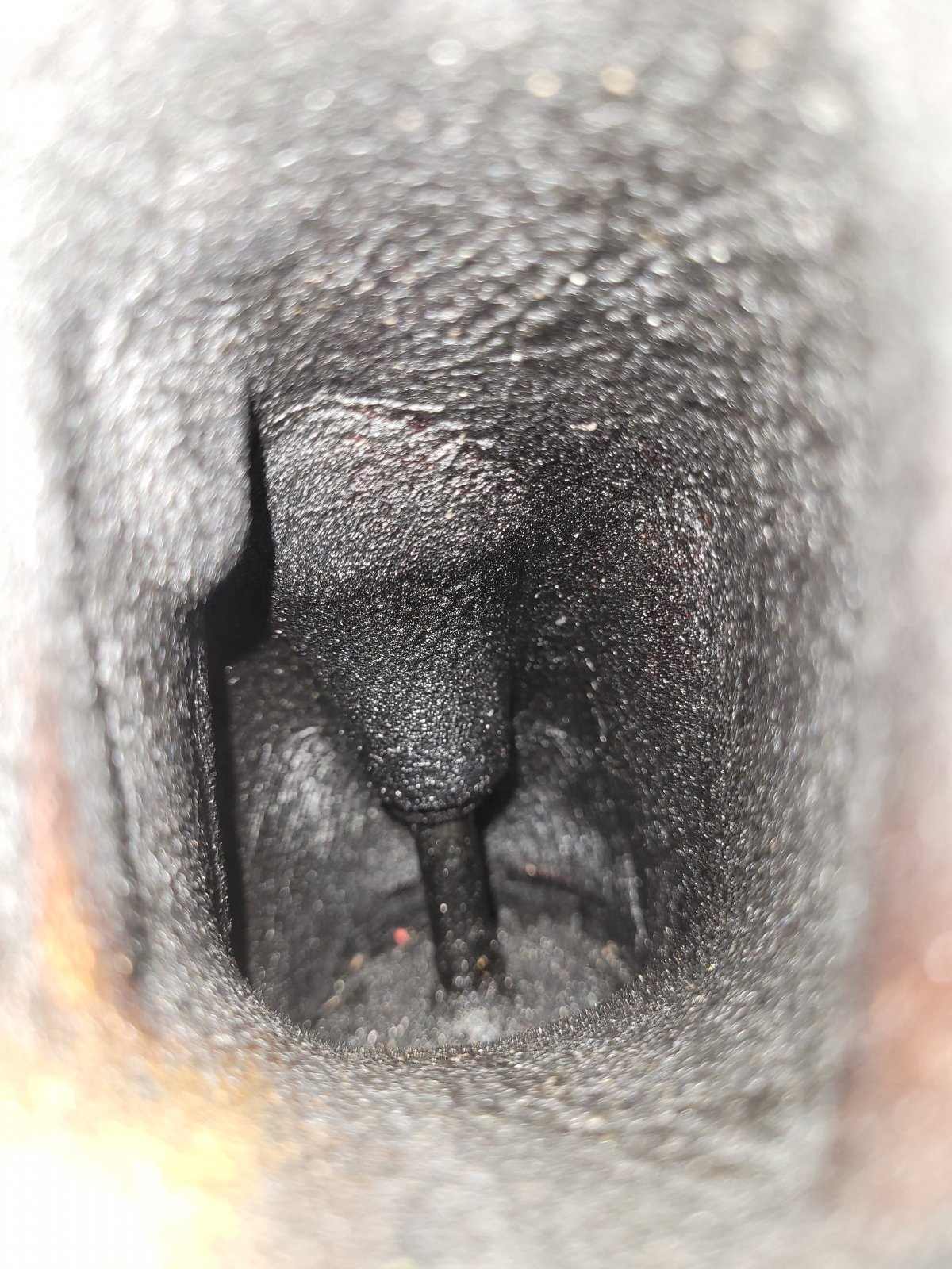

So a little update to where I am with this.

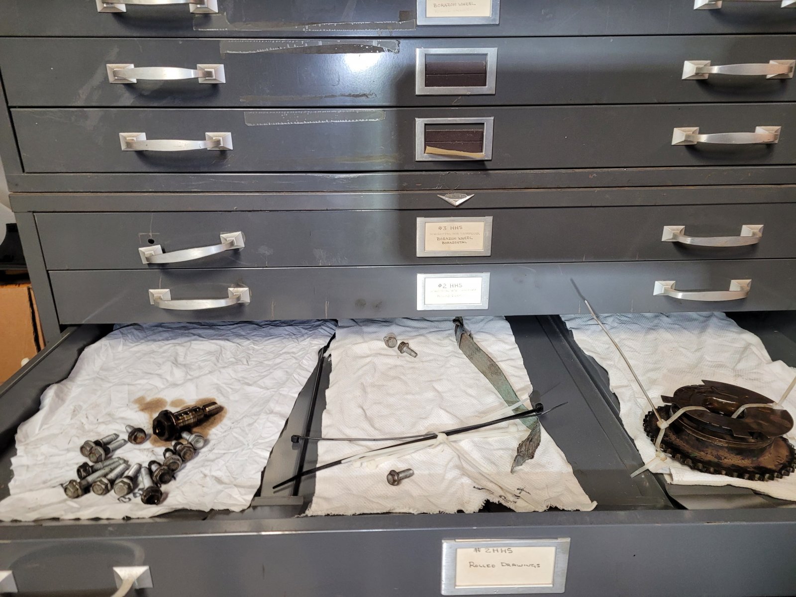

A few weeks ago I took the heads in to the machine shop to have them cleaned and freshened up. Then was back on the road for a couple weeks for work. When I finally got home last weekend (Oct 24th) I went out to the shop and pulled the cover off the motor and found with the weather change some condensation had gotten on the cylinder walls and caused some rust. Well Crap. Spent last weekend pulling the block and dropped off last monday.
Stopped by today and they are taking the bores .020" over due to wear, my compression numbers were not stellar on the RH side, so I am not surprised. With all my traveling for work I am just having the machine shop build the long block and hopefully over Thanksgiving I can get this thing back together. Snow is coming and my wife wants her truck back.
Unfortunately this means there are a lot of parts I bought with my TSP kit that will not be used. So there was some money wasted, but at least it will be put together in a timely manner and done right.

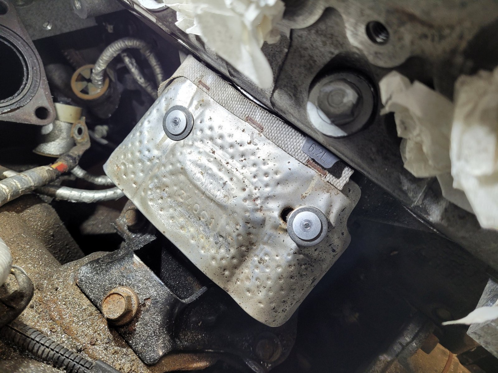

Well despite life's best efforts to slow me down this weekend I got the engine in and ready to go. Including a quick fix on the RH motor mount heat shield that would have been MUCH easier to do before I installed into the chassis.
