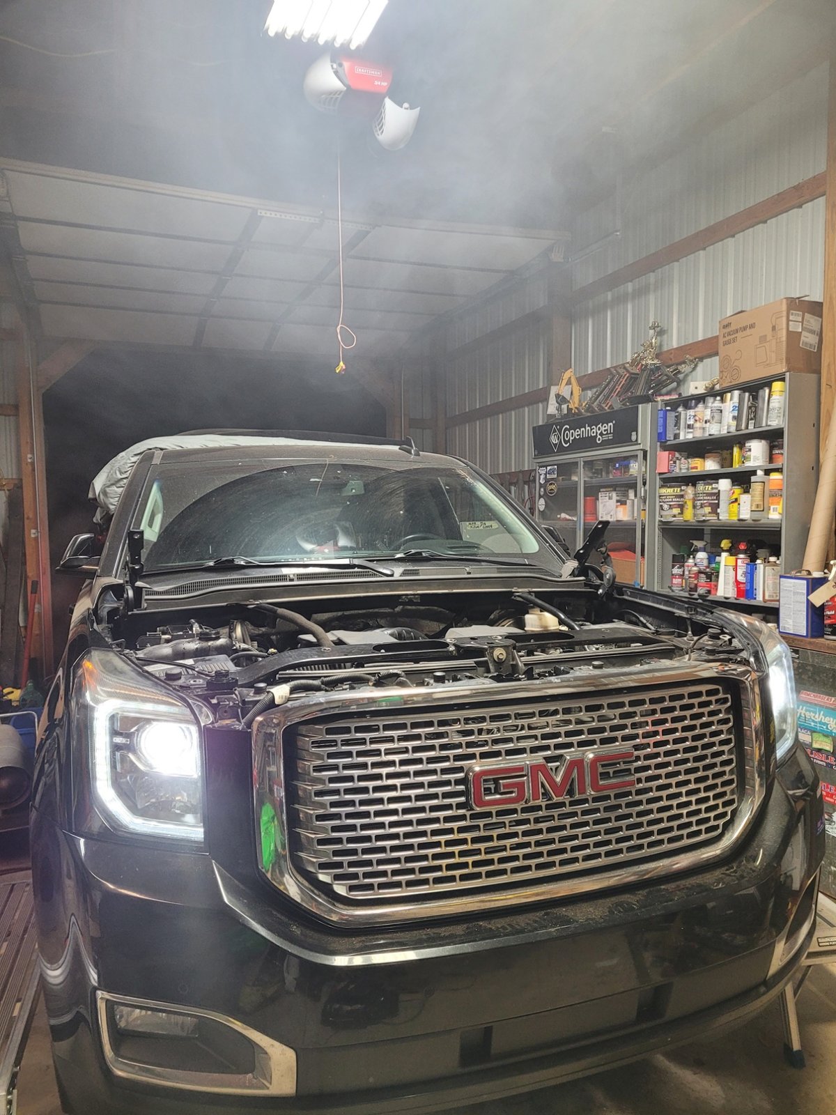

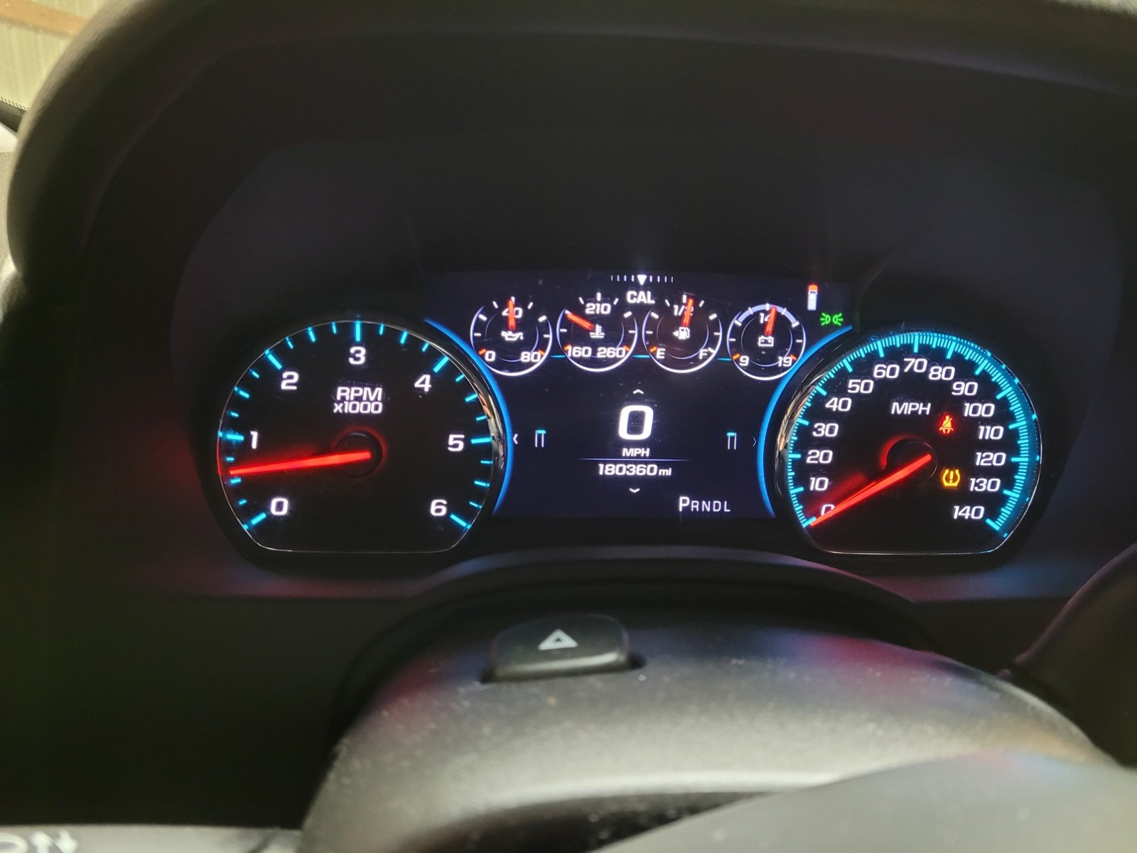

Update to where this stands.
The vehicle essentially acted like it was DOA as far as power, the only "sign of life" was a glowing, barely on CEL.
All my grounds and +12v wires showed good voltage in the engine bay. I had good voltage at the fuse block on the driver inner fender. On a whim I pulled the block to check for corrosion, found none, hit it with di-electric grease anyway, and when I reconnected it, it seemed to "reset" the truck and it all came back to life.
With that I was able to plug in the AFM disable dongle and start the new/rebuilt with AFM delete engine.
It ran smooth, smoke cleared up, and sounded good, and shockingly no CEL.
