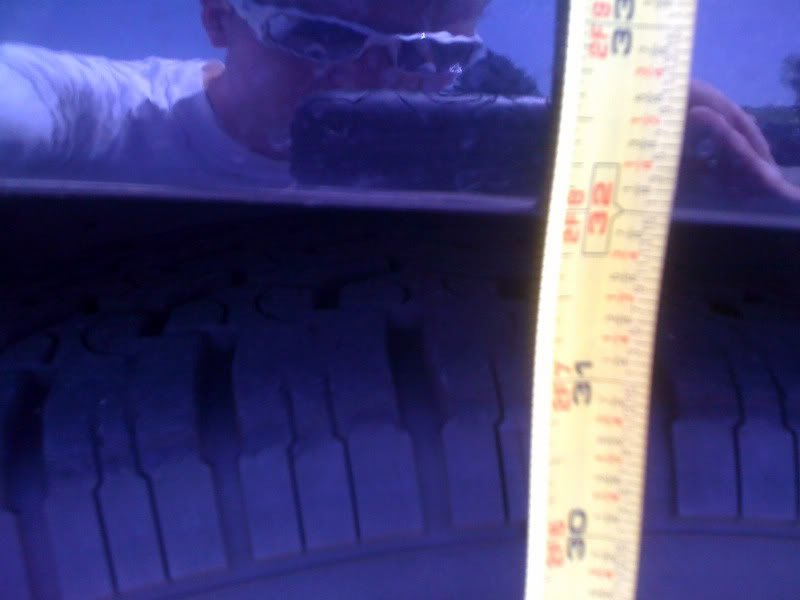

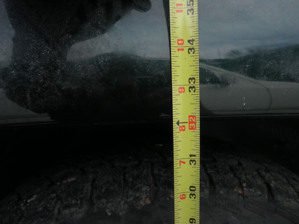

rigo do you hae shock extenders on it now?
at 32 inches at ride height right now with the shock extenders in right?
DO me a favor measure the following
1) Spring height from top to bottom at ride height
2) ONLY if shock extenders are in measure shock from center eye/eye at ride height
Do that then I can go from there to set you up better on what your looking for. also you can ditch the rubber bushings for now.

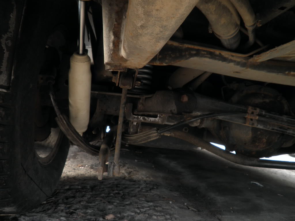

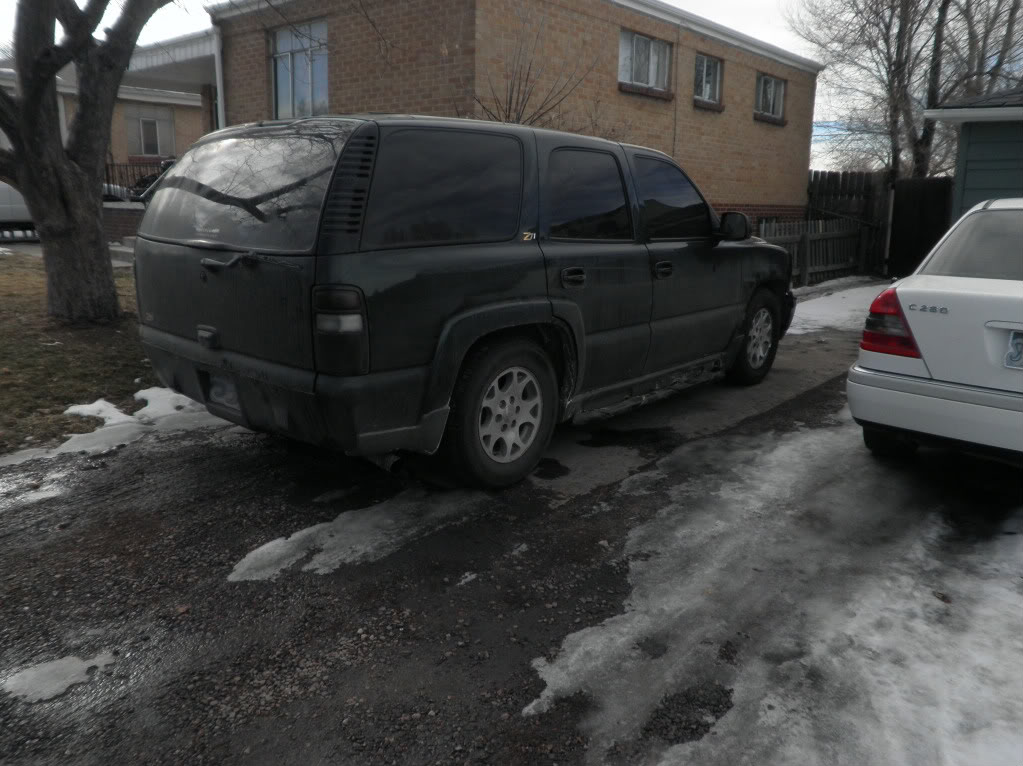

spring from top to bottom is 8 inches.
this is how the truck sits. dirty i know, i know...

shock exenters will help ride cause the shock will have a chance to move up and down not have side load on it.

honestly on his truck once he does shock extenders his ride should improve because the shocks wont get that horrible side load force that hes getting and will have a chance to actaully work.
i cant shock is 1/2 short with the djm extenders i can put weight on the back to get it to go down an inch but i think it will break the shock since its whats going to hold the rear 1/2 inch lower. i dont get it why is it not going down????? is it the tire size? this is pissing me off! if it dont go as low as i want with cnotch, new strings and spindles im going to sell this pos and get a crew cab or a dually. **** this.
---------- Post added at 06:17 PM ---------- Previous post was at 05:52 PM ----------
never mind it did drop looking at my signature pic its a big difference. not as i executed but its low. will lower it and come up with a way for a panhard bar should be simple just need some measurements.
the shock is at such a bad angle thats why youned the extenders.
trust me drop down the spring to a 8-500 and you will be more than happy and you can use the shock extenders.
