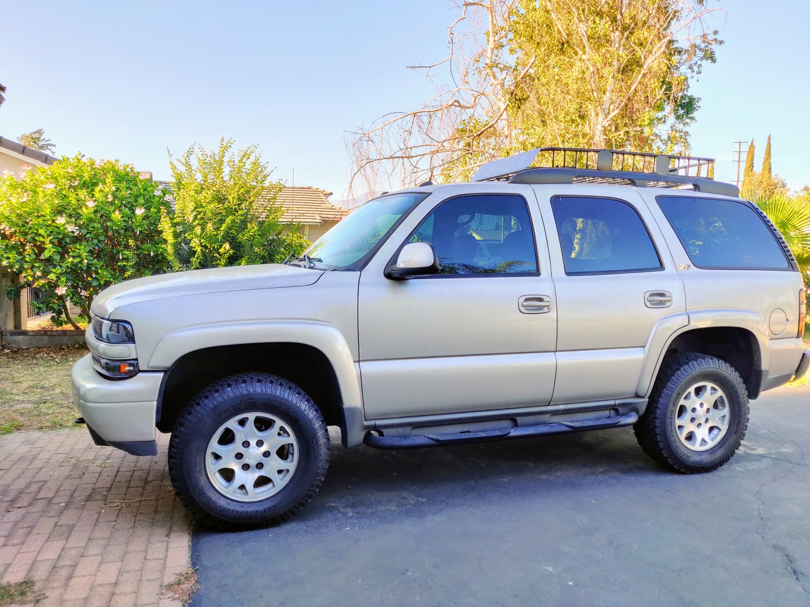

Hi y'all finally got my 2" lift installed with some BFG tires
Bilstein 2500hd shocks all around
2" rear spacer
Front lift torstion keys.
Oh man what a difference in ride height and just overall driving the truck , my truck was on Stock suspension with 155k on them.
Got a fresh 4 wheel alignment also , can't wait to start camping and towing with her, got my tow mirror's I'm gonna install today also

Nice look. Links to the parts you used? Bilstein part #s?

Looks awesome, was your Tahoe level to start? I was worried with mine being about 2" higher in rear that if it went up equal it would still be higher in the rear.

Yes it was level to start with, I added the keys to make it all even up front to the rear

I'll get them later for everyone, just so everyone knows you can run 2500hd shocks on the tahoe
Any update on the part number for the 2500 bilsteins?
Also, what made you go with those over the normal 5100s? Do you run a heavier load on average?

According to Rockauto these are the part #s
BILSTEIN 24186735 Front; Base Model; LS Model; LT Model; For Front Lifted Height: 0-2.5"; With Torsion Key Lift
BILSTEIN 24186742 Rear; Base Model; LS Model; LT Model; For Rear Lifted Height: 0-1"
To level a z71 with 2" rear spacers must take some serious bar crank!
