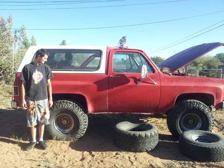

Sorry it won't let me post a pic of my old k5
Sent from my LG-M430 using Tapatalk
