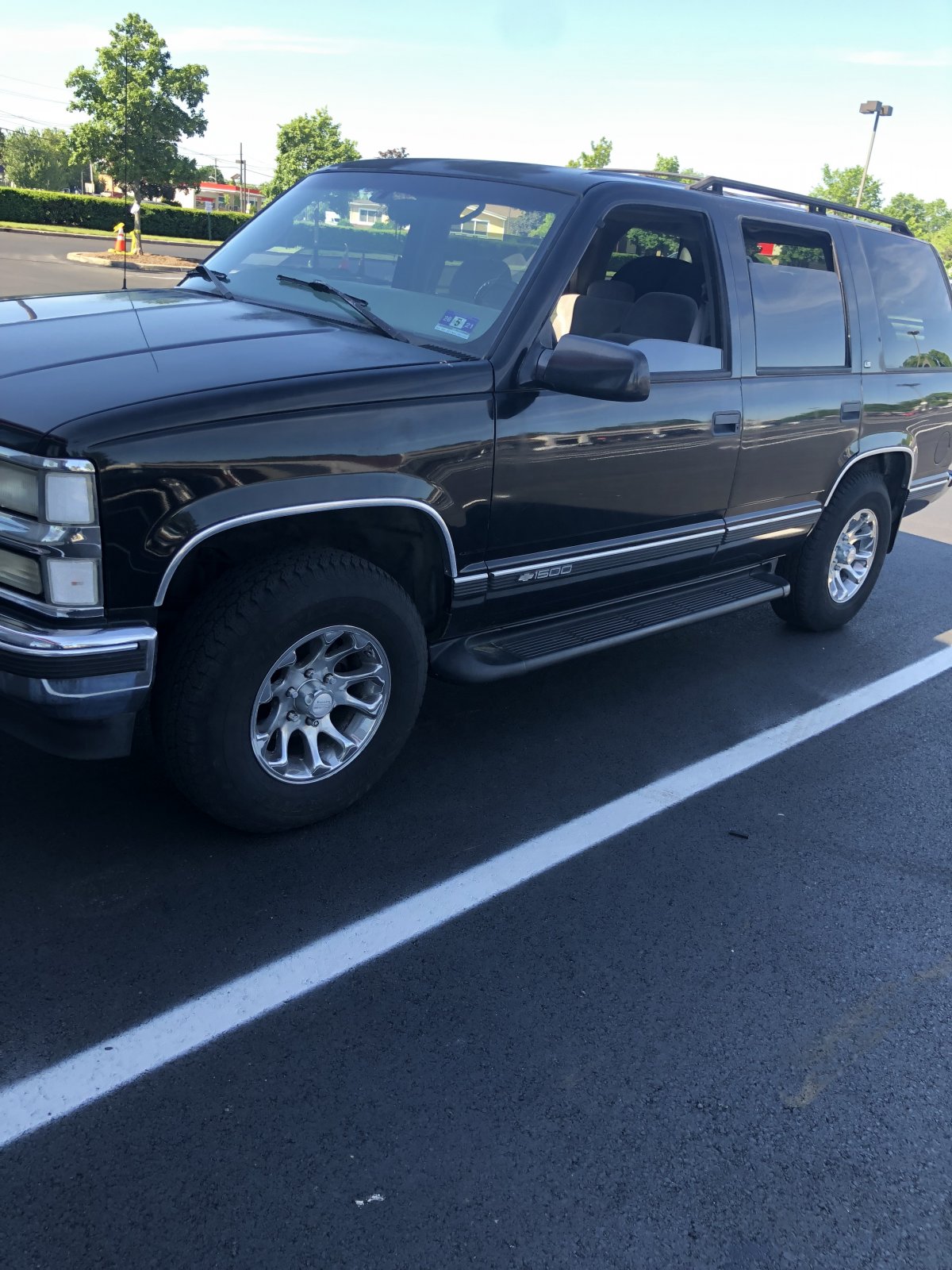

hello all. picked up a 97 a week ago. 88k original mile truck been sitting a while but clean.
came with 16s and tires that were all cracked up- found some clist wheels and good tires- 20s for 230. purchased. did front brakes. put wheels on, turned down the stock torsion bar keys a bit.
want the truck lower. looked at lowering keys but saw a bunch of issues getting them out - so not sure its worth the pItA. for 100 keys- or spend 2 and get good spindles. read djm- might be the way to go- won't push wheels out.. my cheepo craigslist purchase was good to me on one end. 5 wheels and tires with good meat for cheep. but i dont like the way the front tires stick out - rears are good and will tuck if i lower. but the fronts- not so happy right now. but know with spindles id need bigger wheels so for now- they will do.
was under the truck this weekend checking things out. i was gonna put shackles i have in the garage on but didn't want the rear lower than the front.
so the question now- can i use 98 silverado flip kit instead of paying more for a 4x4 kit?

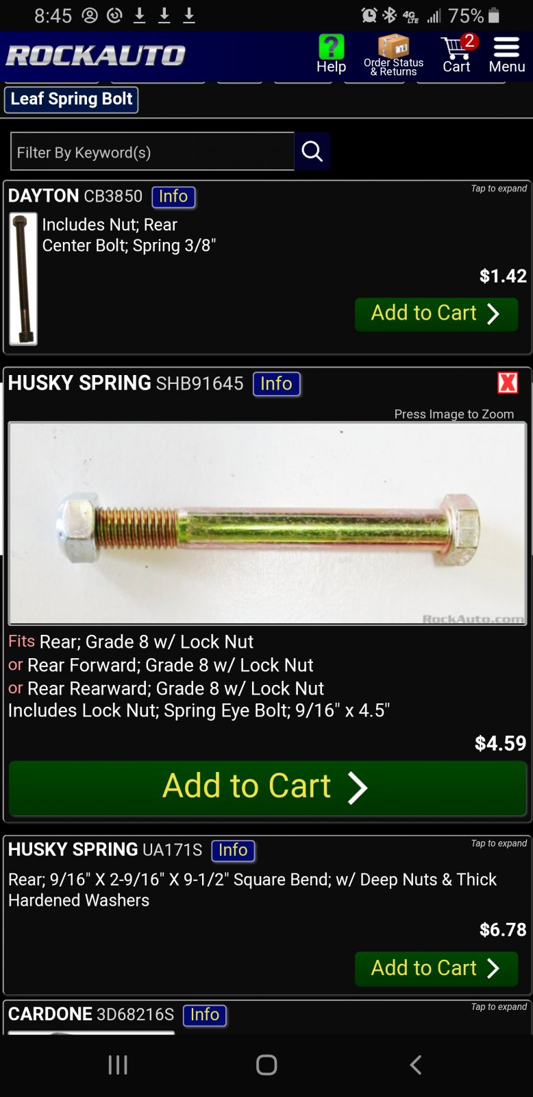

low miles but its still a 97 might be a pain in general to get those bolts out. whenever possible i dont mess around with suspension bolts and buy replacements ahead of time. bolts are cheap compared to finding out after you need them anyway or just the frustration of getting a bolt out.

this sounds like a good idea. i was going to put shackles on the other day and it seemed the 2 on driver side rear, came off easy enough. but i know the one by the gas tank will be a pain.- any chance you know the size or where i can get that info-
just so i can grab extras in the event i need to cut it out when the time comes

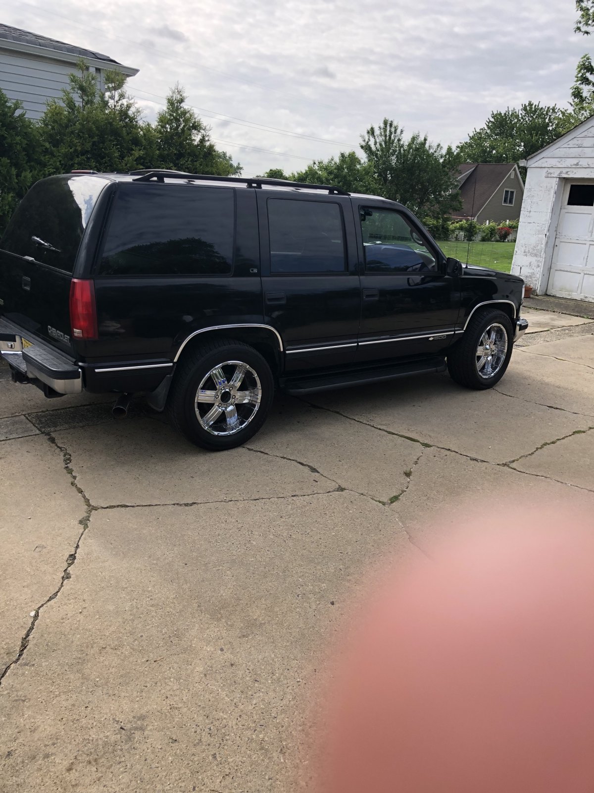

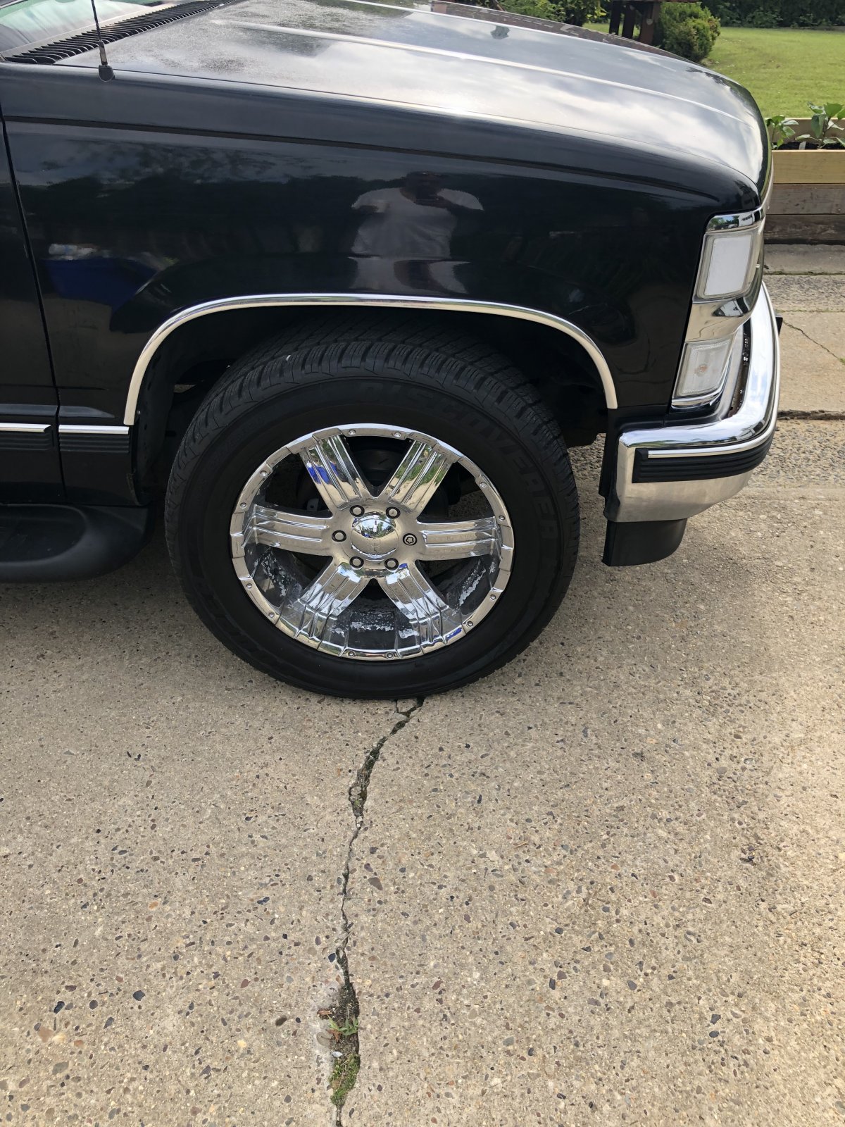

I don’t have that model rig but is the front sticking out further common? Almost looks like staggered wheel/tire set up but backwards.
J
jroman
Nov 30, 2013
35
you think thats possible?? i found on c list. super cheap with good tires. when i picked the truck up, tires where shot. so for 200 i jumped on these.
never thought that they make 20s in staggered fitment??

Thats just the track width of the truck... GM trucks have been like that for years.... fronts always stick out further than rears. Cant help you on the drop.... i have no clue

Also didn’t notice the wheel was turned a little. You can get staggered wheels in any size. spindles up front are the way to go. Maybe @iamdub or @PNW VietVet might have some insight about the rear.

Trucks commonly have a wider front track to help with stability when turning at speed. But the difference in your front looks excessive. It could just be the pics and the wheels being turned a little. Them wheels definitely have less offset than the other ones or stock wheels, making them stick out more. Wait until you get the right wheels before lowering it.

Yes the front track width is wider on the GM's. Maybe others but have never owned or cared. I doubt the new wheels are offset on 2 of them at the front and narrower at the rear. The wheel offset is the same and the front width is wider. If you don't like that, spacers at the rear or a different offset at the front can change the "look" for you. I had a new 2 door 96 Tahoe when I moved to Oregon from KC, Mo. over 24 years ago. Wish I still had it and do look every day for another but so many times they are in too bad of shape for me.

didn't think wheels were staggered. again. didn't ask or check. not a fan of the front poke. id like wheels even or under fenders.
