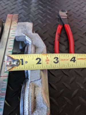

Ok, so I didn't even need to remove the existing caliper to figure out this wasn't even close to working. My 2010 Tahoe Z71 with the factory 18 inch wheels had about .75 inch clearance between the wheel and original caliper, which is very generous. The original caliper measures approximately 3.5 inches from the mounting flange to the outer edge of the caliper closest to the wheel. The new 2019+ caliper measures approximately 4.75-4.875 inches from the mounting flange to the outer edge of the dreaded casting "bump". Looks like new wheels are going to need to go on here since I just bought new bfg ko2s. Pics attached. We need this info stored in a sticky or something, if possible

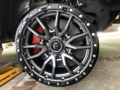

Test fitted this fuel wheel today...worked no problema.
Ordered for a 2020 Silverado. 18x9 ET20
And good spoke spacing to highlight the calipers.
Finally I can move forward......gee.

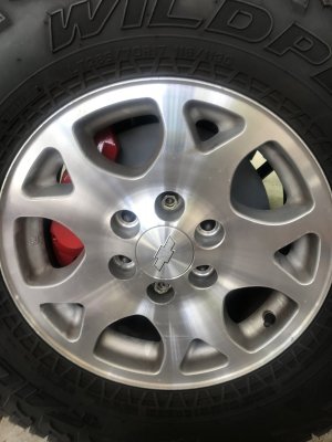

My Z71 wheels did not clear the caliper with a 1/4" spacer but did easily with 1/2".
Its probably somewhere in between.
With 1/2" spacer the studs only ended up with about a lugnut worth of thread though....so would not run that except for storage
or at a body shop.

Wheels fit fine....
If Dan doesn't buy them I will. I would like them powdered first though.
or at a body shop.

Good to know.....
Glad your 20 will fit with minimal spacing.
The barrel clearance on the 17s is way tight!
I bumped and scratched the caliper too many times trying to fit the Z71 wheel.
Its hard to try to delicately lift a 75lb wheel over the rotor and caliper without a bump.
