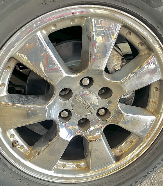

Does anyone know if the hybrid wheels from the NNBS line will clear these brakes or is there not enough offset? Wheels are 18 inches.

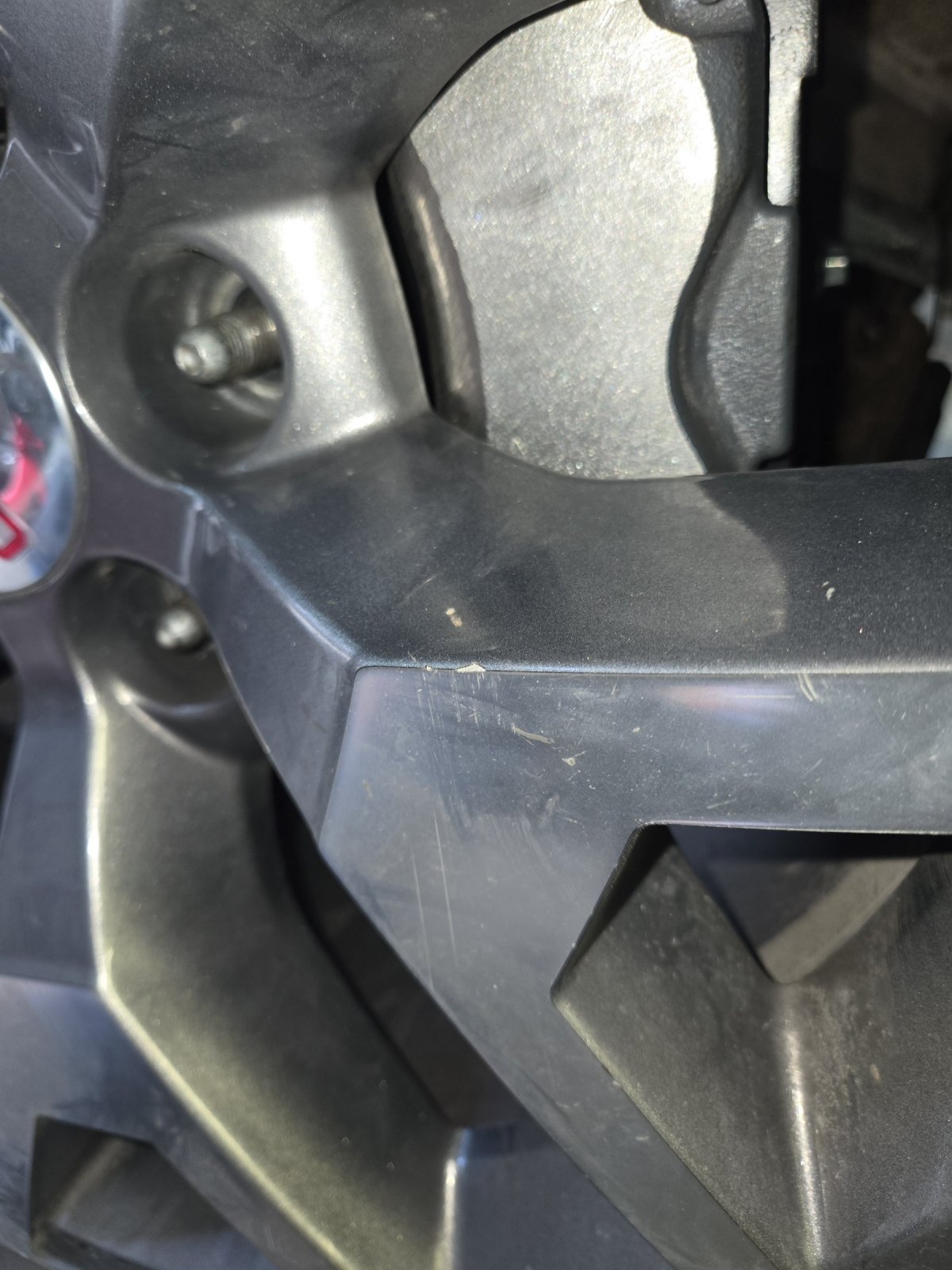

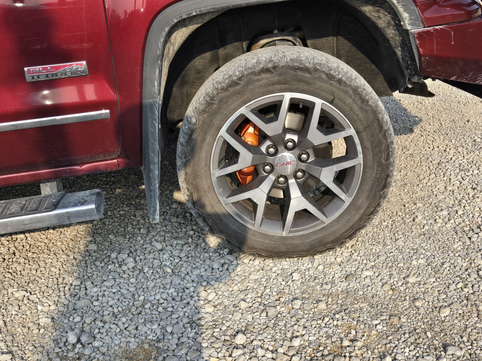

Has anyone tried 22” TBSS wheels with the 4 piston, with or without hump?
Have a set but would suck if they don’t work as love the wheels I have.

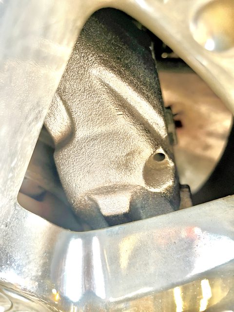

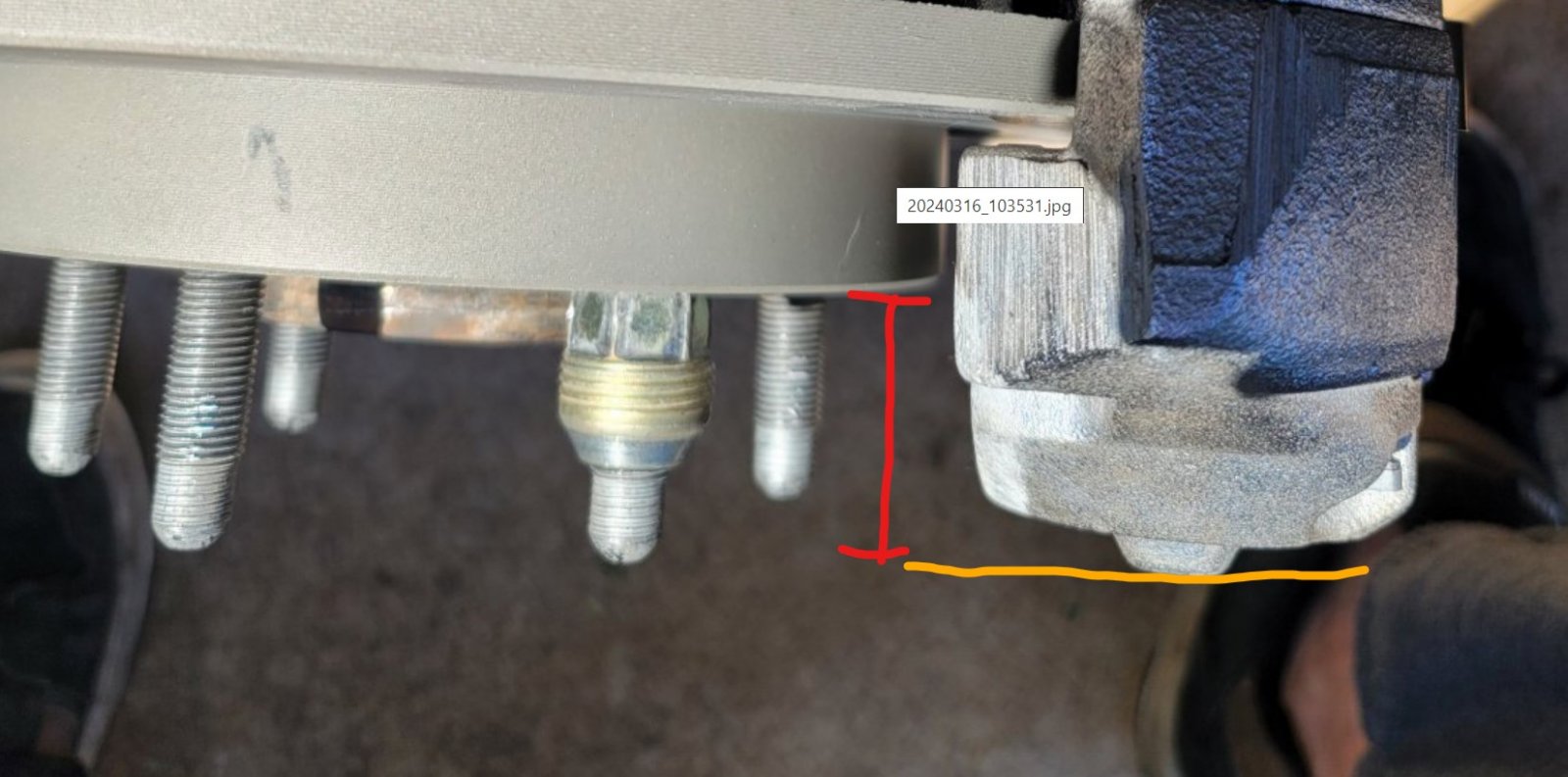

Resurrecting this to ask a question - has anyone measured how far these calipers "stick out" from the hub face? 65 pages of thread and I couldn't find it. Marked in red from someone else's very good photo of the install. If we knew this distance it would probably help with the "will my wheels fit?" questions, as you could just stick a tape measure in there and see if you have enough clearance.

The picture you posted is one I took for my install. (thanks for the compliment!) I thought about taking measurements like that when I was doing the install but I didn't as so many wheels have a different way the spokes are made so I didn't think it would come into play. Mine are 22" texas edition reps and as you can see by the pics they come out quite a bit with a curve and do clear, but not by much. Whereas some come almost straight from the mounting point out. I will try to get out there today and take some measurements of both the furthest point out, as well as if you were to shave the hump off. Were there any other measurements you need/want while i'm in there?

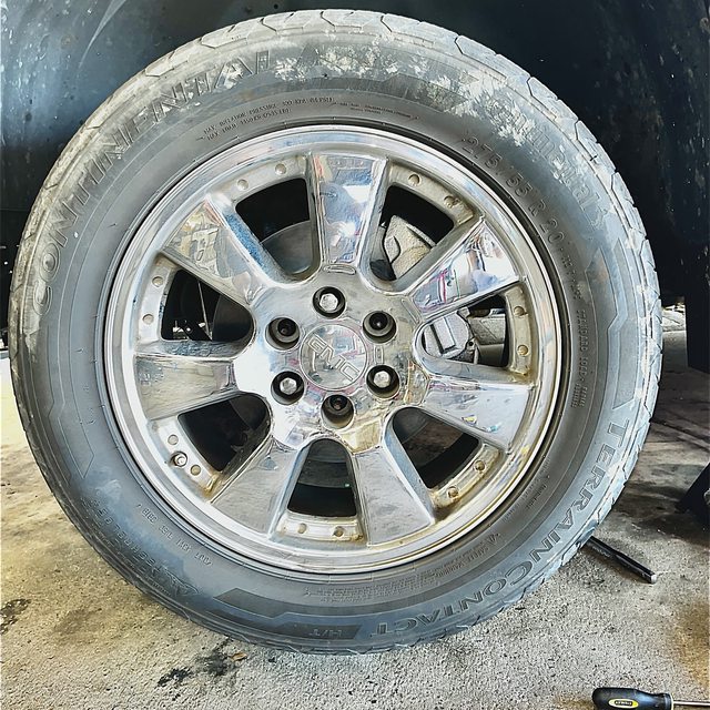

I didn't get measurements of that when I was test fitting them for my truck, I do know that the new rotors set back about 3mm farther than the original rotors my 22's cleared by roughly 2 to 4 sheets of paper after shaving off the hump and my 20's off my 2014 sierra cleared by roughly a 1/4" both of these are on 2014-2018 half ton trucks. I believe that the older models some of the 22's cleared but everything else would hit. Also to mention these 22's are off my 2010 sierra originally
This is the 20's
This is the 22's

maybe a measurement of your current wheels that fit - distance from the brake rotor surface to the inside of the spoke? My '05 Denali has the 7-spoke 20's, which are 8.5" wide and +22 offset. There's a lot of clearance behind these wheels, but is there THAT much? I don't know!

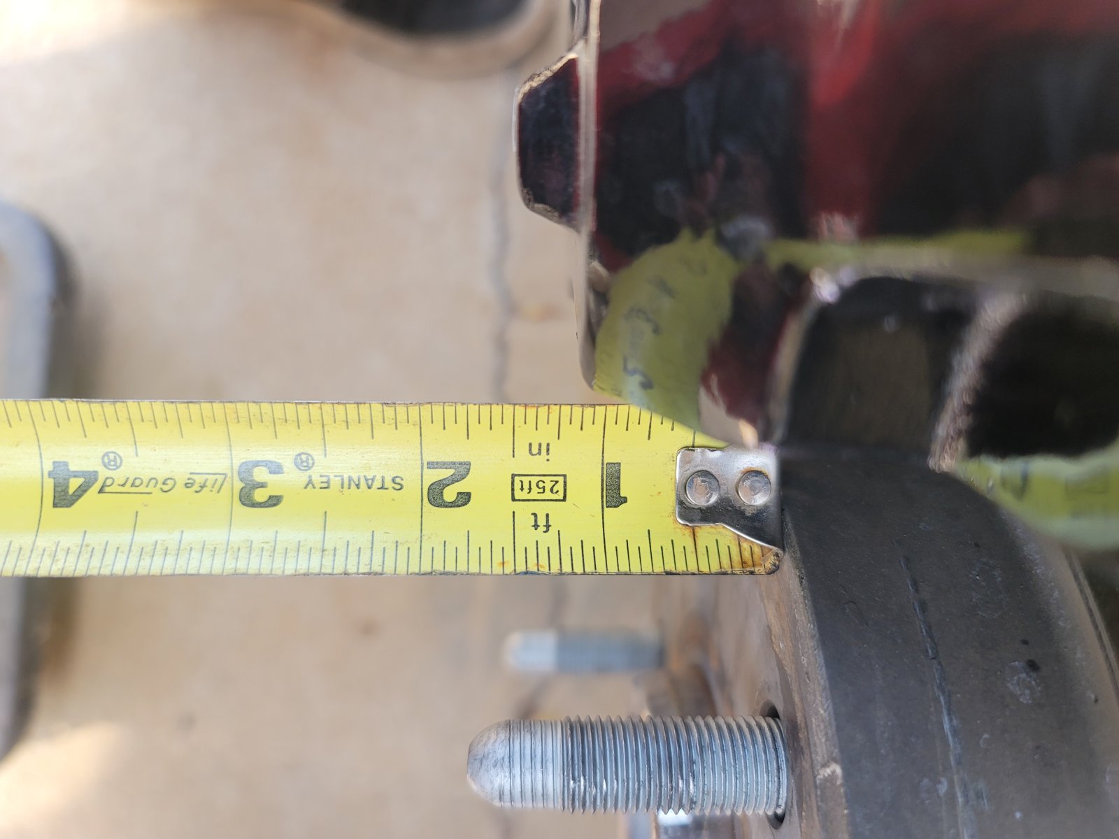

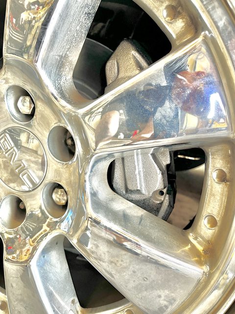

Ok...Finally got a chance to get out there and take some pics, but I apologise for the delay as my back has been, I'll just say, less than cooperative. I had a straight edge and checked measurements but couldn't take a pic holding both by myself but these are the measurements. If you were to shave the hump off, it's 1 1/4 minimum to clear....If you don't shave the hump off it's 1 5/8 minimum to clear. Rotor to spoke varies on my wheels as the have more clearance as they go out. And for reference cause it was asked...my wheels are 22"x 9" with 31 offset. Hope this helps!
