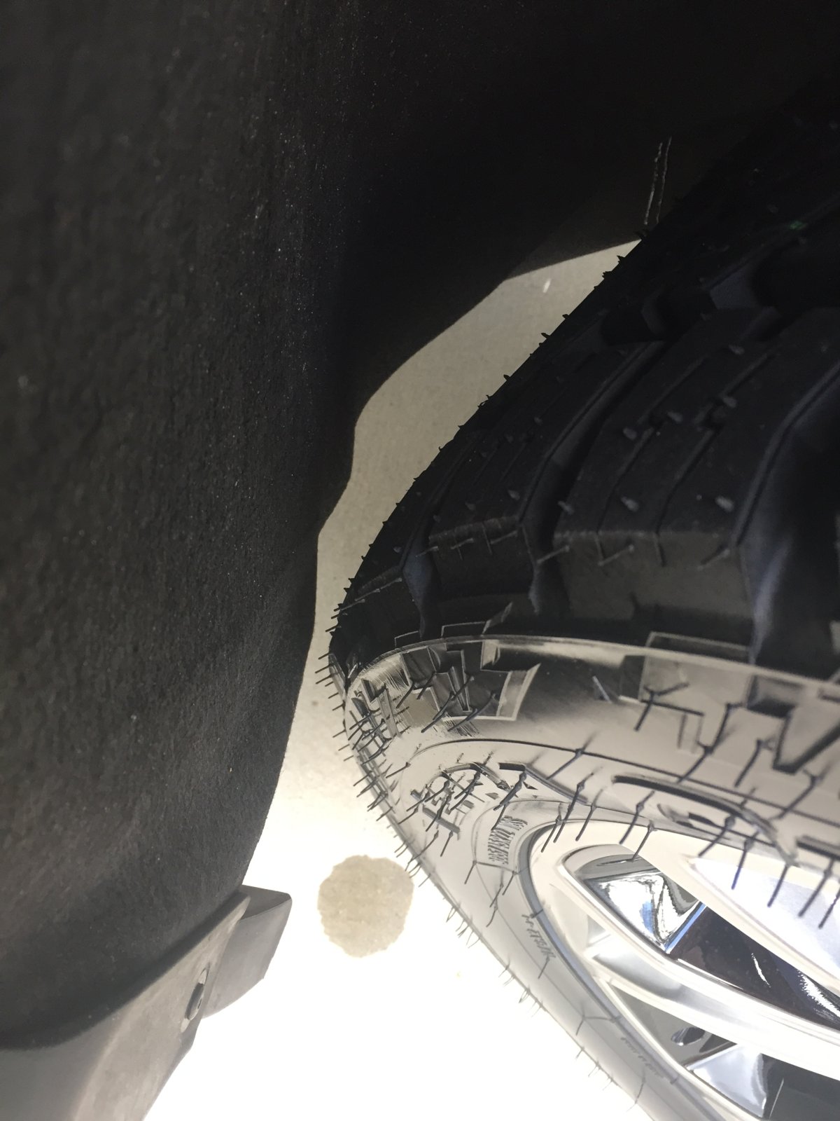

Just installed 305/45r22...32.8"
305/55r20 is 33.2" so .4" difference. I think it will fit. Worst case zip tie the liner back a tad...
Clearance on 2" RC level

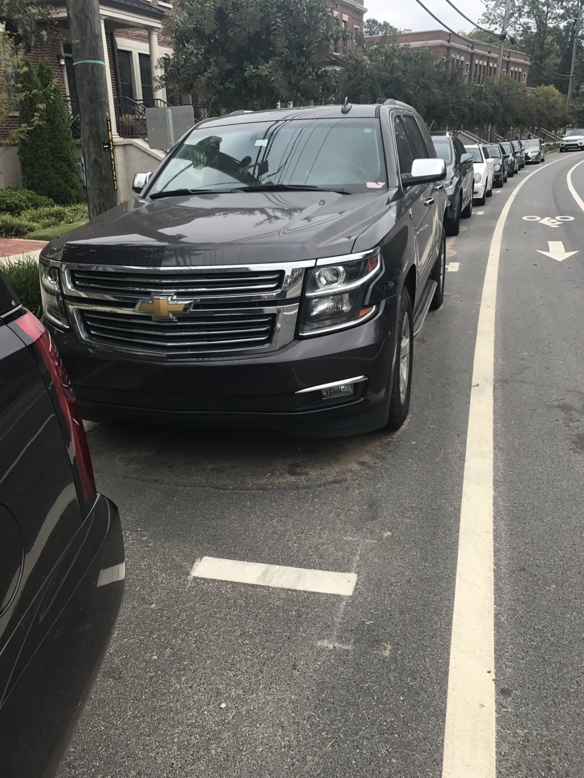

Stay tuned - I'll try to snap a couple pics
Finally got around to taking a few pics. Mine is on the left with stock suspension and a ppv valence and the one on the right has what appears to be stock suspension and 275/65/20...it looks meatier in person.
