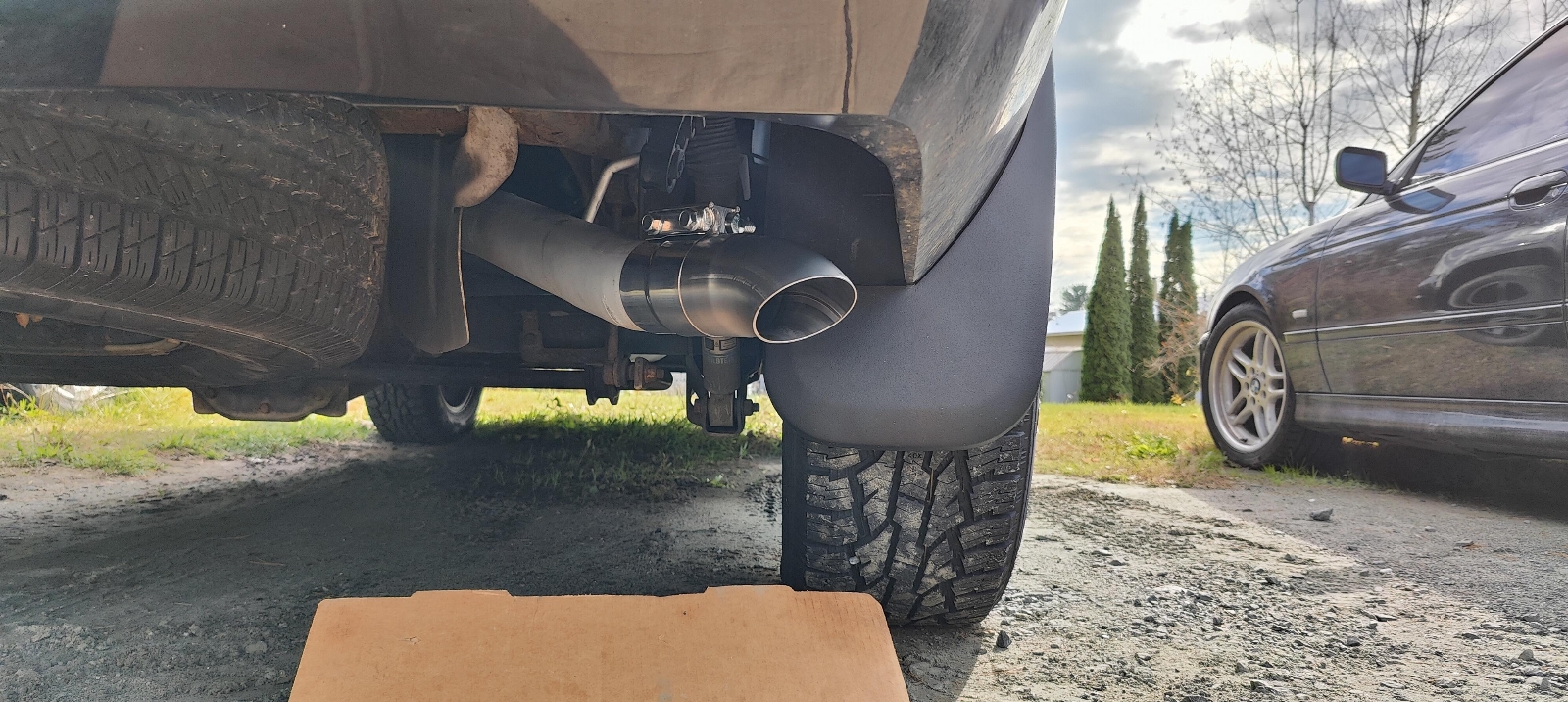

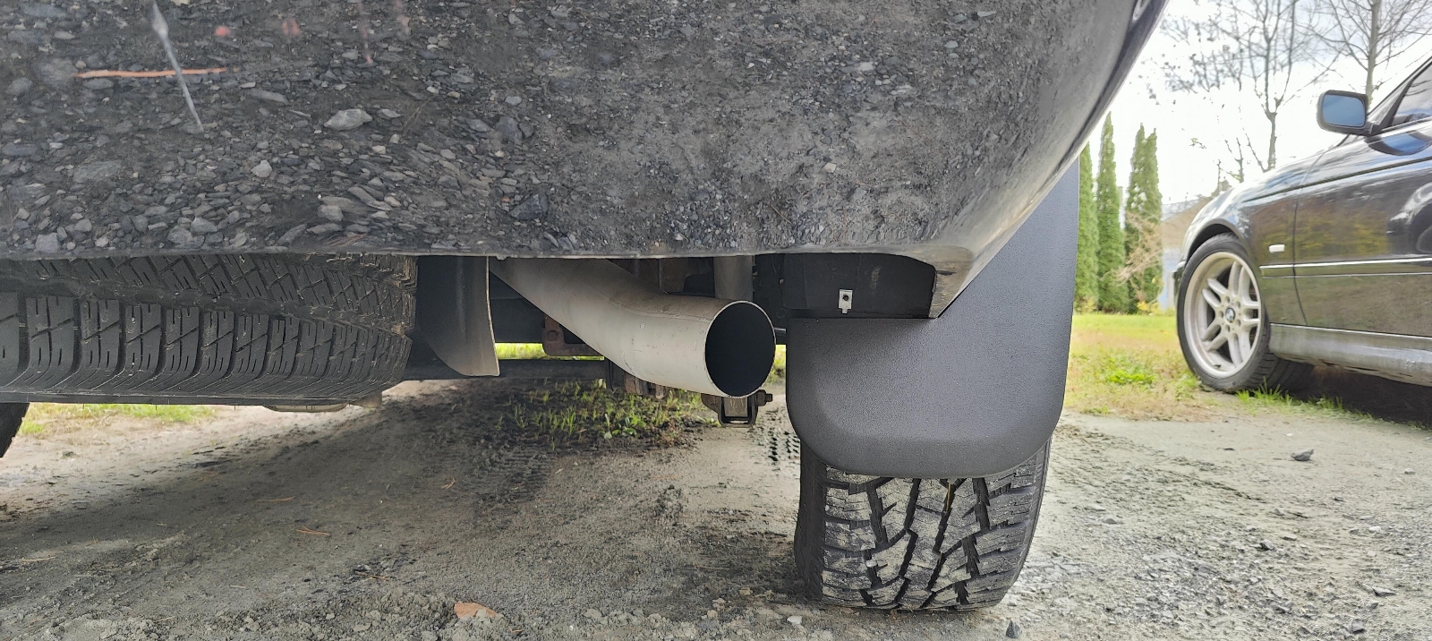

Small update:
I had my truck up on a lift to be Fluid Film undercoated (mmmm.... sheep skin oil) and was curious to see how the primer & paint was holding up.
It seems to be doing well so far: no hot spots, bubbles, or rusty discolorations yet.
The 3" Kooks turndown I added to the tailpipe (the included tip looked gross, IMO) seems to have helped redirect the sound enough to lower the noise levels inside the cab slightly, which is nice.

Small update:
How you liking the new flaps so far?
They seem to be holding up well, and are doing all the things mudflaps do.
My only issue (self-inflicted) is I need to do some more trimming on the inside of the front guards. The still rub at right before full-lock.
I wish there was a version for the leading edge of the wheel well, to prevent all the spray thrown forward by the rear tires.
