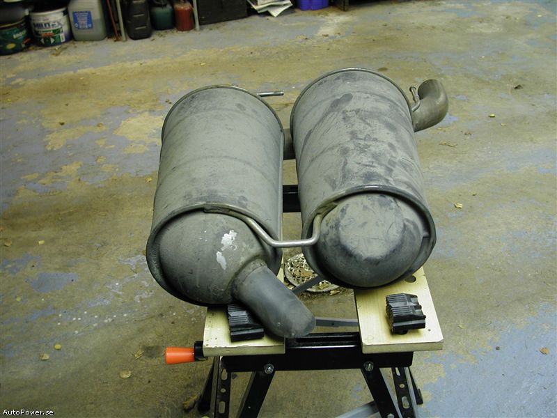

The factory exhaust on the 4.4 liter V8 E39 BMWs I've owned had one of those dead-end resonance killers. They were called "scuba-tanks".
The left muffler is the real one, and the one on the right closed. And, you can't see it in this photo, but there is a weighted dampener attached to the pipe to reduce vibration. In OEM form, they are incredibly smooth V8s, and very quiet. I cut off the muffler like in this picture and extended the pipe with a long turndown. It let the V8 roar, but not annoyingly so.

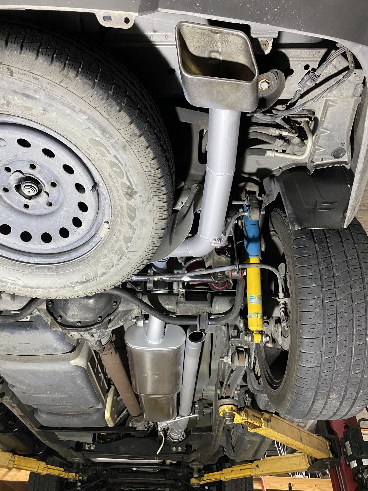

I drive a lot for work so I check out car's exhaust tips and take notes. I liked the size, shape and angles of those on a Saturn Outlook the most, so I found one at the salvage yard and cut off the tips. Factory tips are usually good quality and, from a salvage yard, are often really cheap. At that yard, they're rang up as "exterior trim- medium". I got both sides (dual exits) for around $6 and used the RH side:

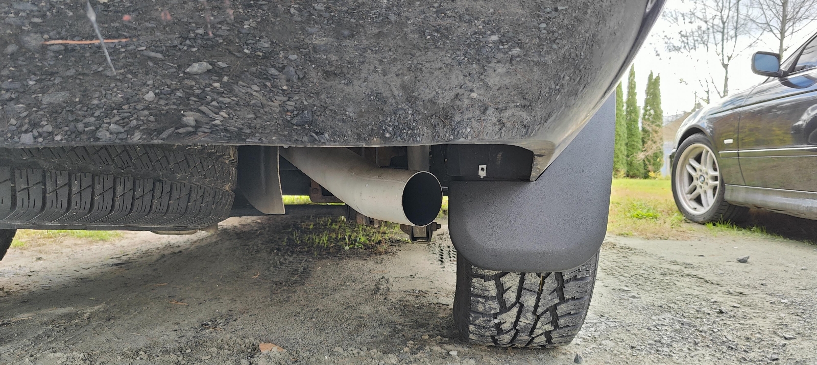

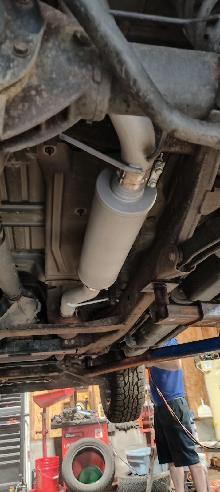

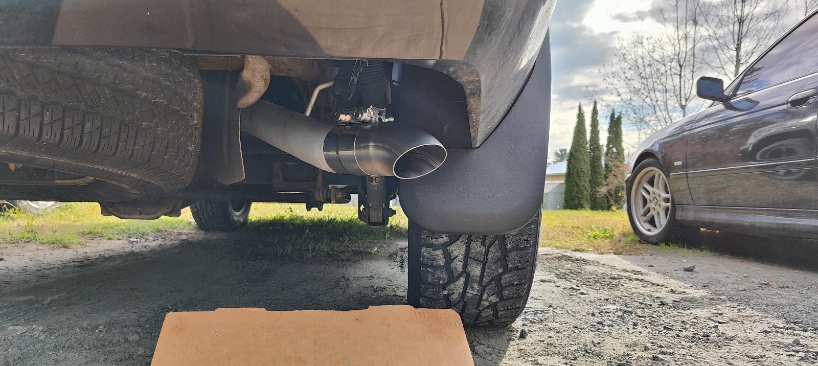

Small update:
I had my truck up on a lift to be Fluid Film undercoated (mmmm.... sheep skin oil) and was curious to see how the primer & paint was holding up.
It seems to be doing well so far: no hot spots, bubbles, or rusty discolorations yet.
The 3" Kooks turndown I added to the tailpipe (the included tip looked gross, IMO) seems to have helped redirect the sound enough to lower the noise levels inside the cab slightly, which is nice.
