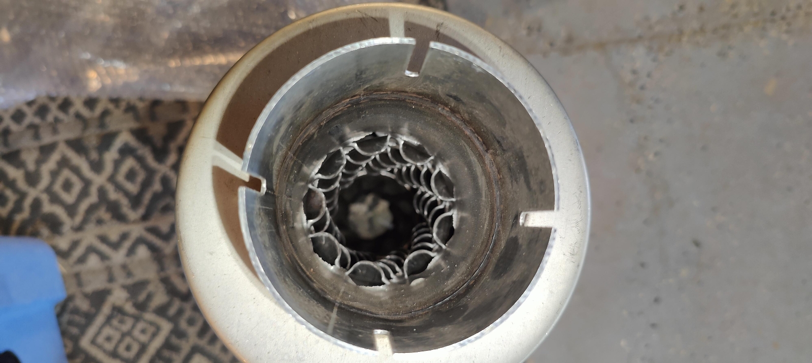

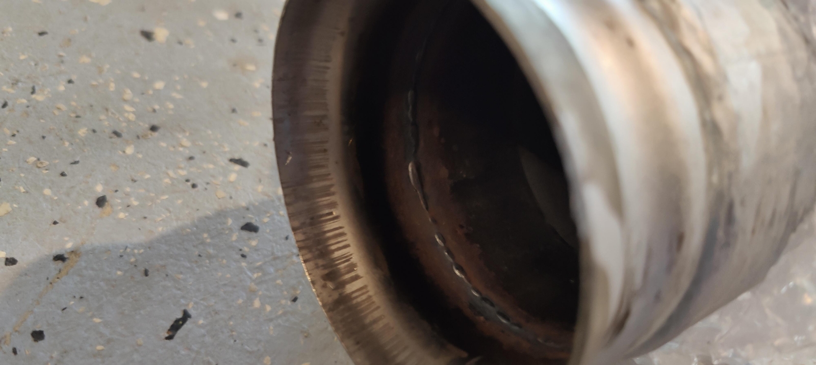

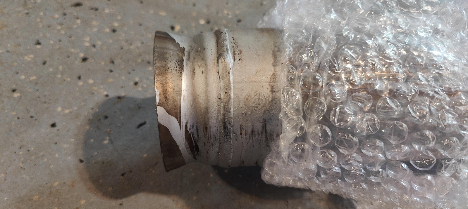

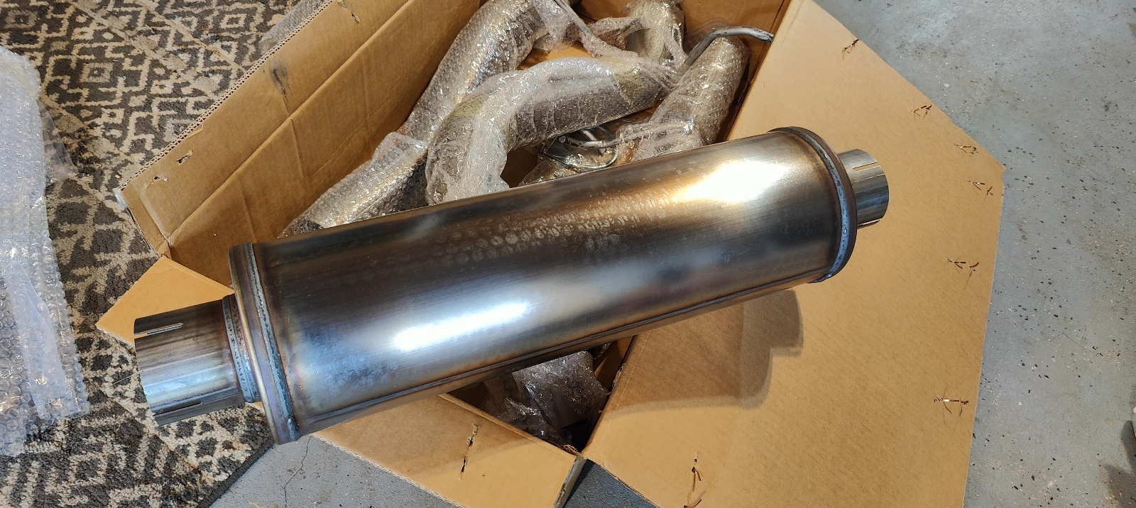

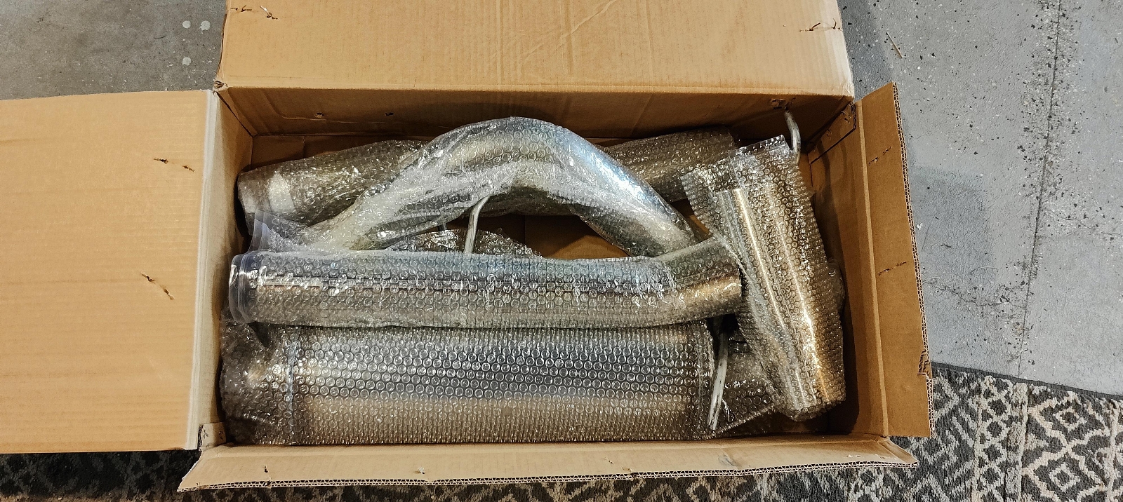

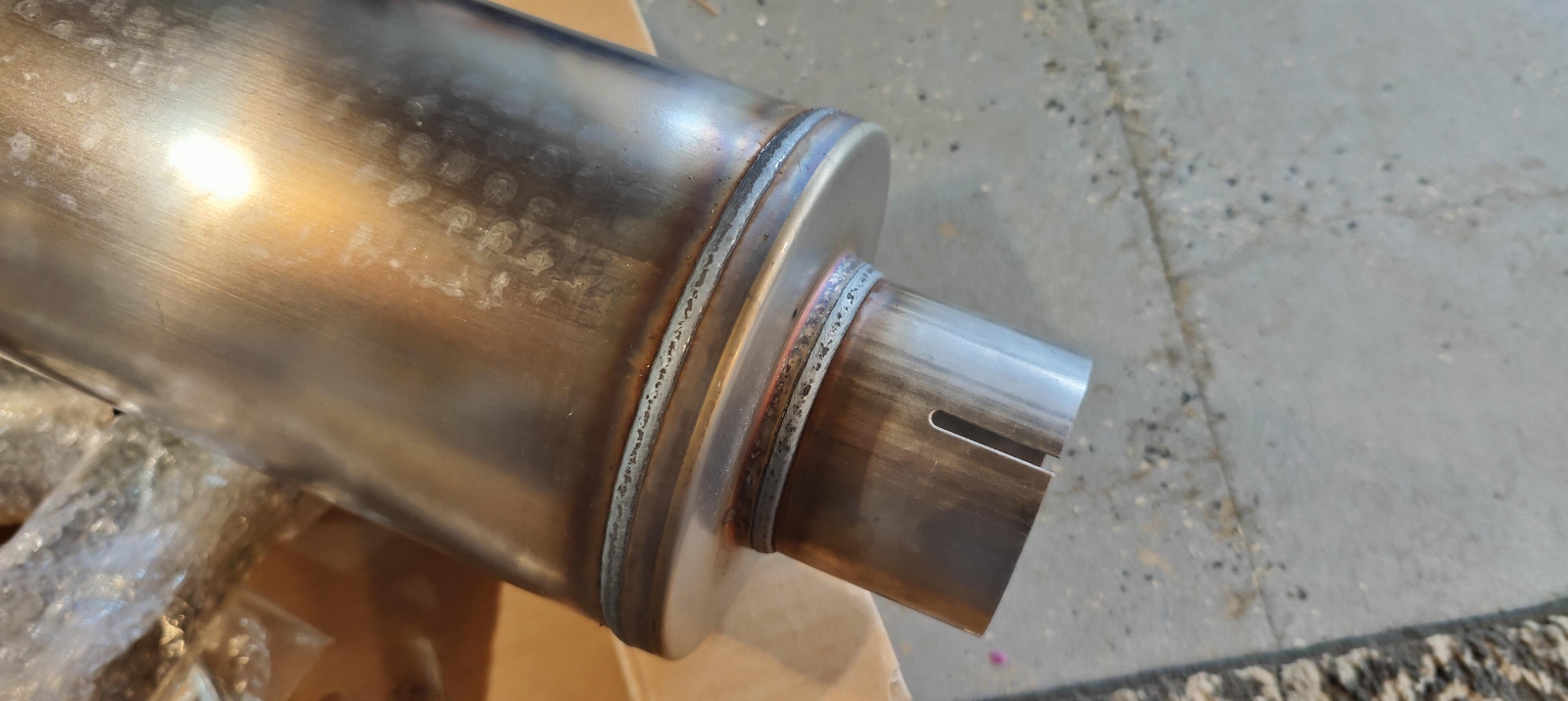

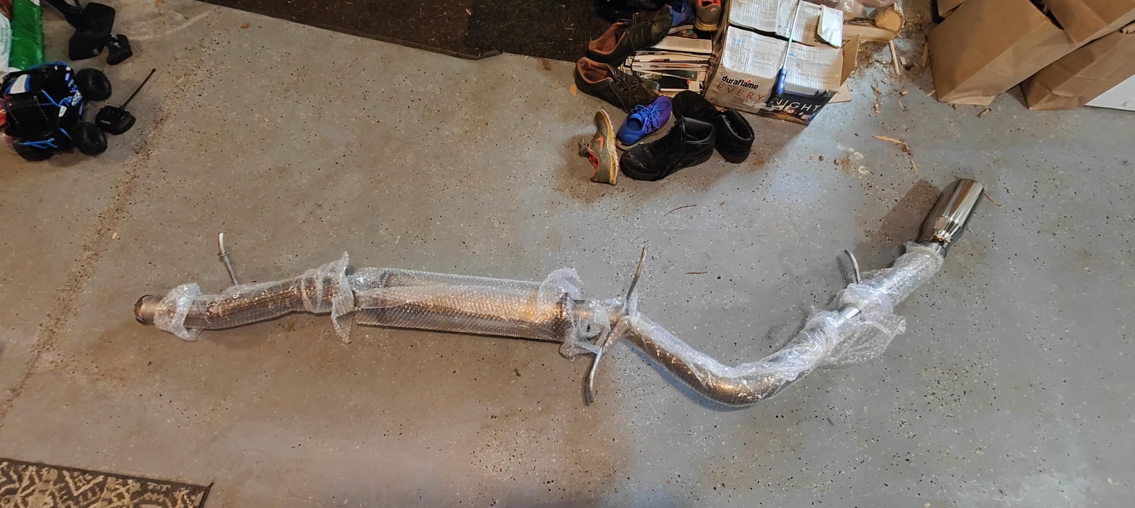

FedUPS just dropped it off, and initial thoughts....
Packed reasonably well with no rattles.
Initial mock-up to see if the pipes would fit together easily... and they do slide together with minimal effort.
Catalytic coverter joint. Seller confirmed it will mate to the 2.75" factory joint.
Weld inside.... looks like a robot did it.
Muffler: 21" body, 26" overall, 6" diameter. I think it's going to be loud.
Yeah....
Robot welds...

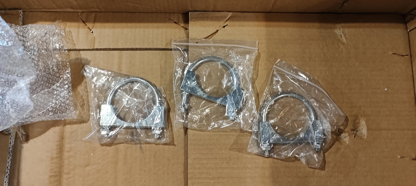

The crush clamps that came with it. I bought some wide 3" band clamps to use instead.
Overall, I'm not horrified with it, for supposedly being T409 for a 3" exhaust, $300 shipped. I put some calipers on the tubing, and it's actually 2.875" tubing expanded to 3" at the ID of the muffler/tube joints. I'm not an exhaust pro, so I don't know if that's correct for a supposed 3" system, but I hope the 3" band clamps can tighten down enough.
I'm going to try to run out to the AutoZone near me and get some high-temp primer and black paint. Chome is icky...
Hopefully this weekend I can get it painted and installed. I am a bit worried it's going to be loud and drone without a resonator near the tip. I'm already looking for replacement mufflers that have the same overall dimensions.

I agree about the chrome - personal preference. @Joseph Garcia Joe has dual exhaust living behind the 6.2L in his Denali but I considered going that way too but plan to go the route of a black stainless tailpipe that I saw on @RichardCranium Darren's PPV. Good luck with getting it all fitted together and look forward to your thoughts on the system.

If I didn't know better I'd think that @Dantheman1540 made those welds. ;)

Considering the price of stainless these days, that's a smoking good deal.

That definitely will be loud.

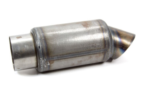

Maybe something like this in place of the exhaust tip. But, have it tucked up under the bumper cover enough to look similar to the stock resonator turn-down?
3" Muffler
I don't see that making a whole lot of difference. It might clean up a slight bit of rasp at high RPM as heard from outside the vehicle. But, not $65+ worth of difference. You can get a whole other muffler for $65 and not need special after-muffler additions.
Good point.
I found the AP muffler you linked for $cheaper on Summit. https://www.summitracing.com/parts/aph-xs2579

I saw it cheaper there, but their shipping charges make it higher than Amazon unless you don't have Prime.
Definitely give it a shot! You have nothing to lose. You might like it. At least your gf is cool with it!
If you like the volume and sound and only have a problem with it at a certain RPM (drone when cruising), you can attack just that frequency with a cheap piece of pipe and some math. You'll kill the drone but not muffle everything else, which negates the point of getting a louder aftermarket system.
