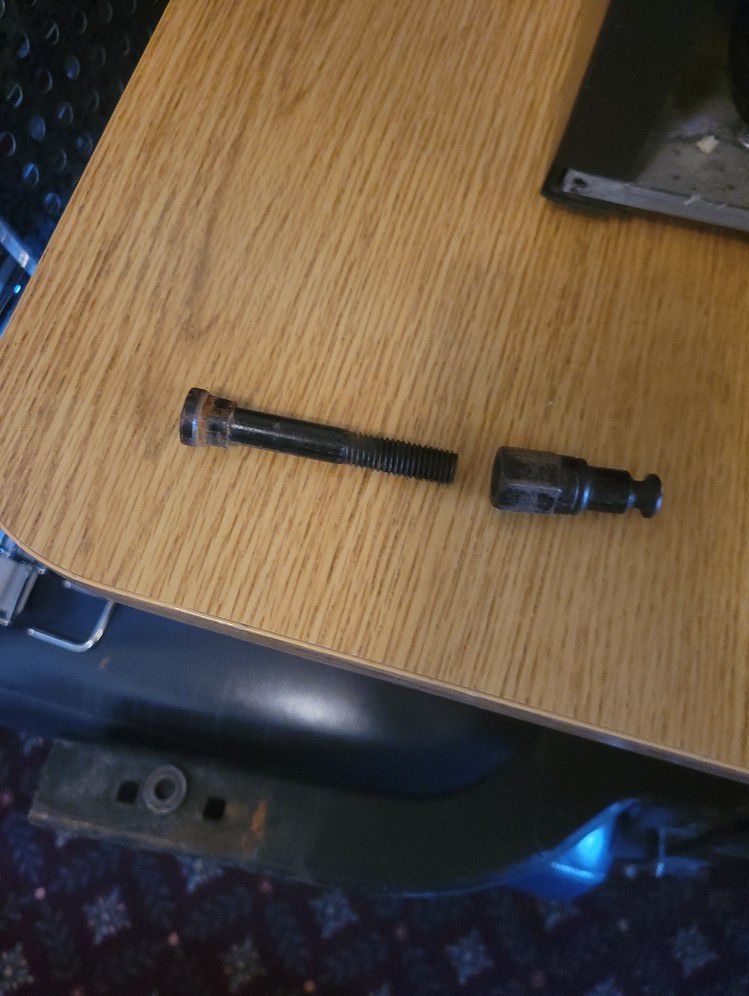

By chance does the bike rack hole have a nut welded inside of the tube?
it doesn't have any welded nut inside. the original pin (which I don't have) looks like this pic...

I had one of those and the lack of an interior garage rusted it out.
Before you drill it out I'd try looking to see if locks / bolts are still available for it. That square hole format is actually for its anti-rattle feature which is a huge benefit on a swing-gate rack.
