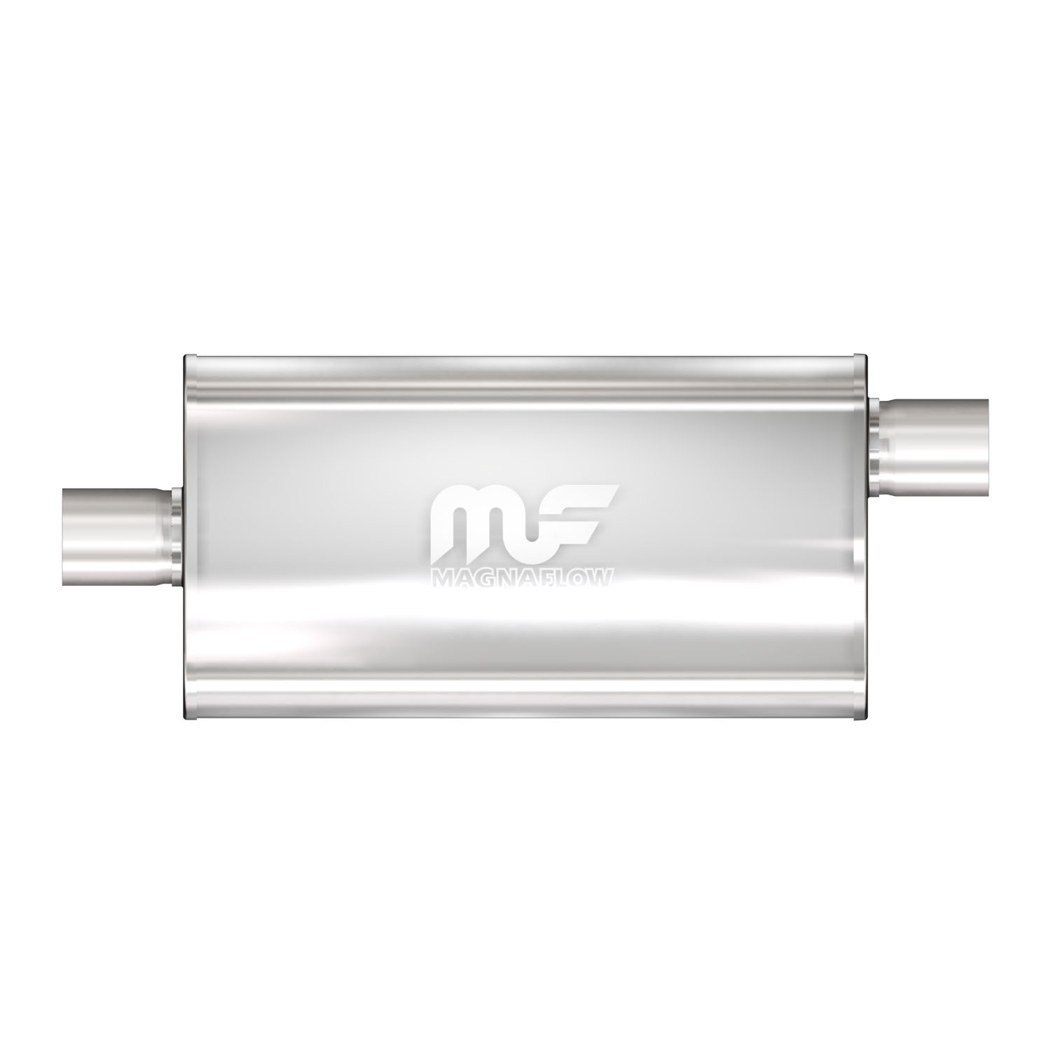

Guys i cut off the resonator on my escalade and left it turned down and replaced the main muffler with a magnaflow 12909. The stock exhaust is 3.5 inches from cat back so by far best way to spend your money.

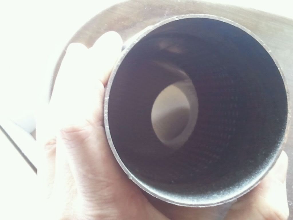

muffler you can see thru

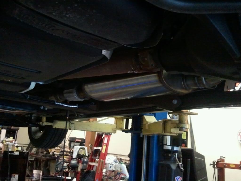

installed
NOTE--- you will need to get about 2 inches of straight 3.5 inch pipe. You can cut the portion before or after the resonator and weld that on the pipe coming into the muffler so everything will fit in.

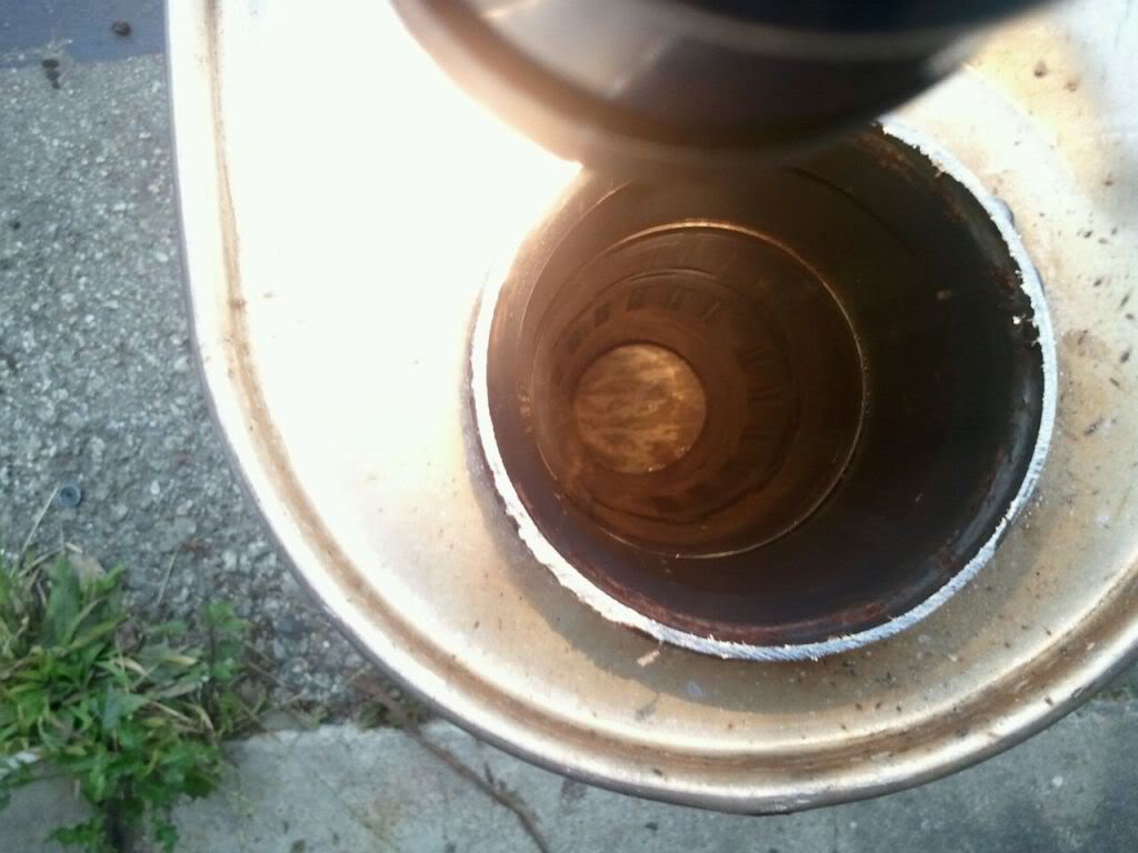

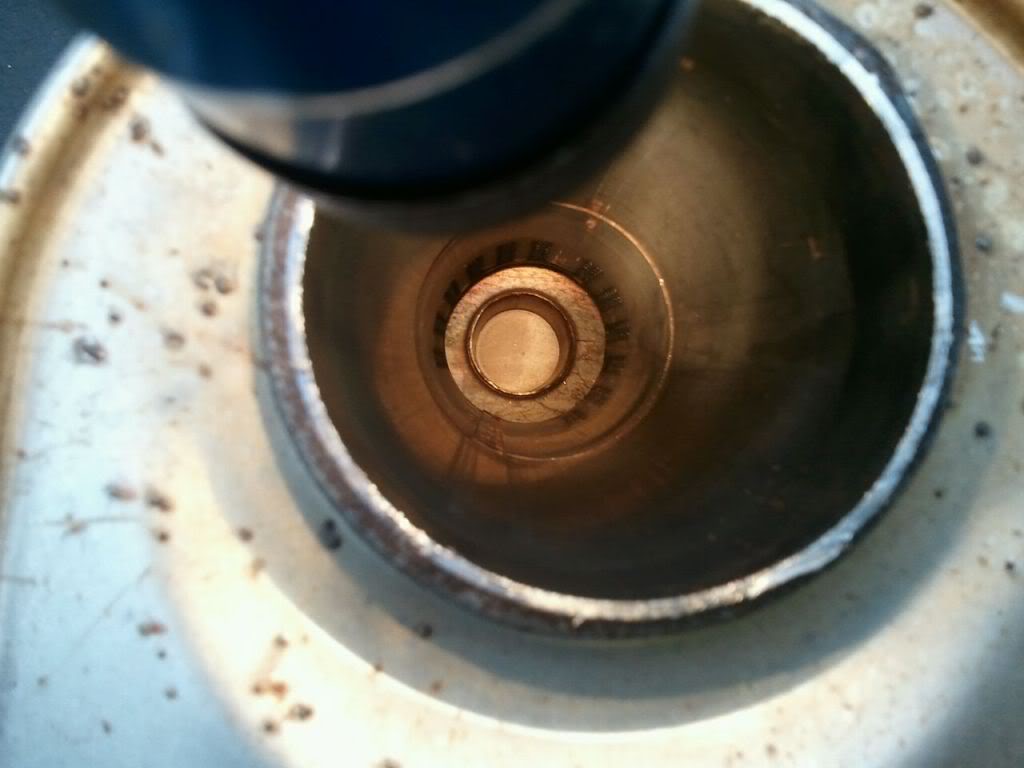

And here goes the stock muffler you can't even see light thru it from other side

Tony i bought the 12909 muffler because it had the 3.5 in and out but i see the factory muffler is offset on both ends where the magnaflow has a center as well as an offset outlet, so this is not a exact swap. I would need to change the whole piping underneath? Oh i have the 10 denali by the way.
Its a bolt in deal pretty much. You will need about 2 inches of the 3.5 pipe which you can get from when you cut the resonator off and you put the muffler at a angle like we did. i have a 2011 escalade and works fine.
