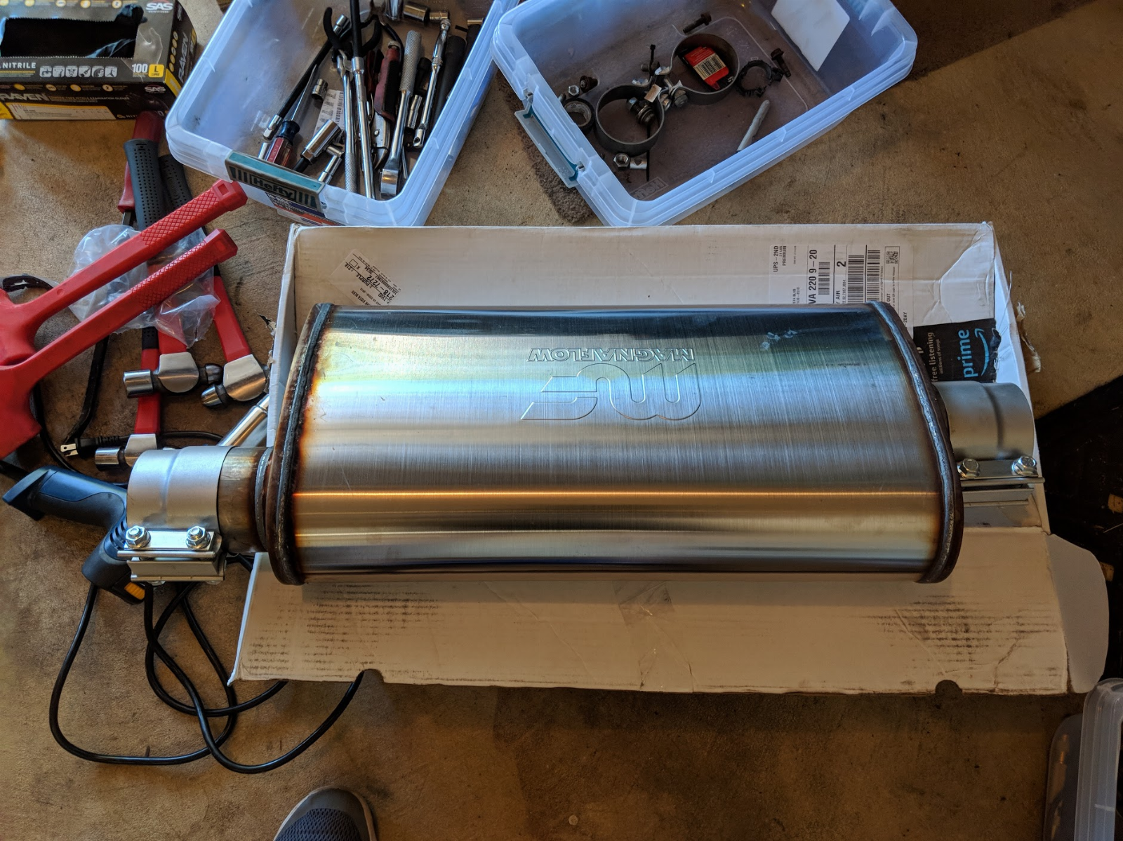

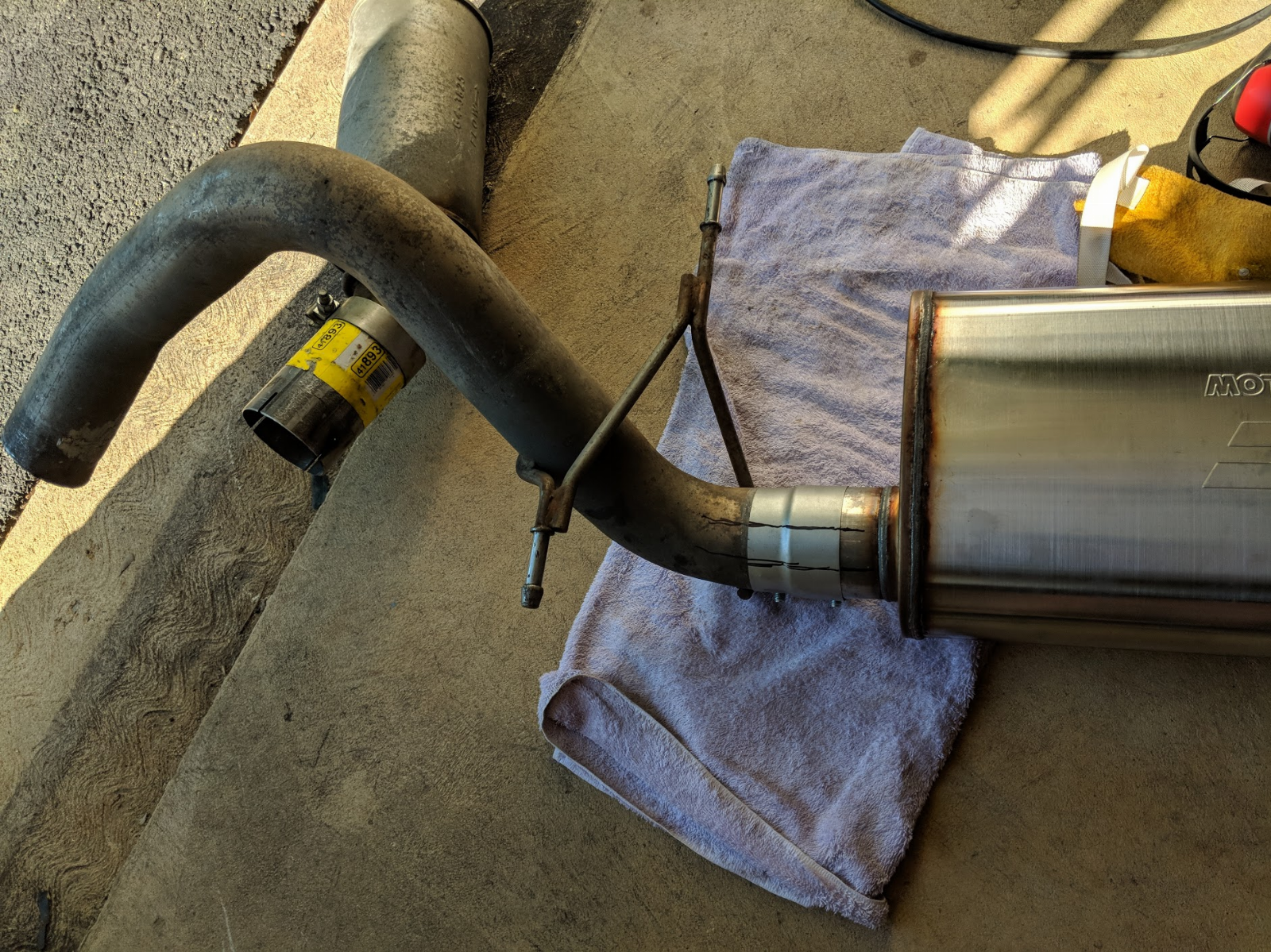

I have an 08 Yukon Denali, same platform as yours and also with the SLP resonator delete. Decent clamps will help a ton with the install. Its been a while but remember cutting out the old muffler and basically replacing with new. I don't remember the slightly shorter length being an issue.
Unfortunately I don't have great pics. I'll post what I have.

Those pics help, thanks. I take it since you are using clamps you didn't weld them together? Did you have to use any spare 3.5" pipe, or did those clamps give you enough wiggle room?
Would you have a link to those clamps by chance? If I can avoid welding, I'll DIY this sucker.
No welding but intended to "get around to it". So far its held for a year and I have better things to do. I might weld it someday though. Though periodically checking if the clamps are tight is easy.
I got a few of these clamps
https://www.amazon.com/gp/product/B073ZBF9L5/ref=ppx_yo_dt_b_search_asin_title?ie=UTF8&psc=1
Also this pipe
https://www.amazon.com/gp/product/B0015KWCJ6/ref=ppx_yo_dt_b_search_asin_title?ie=UTF8&psc=1

Found a good custom shop that too care of installing the muffler. Took about 15 minutes and fit perfect. They also installed the flange from the stock y pipe into my speed engineering y pipe. It sure parts to have the right tools and skilled people doing work.
