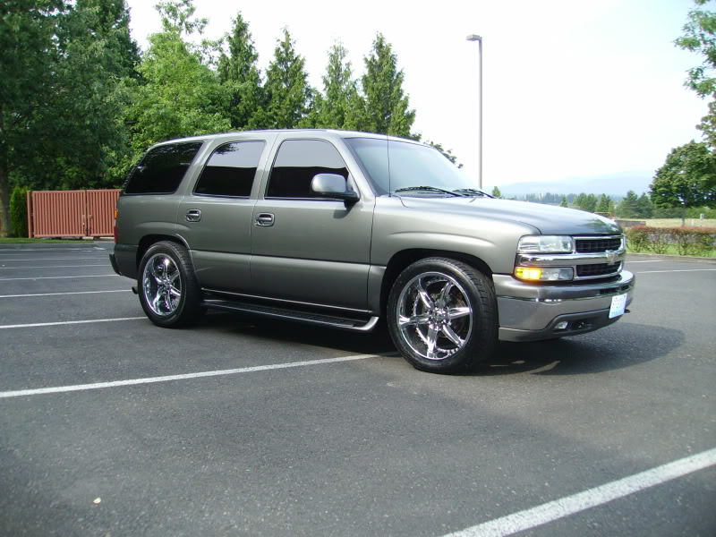

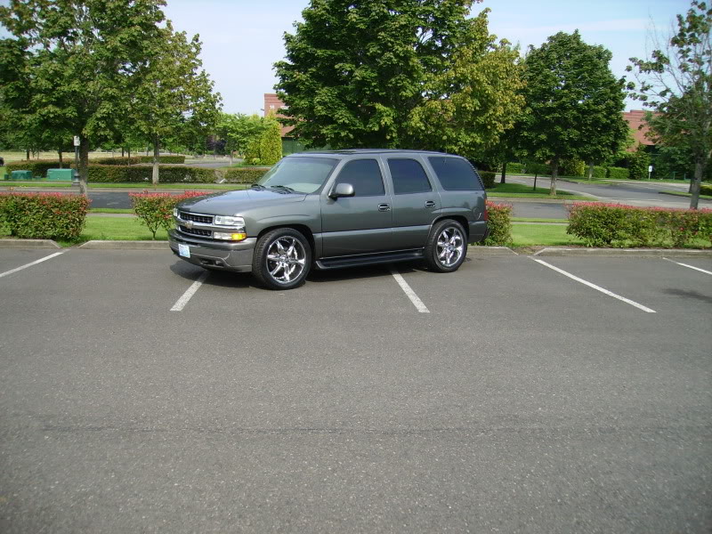

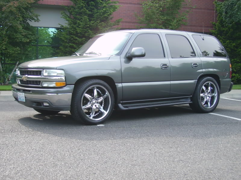

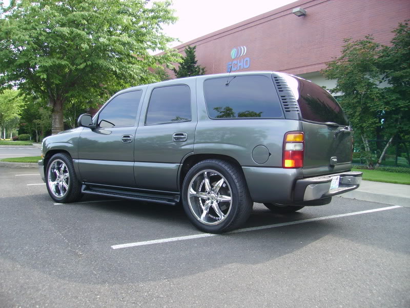

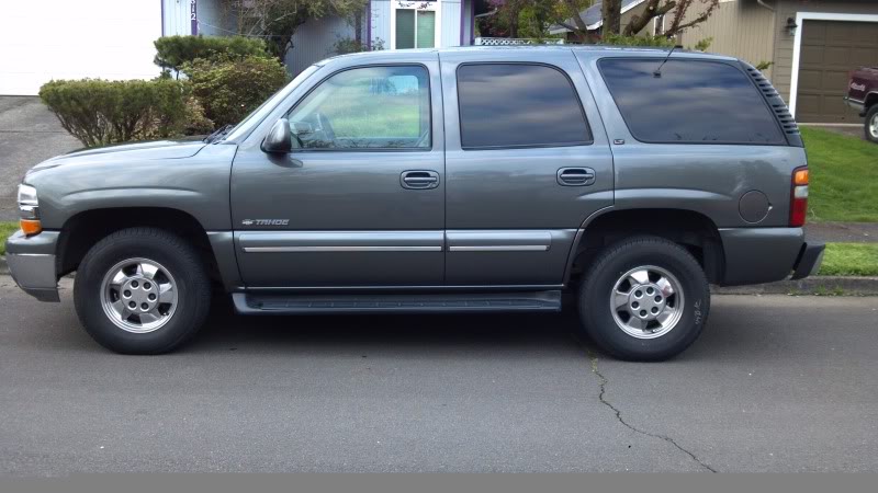

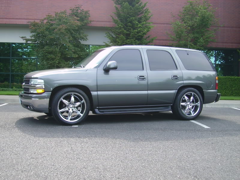

What's up guys. Finally got a chance to clean up the Tahoe yesterday and take some decent pics since lowering it last weekend. I'll start with some pics of how she looked back in March of this year and how it's progressed to be where it's at now. I'm not finished with it, but it's getting there. We all know how this modding thing goes.... it's never quite finished. :)
Drop Kit Consists Of:
3" DJM Arms
Belltech 5305 Rear Springs (uncut)
Free Travel Mod
Front Bilstein Shocks
Rear Belltech Nitro Shocks
Front Tires 305/40/22
Rear Tires 305/45/22 <-- Will change to 40's soon
Here it is basically all stock except I had already removed the roof rack.
Then we de-badged/de-molded everything and tinted the front windows.
Then added the 22" wheels.
And now some pics of how she looks with the 3/5 drop.

That looks very good Mike!! I actually like it with the meatier tire in the back too.
