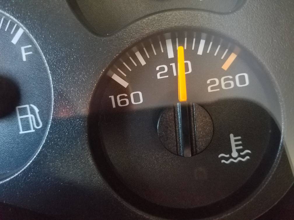

Yesterday while waiting in line to pick up my daughter from school I noticed my water temp was steadily climbing.
Now here in the gulf coast of Texas it's hotter than a Mexican plate lunch this time of year. I don't remember exactly how hot it got but it was well over the 210° mark. I tested again today and it climbed up over 210° while idling for about 15 minutes but cooled down when I started driving again.
I plan to change the tstat and see if that helps. Fluid levels were fine and the pump doesn't appear to be leaking. May be time to upgrade to the 05+ electric fans.

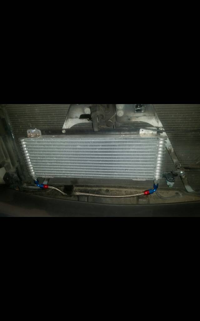

PS. Where is the temp probe for the exterior temp that is in the rear view mirror loacted. While I was testing it today that readout said 130°[emoji91]

If you are good on fluids I would check the thermostat. If it's opening once the engine warms up then look at the water pump. If you rev the engine and the Temps drop chance are your pump is bad. I'd replace it after 100k miles and consider it a wear item. You temp probe is right in front of the radiator so it's catching some heat from the radiator getting too hot.. . U can see mine to the right of the trans cooler.
