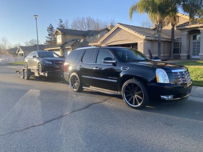

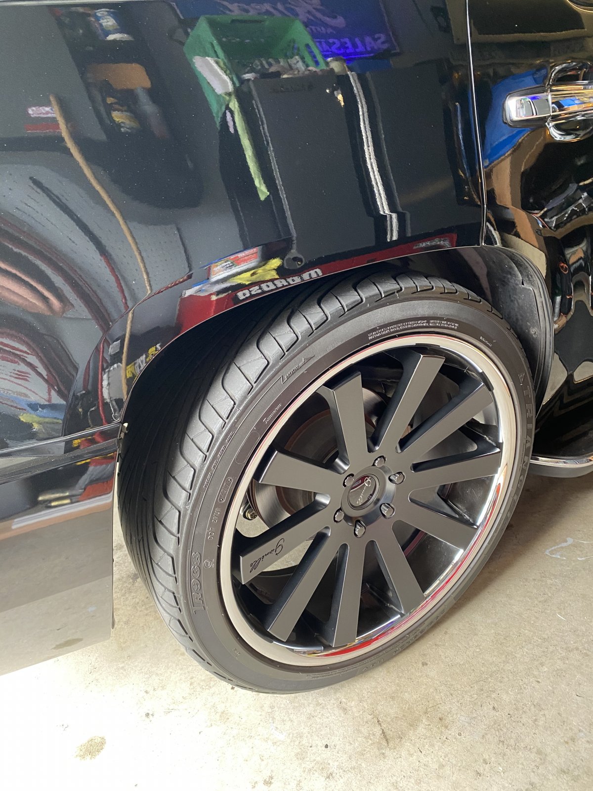

I’ve had the drop on the truck for about 6 months now! After a day or two of trimming fender wells and what not she don’t rub in the rear and the front rubs on good size dips Anyone who says they don’t rub at all with 24s and 30mm offset on 295s is lying lol
Installed the airlift helper bag bladders in the rear springs and they worked great for a full house of 8 people untill I hooked up my car trailer with a Chevy Cruze on it and 1 of the bags popped! I’m not to sure what happened but I don’t think I want to put the same ones back in and hope for different results ‍♂️.
kinda thinking of doing the auto level deal with shorter air shocks what’s everyone’s opinion on it and pics of towing while lowered?

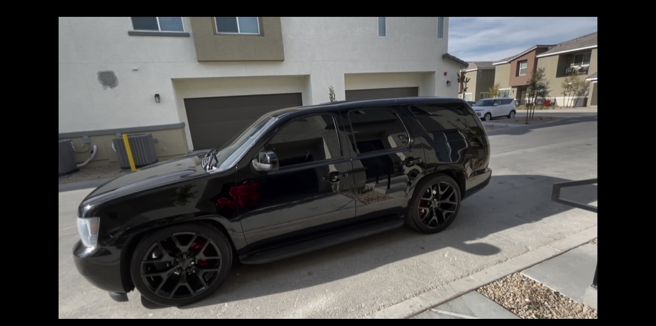

Mines lower than yours.
Running the 3/5 drop and i don’t rub in the back at all(no trimming)
the front is a different story, i rub like crazy when i turn

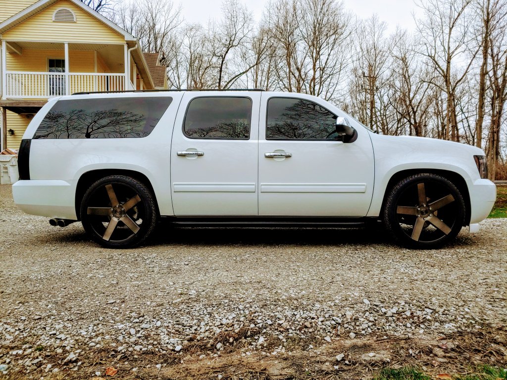

Tire width plays a big role in whether or not you have rubbing.
My 4/6 Burb had zero rubbing in the rear and only minor rubbing in the front running 285/40/22 tires on my 9.5" wide 30mm offset wheels.
Then I installed 305/40/22s and they rubbed everywhere, to the point that I ended up lifting the truck 2" all the way around to get rid of the rub.

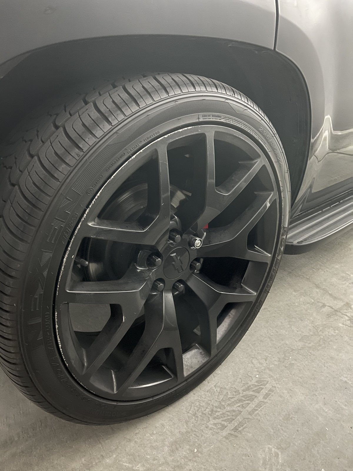

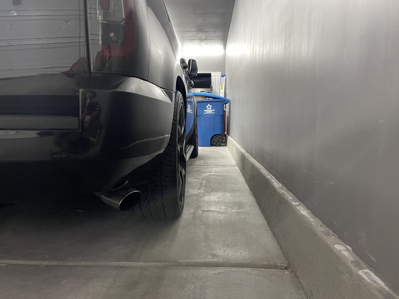

295/35/24 tires.
Belltech adjustable coils up front lowered all the way down to 3 inches
NorCal SS rear Belltech Springs that brings it down to 5 inches
no rub at all in the rear.

Well after looking at your pics I’m clearly lower than you and I only have 4” springs lol soooo ‍♂️

I’ll snap a photo tomorrow with a measuring tape. I don’t know what else to tell ya my guy. I know I don’t rub at all in the rear.
