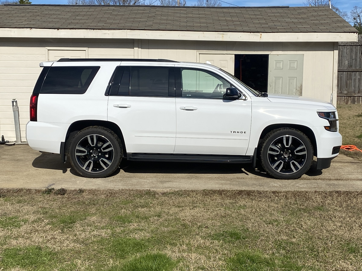

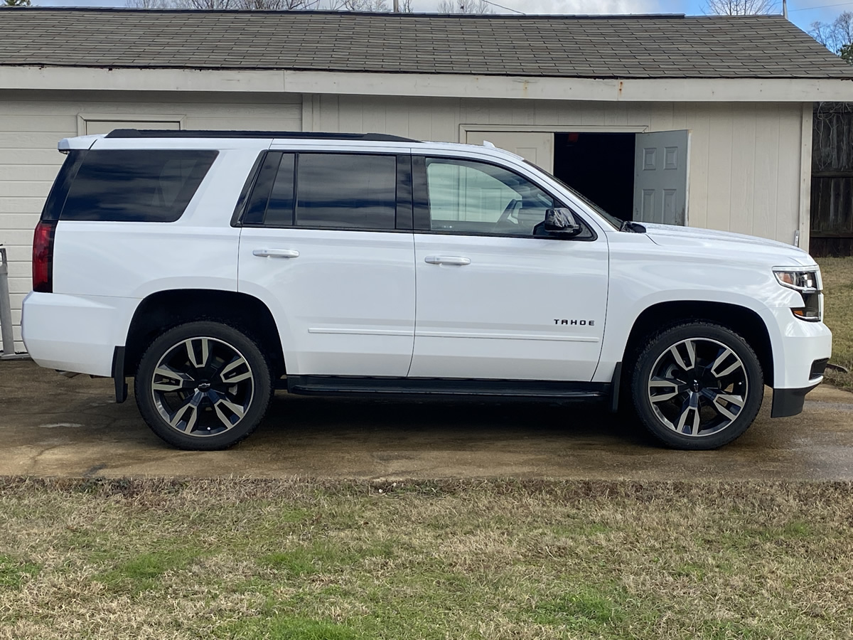

I did a beltech 2/3 drop. There is a video on doing the drop on youtube. I think I only found a 4/6 drop so there were things I didn't need to do. For me it was just replacing the knuckles and the rear springs.
I watched this video and saw that it's pretty straight forward.
I did the 2/3 and didn't do the cutting for the free travel mod part. Dunno about 2/4 or 3/4 cutting.
Before:
After:

I like the way that sits but looks like more then a 2/3 drop?

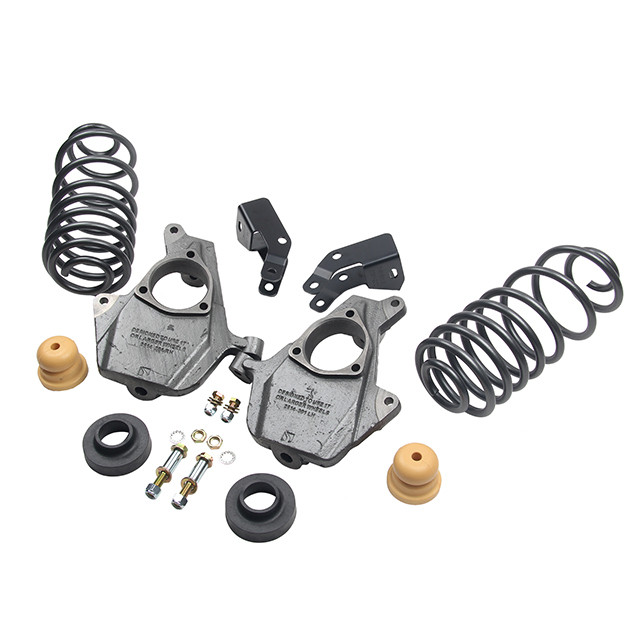

Belltech 1019 - 2014-2020 GM SUV 2WD/4WD 2" F/3-4" R
Says it's a 2 inch front and 3 or 4 inch rear. I used the spring spacers in the rear and kept it a 3 inch.
When I put a tape measure on the front it wasn't a full 2 inches. Closer to 1.75.
I'm happy with the way it sits and rides.
so you put those black spacers to make it 3”, and put in the new bump stops (I don’t want to have to do the free travel mod if at all possible) - were there any other things you have to mess with autoride in the rear? There’s a kit a little cheaper on eBay that is essentially a knock off of this one + autoride sensor rods.
Did your Belltech kit come with those as well? I like the final results of the way yours is sitting!
Cantrepeat
Nov 29, 2019
98
94
Sweet Home Alabama
Yes, adding the 1 inch space keeps it at a 3 inch drop and no need to cut anything. This was on my 2019 so I'm not 100% sure on your 07-13 models and you know the kit you need for them is a different part number.
My kit did come with shorter rods for the auto ride stuff.

Don't buy the Belltech kit. the rear springs are crap (way too soft) with the Auto/Mag ride shocks. The Belltech kit also lowers 1" more than advertised in the rear (with the spacer under the rear spring it is a 4" drop). The Belltech shock "extenders" are also worthless as they literally do not drop the shock down at all but rather just move it back so it is more vertical. I do like the Belltech kit comes with shorter bump stops which looks better than cutting the factory ones and comes with threaded rods for the rear ride height sensors which looks nicer than bending them. I've been through a ton of parts and my recommendation is to use MaxTrac 271240 4" springs and either McGaughy's or DJM's rear shock extenders (I have two sets of these for sale) because they will actually drop the shock down and keep it very close to the length it is a stock ride height. Then use 2" knuckles in the front. As long as your shocks and the rest of the suspension aren't worn out it will drive and, more importantly, ride fantastic.

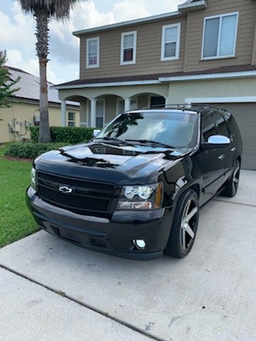

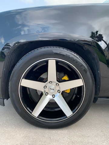

I have the same kit.
