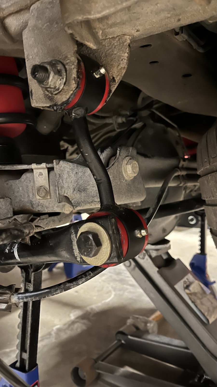

I just installed the Belltech 1019 with 2410FF shocks set at 2/4 drop to my 2016 Tahoe (non-mag ride). It rode good, but I noticed my swaybar was pointing down and control arms were angled upwards so I decided to add the DJM RK2007 (relocation kit and end links). I also added the 1” spacer to the rear since the rear was a touch lower than the front.
Now the rear of the Tahoe looks better since the sway bar is pretty close to parallel to the ground and the control arms are angled downwards. However the rear is super stiff. If I stand on the rear bumper and jump up and down it barely moves and I weigh 235lbs.
Has anyone ran into this issue? Parts list below

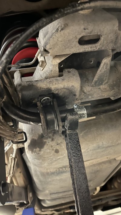

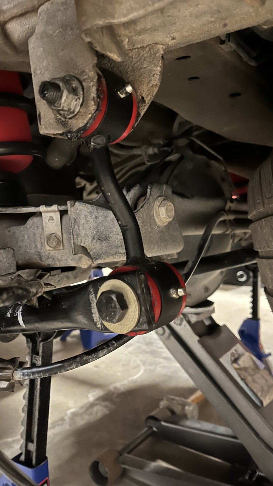

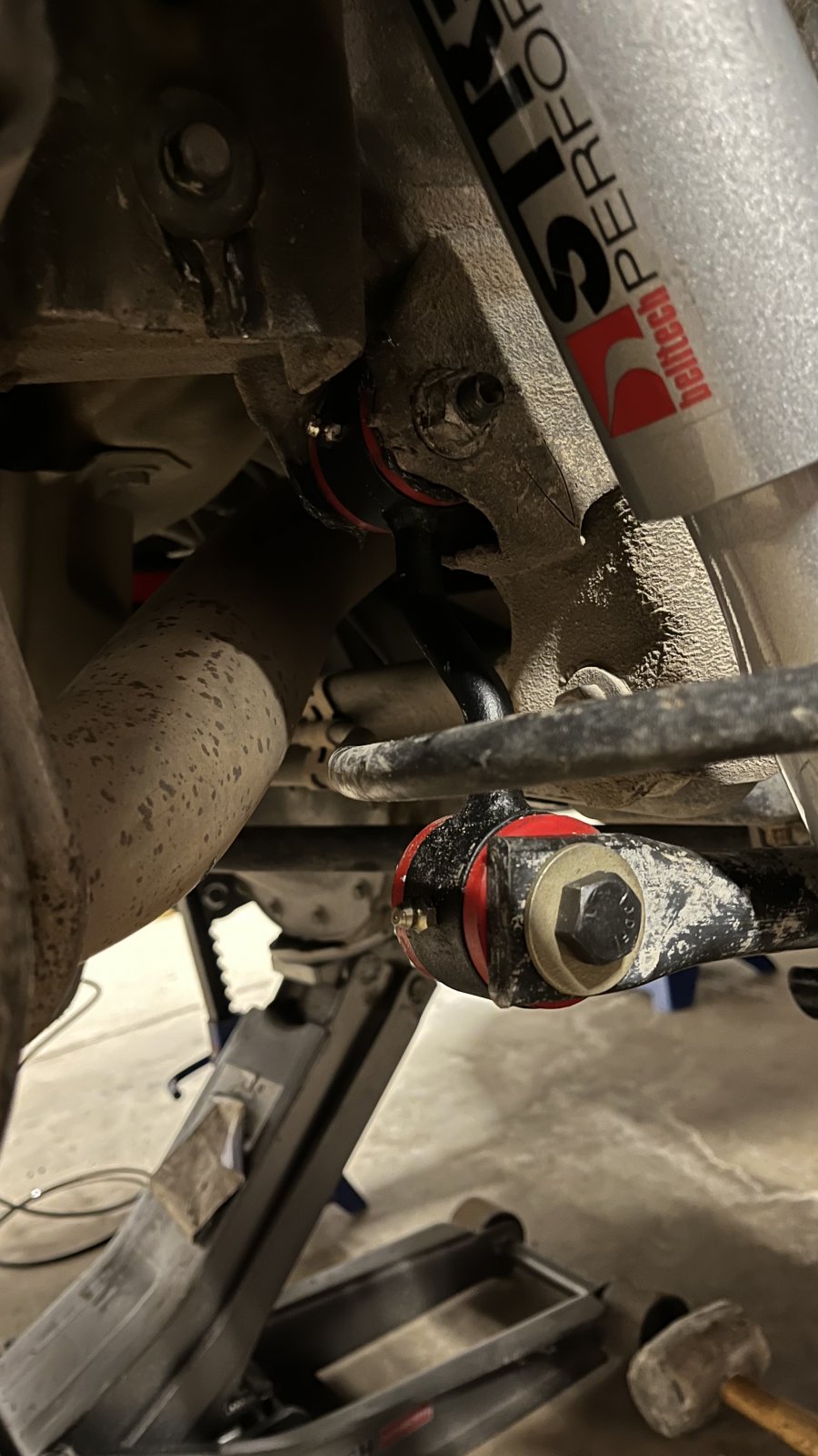

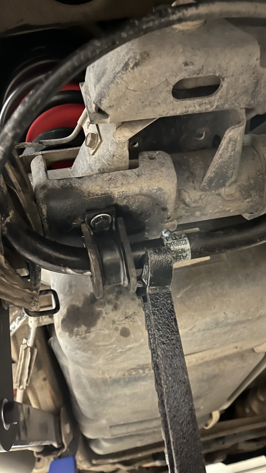

I'm installing the Belltech spindles with a 2/3 drop + Hellwig swaybars Friday on my 2018 Yukon Denali. I read swaybar positioning can be an issue. Have any pics you can post?
03mach281
03mach281
Oct 4, 2018
I will get some pics today. I don’t have any good ones right now. Here is all I currently have.

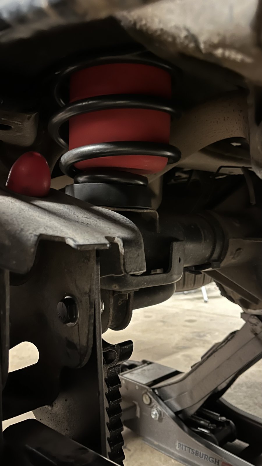

Take a picture of the bump stops, they maybe to close to the frame, you may need to do the free travel mod on the frame.
I cropped this from one of his pic. Bump stop does look close.
ivin74
05 NBS Nali
Aug 3, 2014
2,420
2,557
Htown, Texas
I think thats the problem, once you start driving the rear squats about 1/2". That's probably when the frame rest on the bump stop. To rule that out, remove the bump stops and take the suv around the block if the stiffness is gone, thats the problem. The fix would be the free travel mod or leave the bump stops off.

I didn't realize I never replied. The free travel mod was done when the lowering kit was installed. I have looked and nothing is hitting. I just seems like a spring rate issue because I unhooked the shocks and tried "jumping" on the rear bumper and still seems very stiff.
joe_joe
Apr 30, 2015
47
21
Pardon my ignorance, but what is the red cylinder looking thing inside the rear spring?
