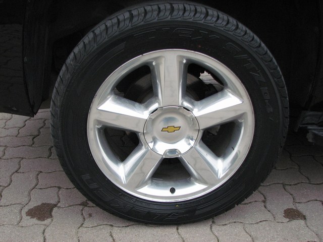

Wanted to note my observations in case anyone else is considering going wider on the stock 20x8.5 rim.
Was time to replace my stock 275/55-20 and wanted to go a bit wider w/o going to the expense of a full 20” or 22” rim and tire package.
Went with the Falken Ziex S/TZ04.

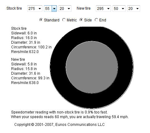

Screen cap below from the miata.net tire calc – new tire is 0.9% different diameter so ABS, acceleration, braking, odometer etc should all be relatively unaffected (I sure hope so anyway).
Thought about 305/50-20 and even though the 1010Tire calculator says you can safely put this tire on an 8.5” wide rim, from what I can see, I wouldn’t recommend it. I don’t see how the sidewalls wouldn’t be bubbling out and looking odd. Might even be unsafe. Anyway, I know some folks have done it, so to each his own.

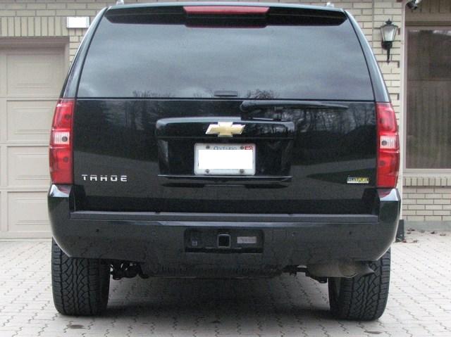

Driving impressions with the 295: definitely different. Handles differently and seems to follow road imperfections a bit more than before. Or maybe I just need to get used to it.
I do like the looks though.
