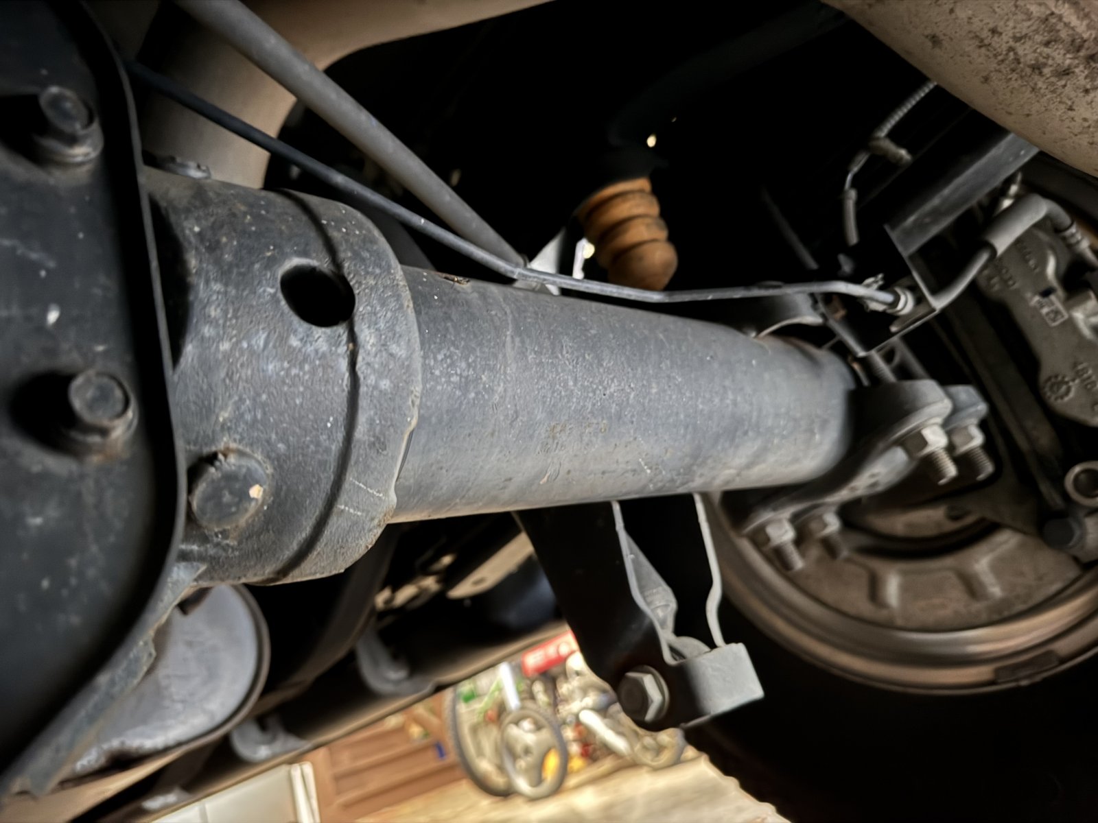

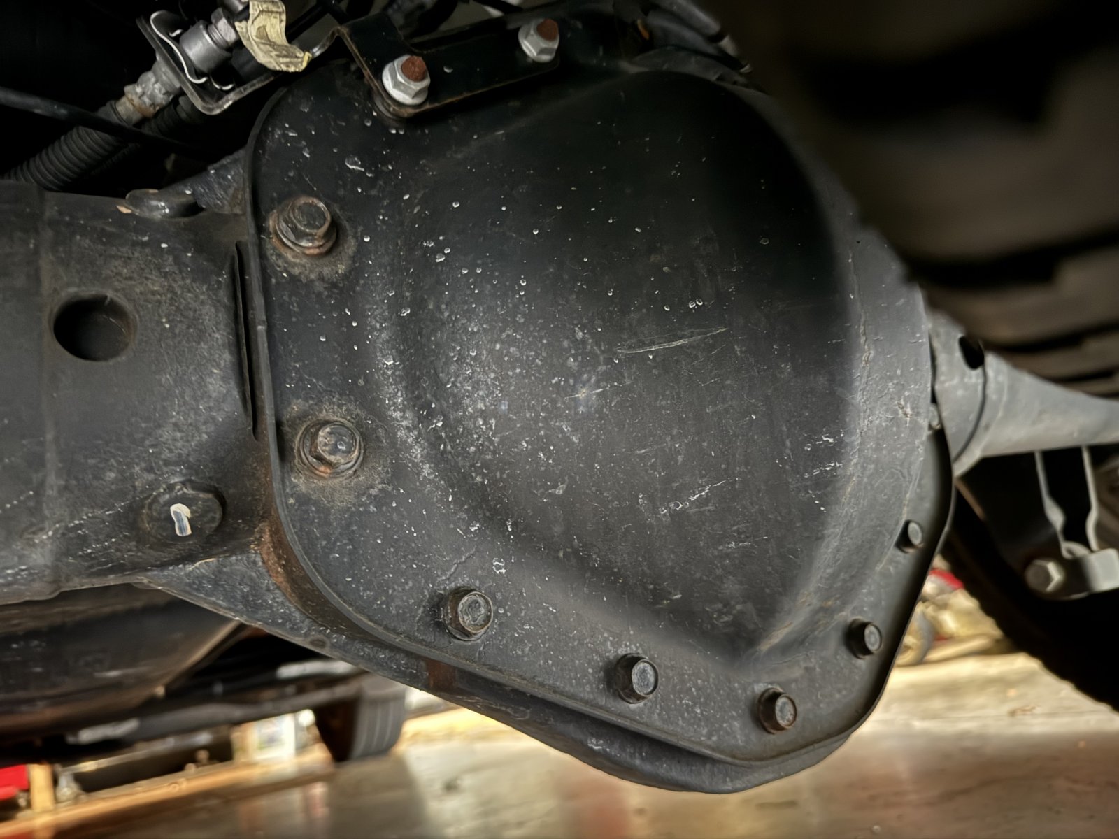

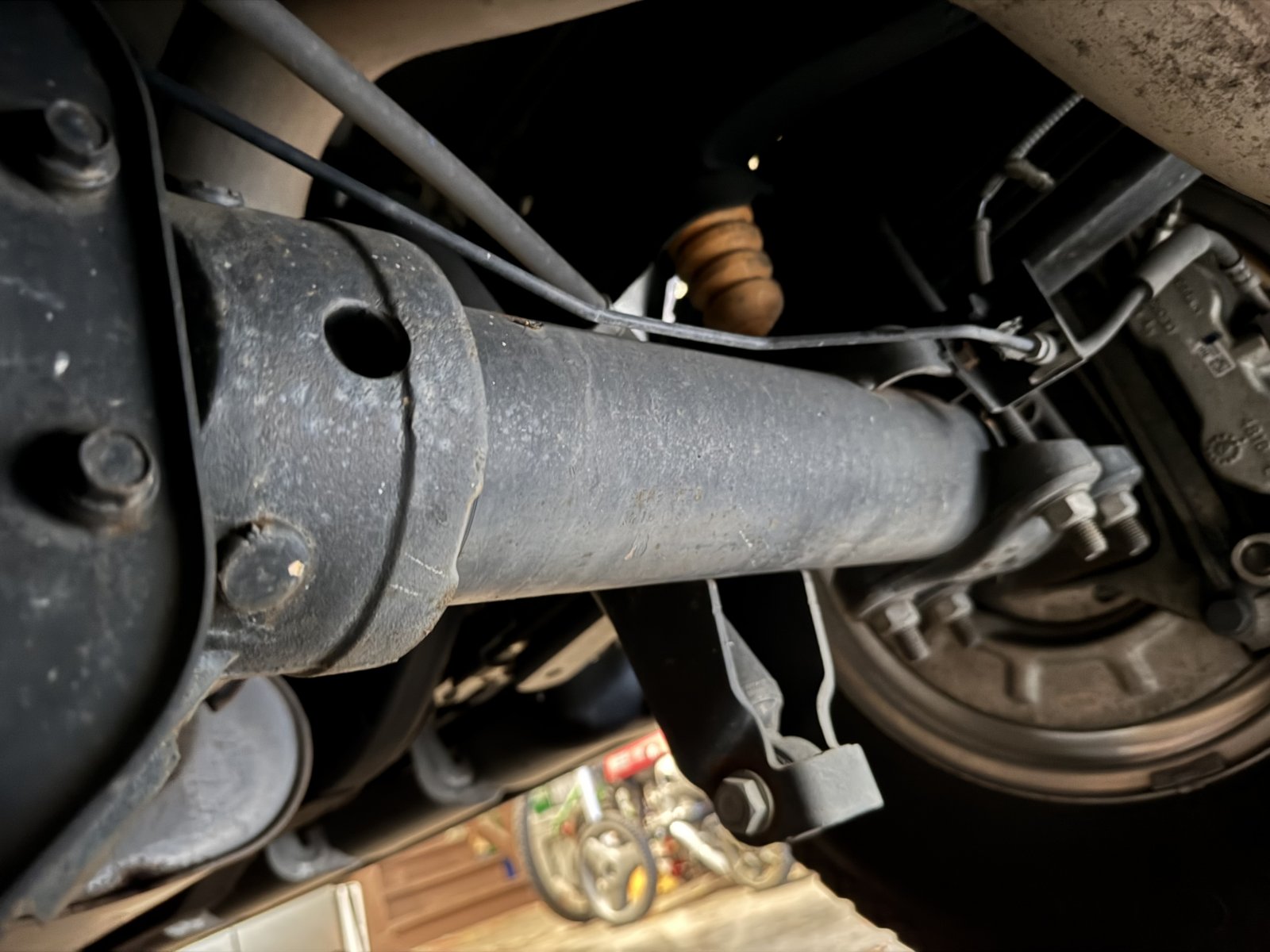

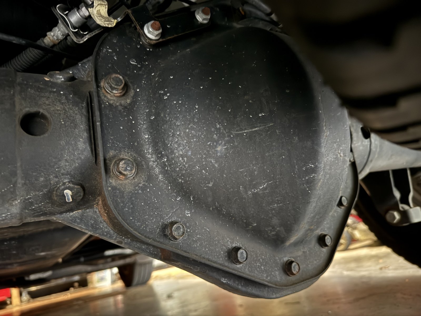

Did either model come with a 14 bolt? I could've sworn the early 07/08 models came with the 14 bolt. Can someone enlighten me please?
Geotrash
Dave
Feb 16, 2018
7,843
20,396
Richmond, VA
Lots of good info in this thread. I had no idea they made a Suburban 3500, which makes me want one even more.
Yup.
But with 4” axle tubes
Here you go!
