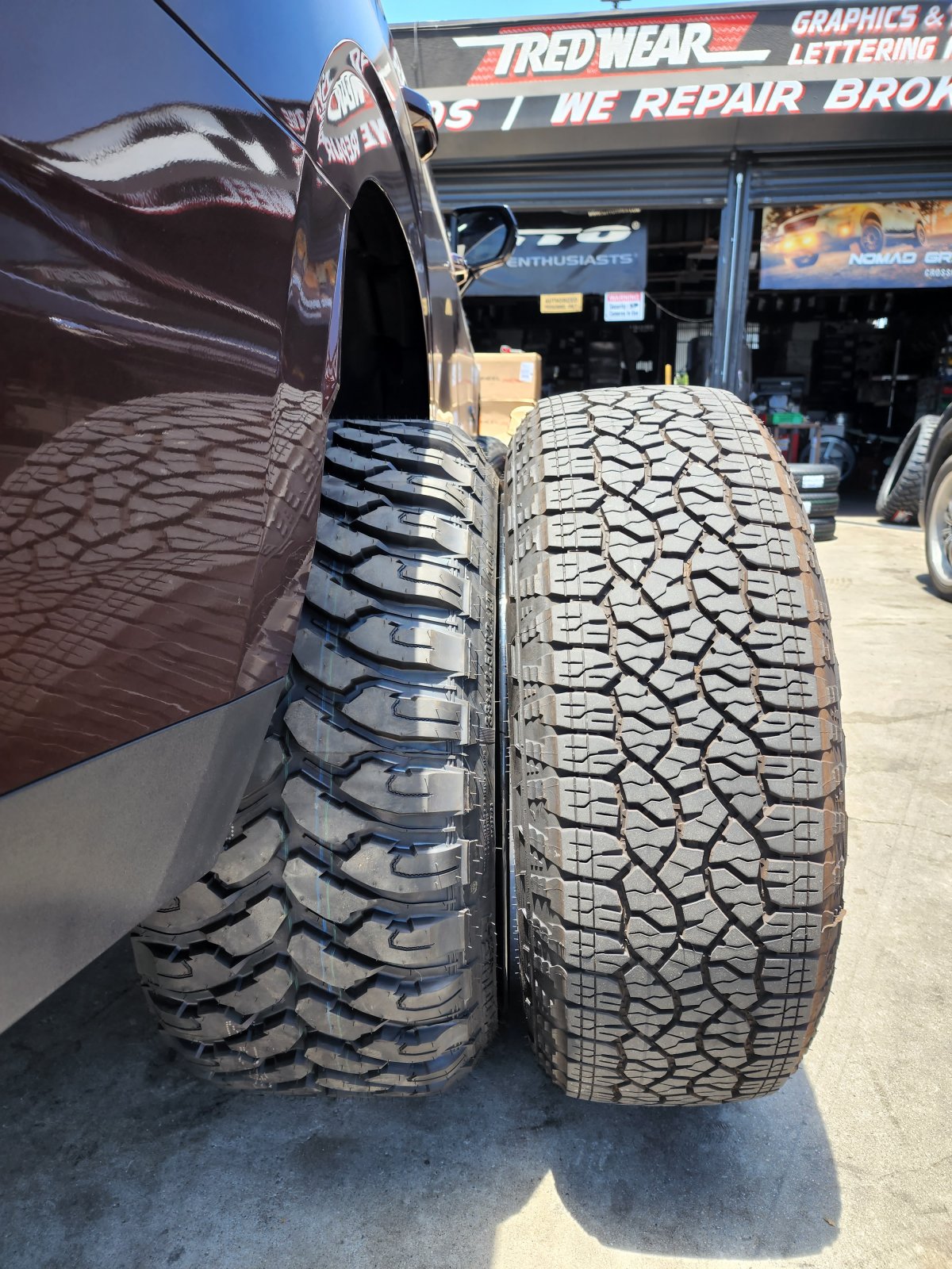

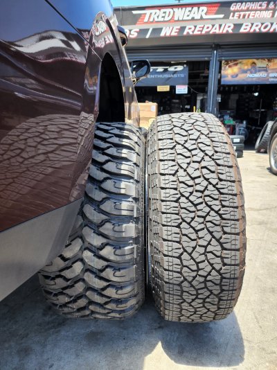

I'm referring to the stock height. The rim itself might be wider, but the tire width and tread pattern is narrower than the rim.

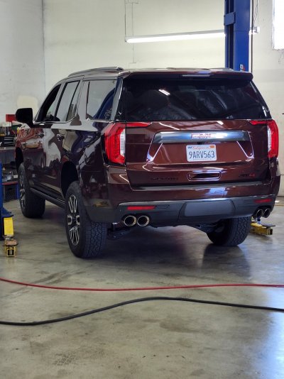

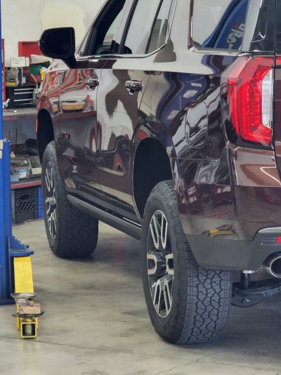

Having the 3" Ready Lift kit installed today at a local shop. This off-road shop also does NorCal mods (fender modifications) and cuts running boards too, so I'll have them do everything today so I can hopefully put the wheels on this week.
I can't promise pictures of the actual cutting (safety protocols in-shop), but I'll certainly provide whatever step-by-step pictures I can get.

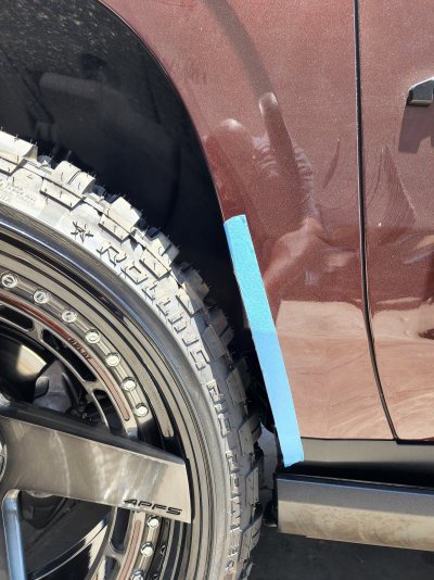

That's only a piece of the puzzle. I'd still need to cut the fenders.
More importantly right now is for me to see how far back I can cut into the structure underneath the fender liner. I haven't pulled the fender liner back to see how much metal there is I need to cut away, so that would be where I need to start at before I randomly start hacking away, and the inner/outer measurements end up being way off.

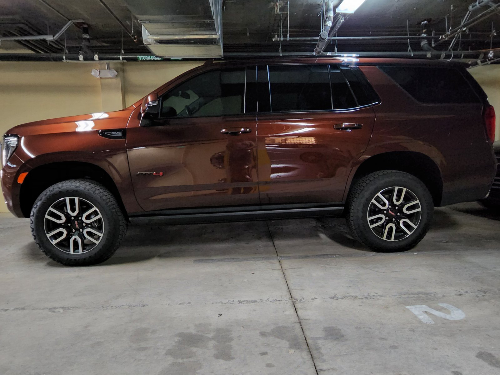

The lift turned out great. It'll take a little getting use to driving higher, but i guess i can't complain. The lower part of the body extends just above the widest part of the tire, so that's a plus for getting the wheel to turn a little bit more.

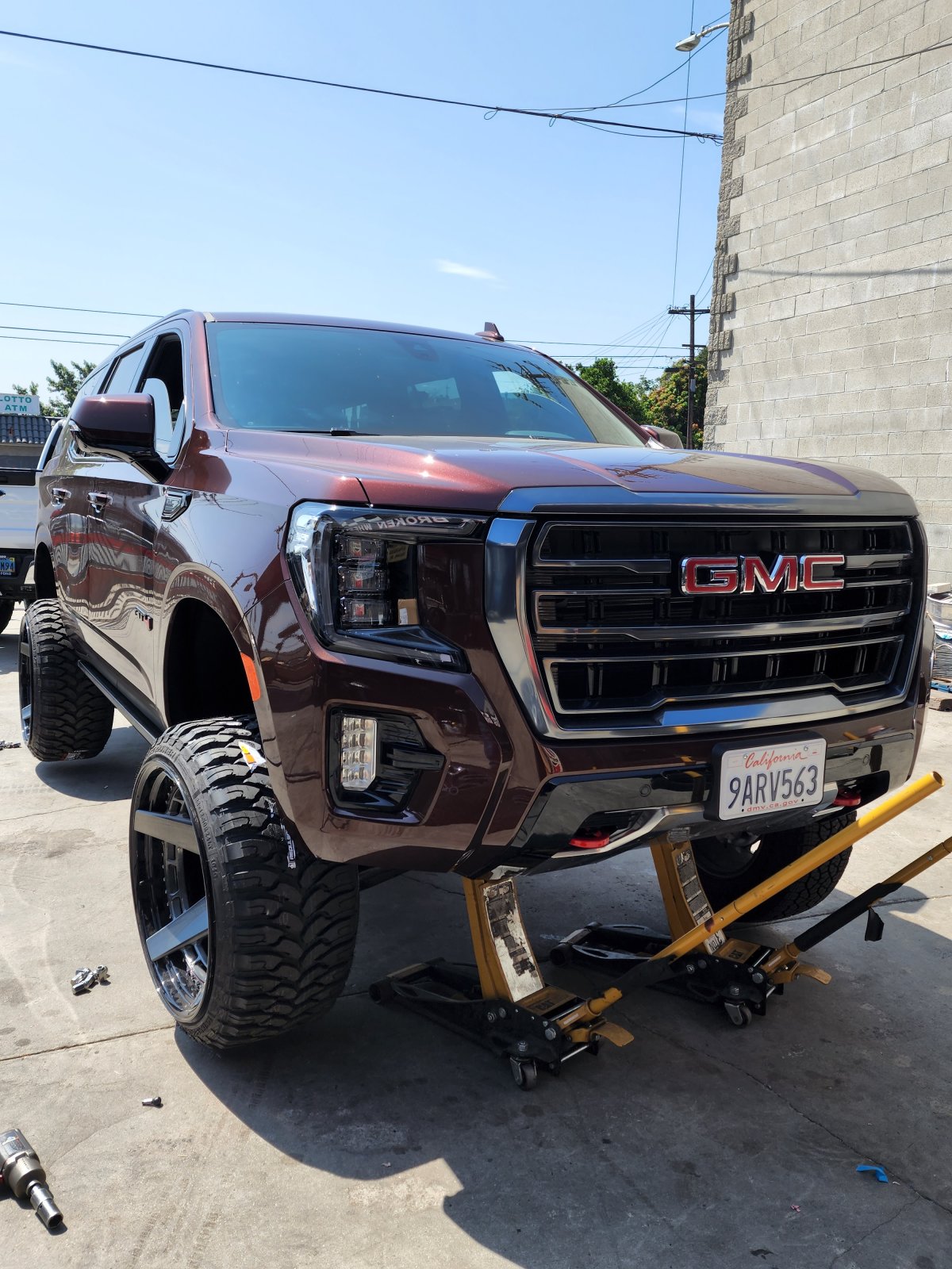

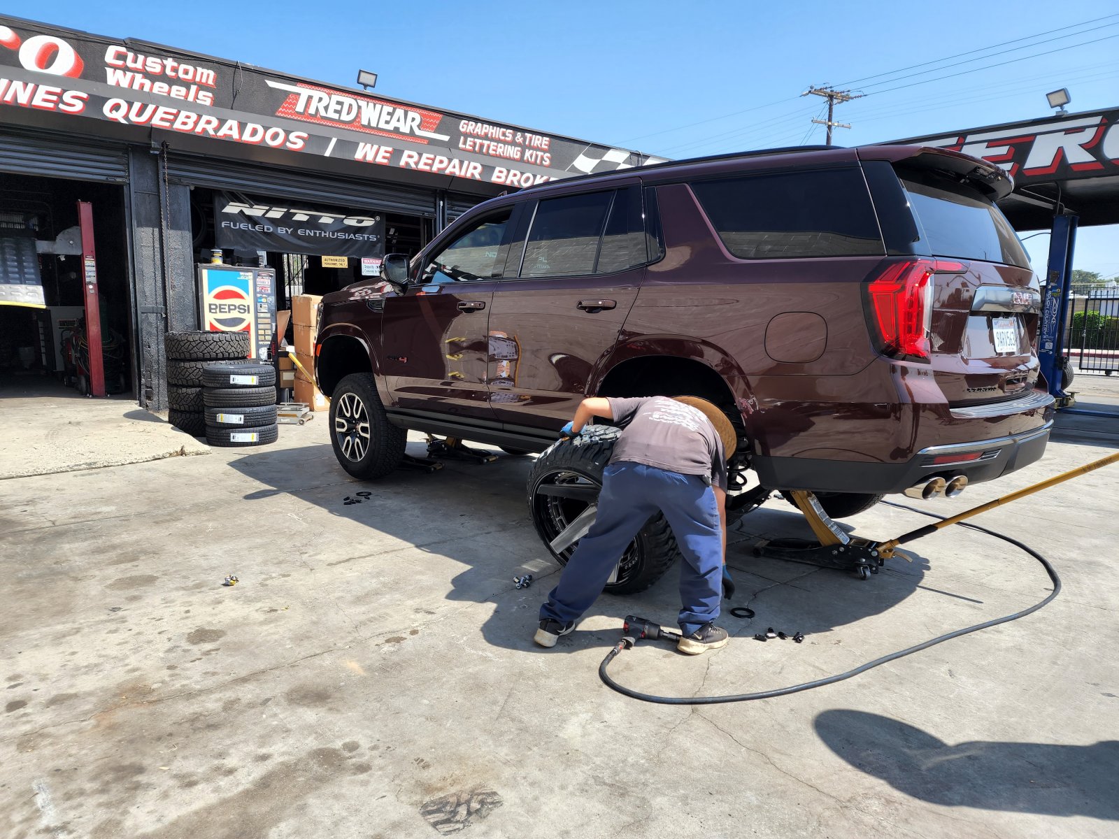

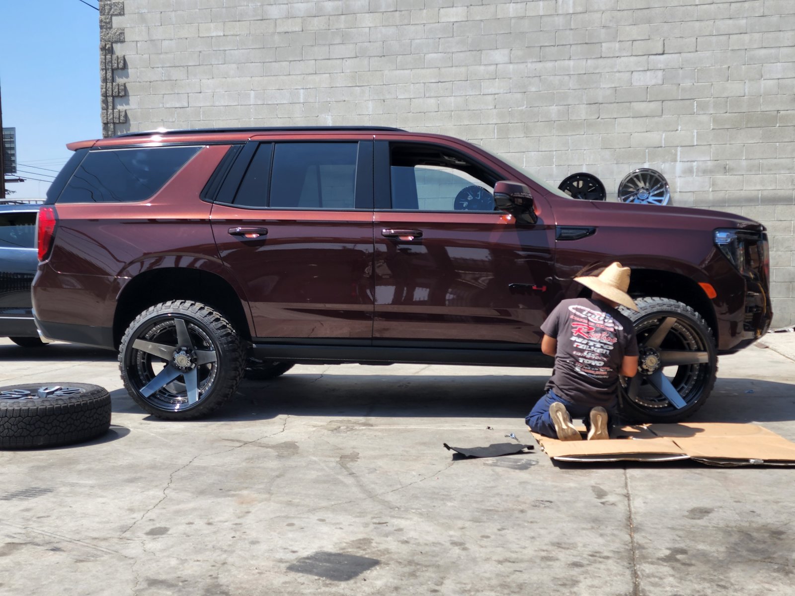

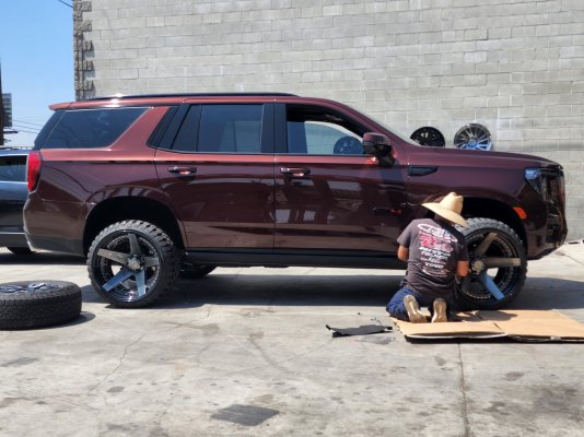

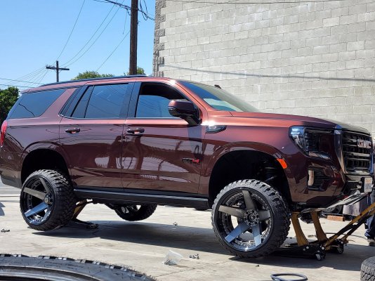

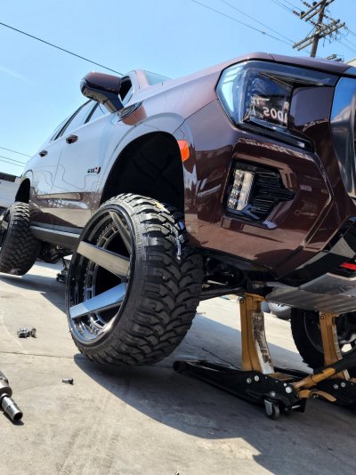

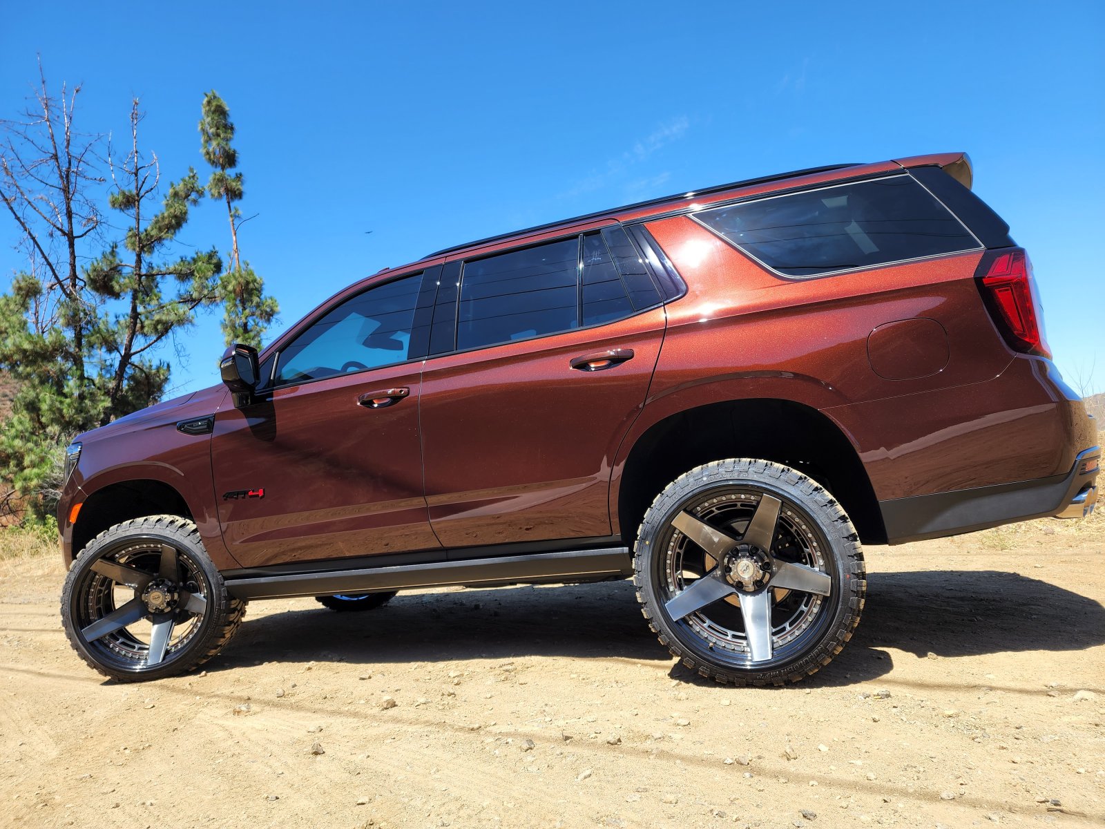

The wheels are officially on the AT4. I'd like to thank 4Play wheels, the lovers and haters, and everything and everyone that made this endeavor possible.
The cutting is currently being done, but there is very minimal impact on the body itself. That 3" lift made all the difference in the world. What they will have to do is trim the running boards about an inch and a half, and that's being very generous. The front wheel well only requires a minimal amount of cutting at the very bottom. The wheel does tuck inside the fender, but to be on the safe side and avoid any possible rubbing, I'm having them trim a little off that lower fender well, and a small amount of the felt liner.
Once it's all done and I make her all shiny, I'll post some glamor shots.
ProfeZZor X
ProfeZZor X
Jan 19, 2022
583
489
High Country

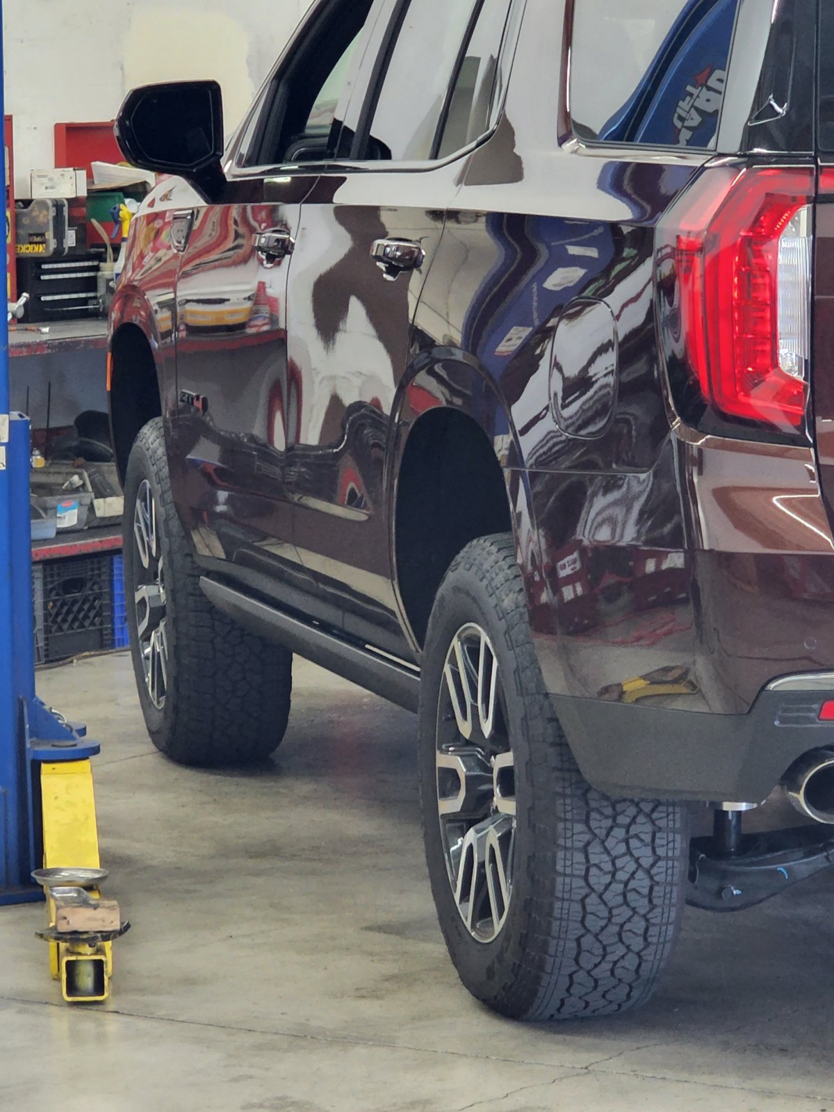

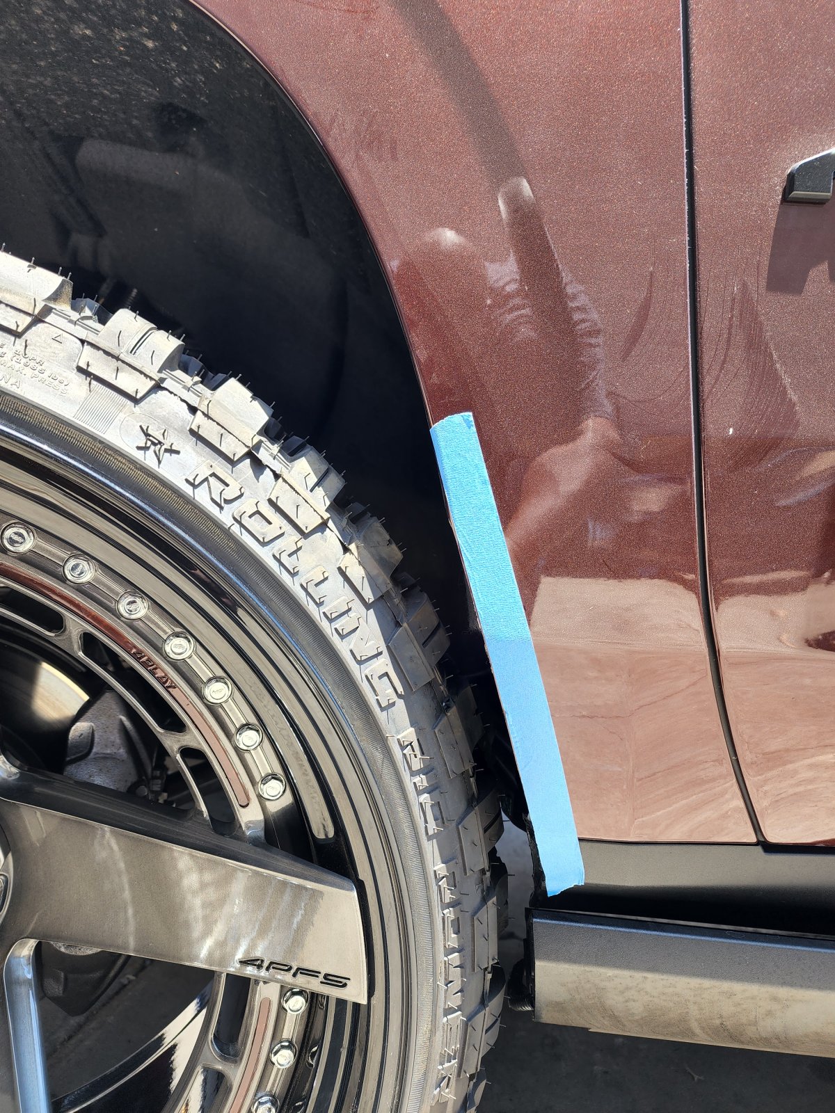

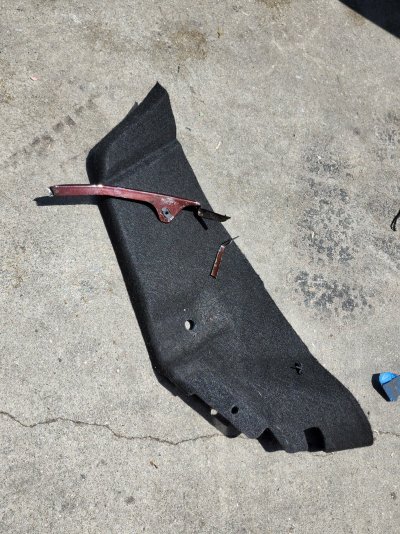

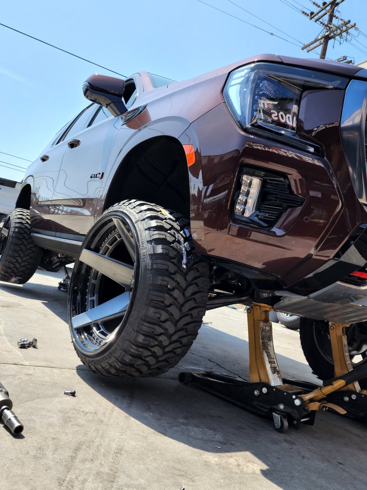

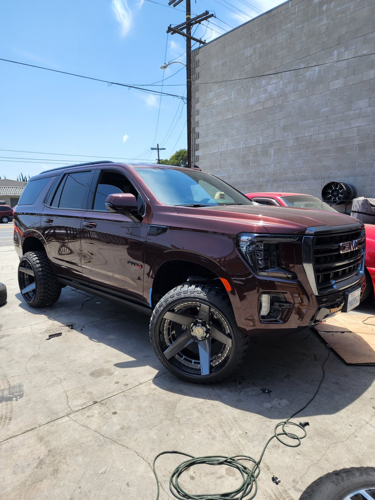

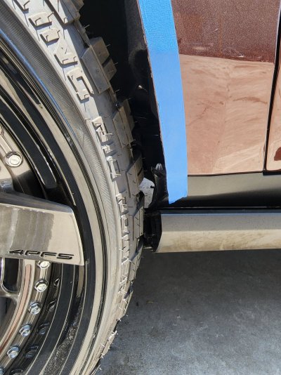

More pics from today's install. We ended up not cutting the running boards. Instead, we shifted them back an inch and a half and recapped them so it's flush with the new fender cut.
I know a few of you expressed your concerns over the amount of cutting involved, but seeing what the lift did for this project, I was confident the cutting would be minimal. The felt liners were cut, but I will zip tie them once I fine tune the areas that occasionally rub. The only rubbing I've had was going up or down at an awkward angle. I did experience some caliper clearing issues when I test drove it. By the time i returned back to the shop, there were metal shavings all over the wheels. Part of the spokes were grinding on the calipers, so they added a 1/8th inch spacer. The spacer is thin enough not to make a huge difference in the existing cutting we've done.
In all it does have a more aggressive look than anything out there, but that's not what I was going for. Like most off-road enthusiasts, I wanted my AT4 to reflect my lifestyle and likes. It may not be everyone's cup of tea, but I'm the one that admires and drives it at the end of the day, so that's really all that matters.
Thanks again for your positive and negative feedback, your subscription to this thread, and overall support.

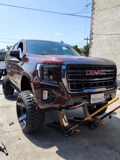

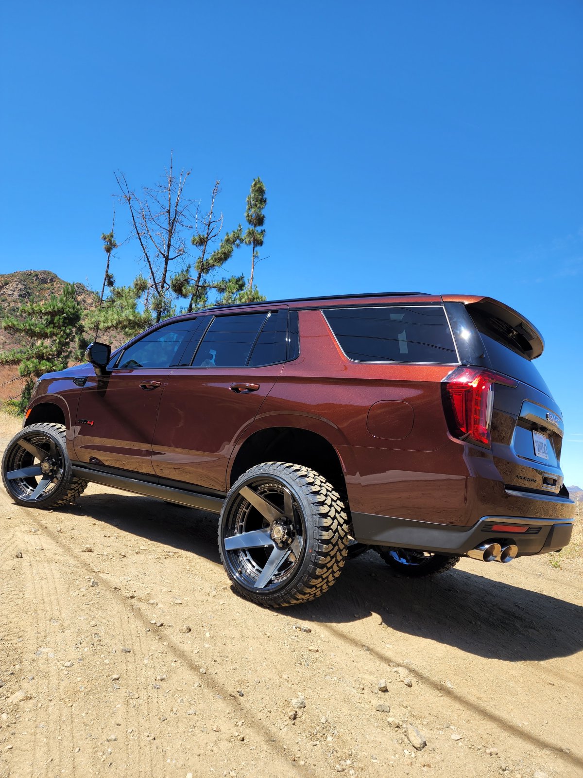

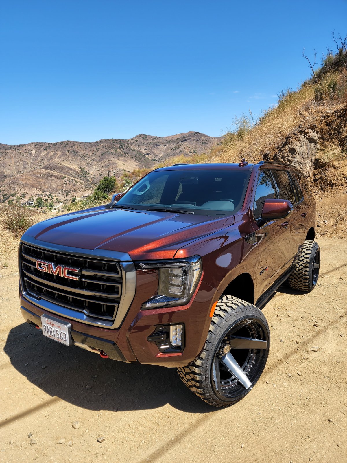

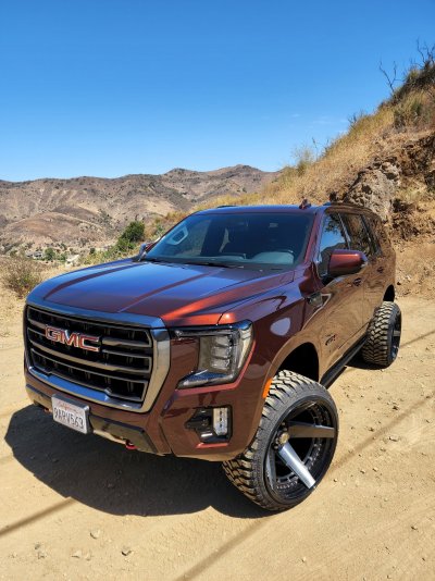

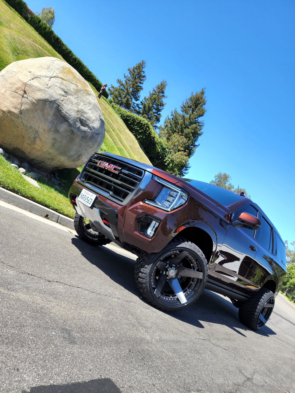

Glam shots..
