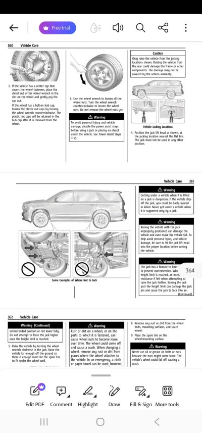

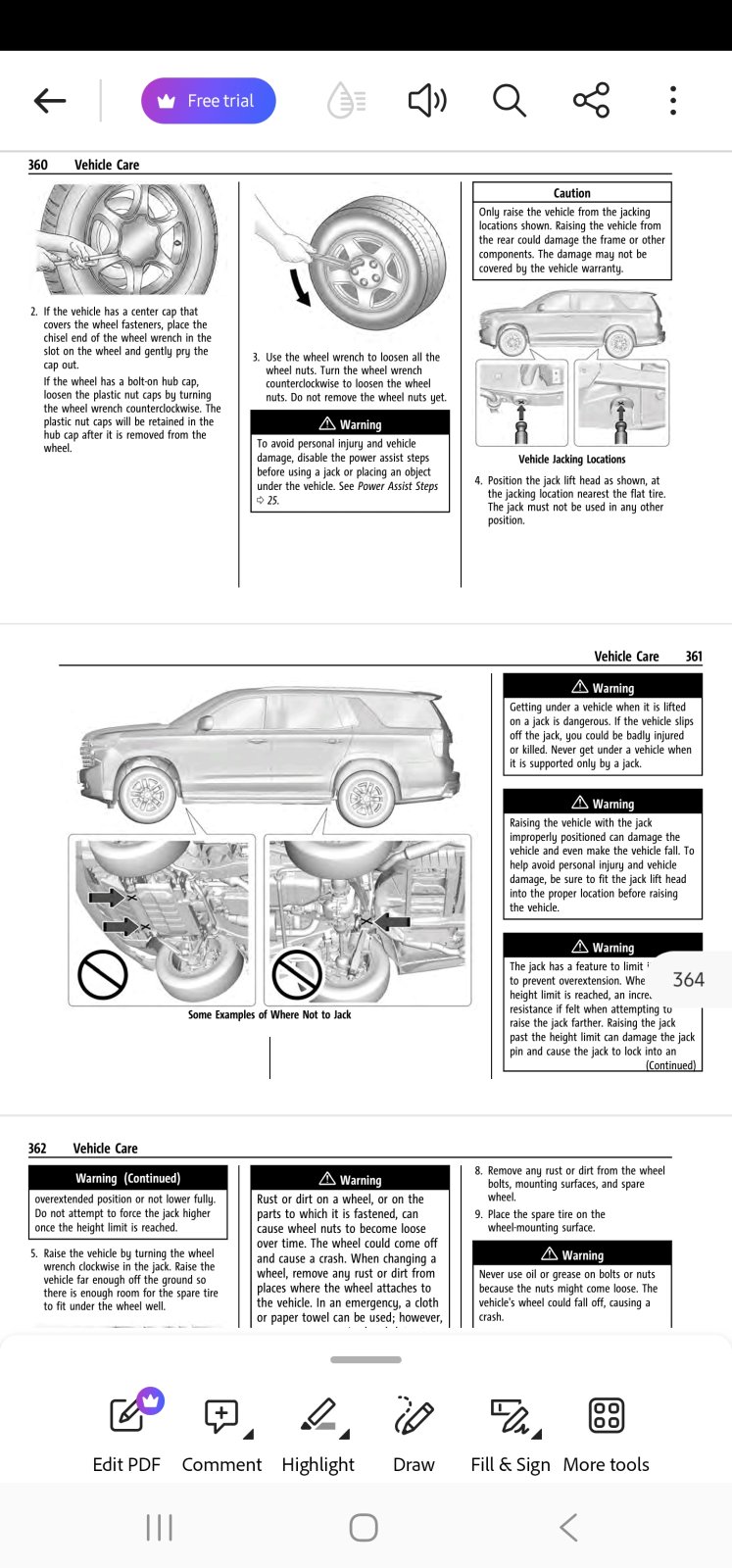

So at the risk of sounding argumentative, is it that critical. This is a nearly 6000 pound vehicle and I wouldnt want that landing on me. The owners manual doesnt give any guidance on where to place jack stands (Which I have never seen until owning this vehicle, every other vehicle manual has given guidance) it is like GM believed that only soccer moms and dads would buy this vehicle and never do any work on their own...if anyone has any pictures of where to properly support the 21+ yukon with jack stands it would be greatly appreciated...personally at this point only spiral jacks seem to be a safe bet otherwise

Just to follow up on this GM tech support did reply back to an inquiry, she said that jack stands either on the jack point or on the frame is acceptable bit no where else...thankfully the frame isnt hard to find lol...best thing is to use a bottle jack and then use jack stands on the frame I will try to post pictures next time I change my tires
