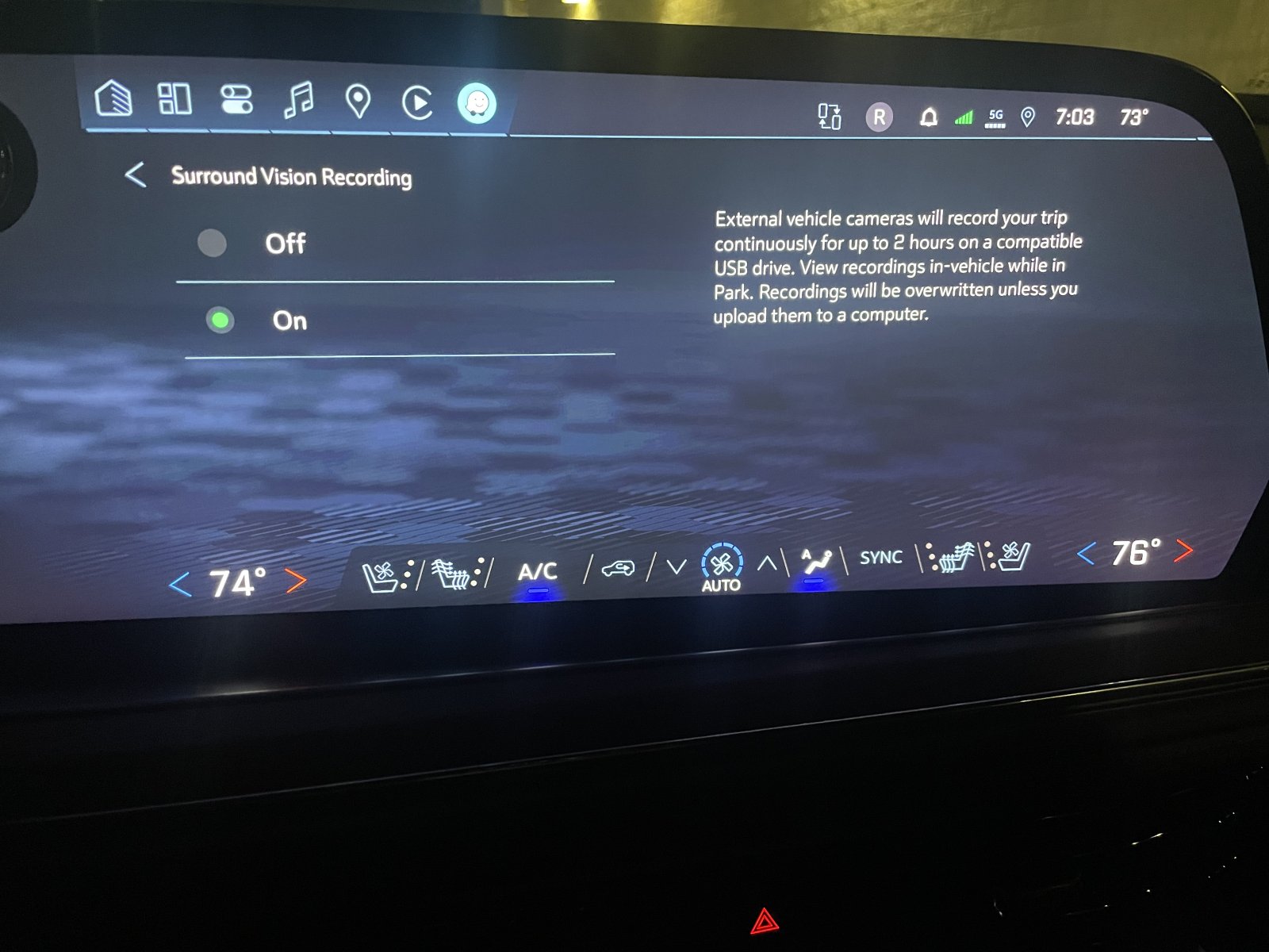

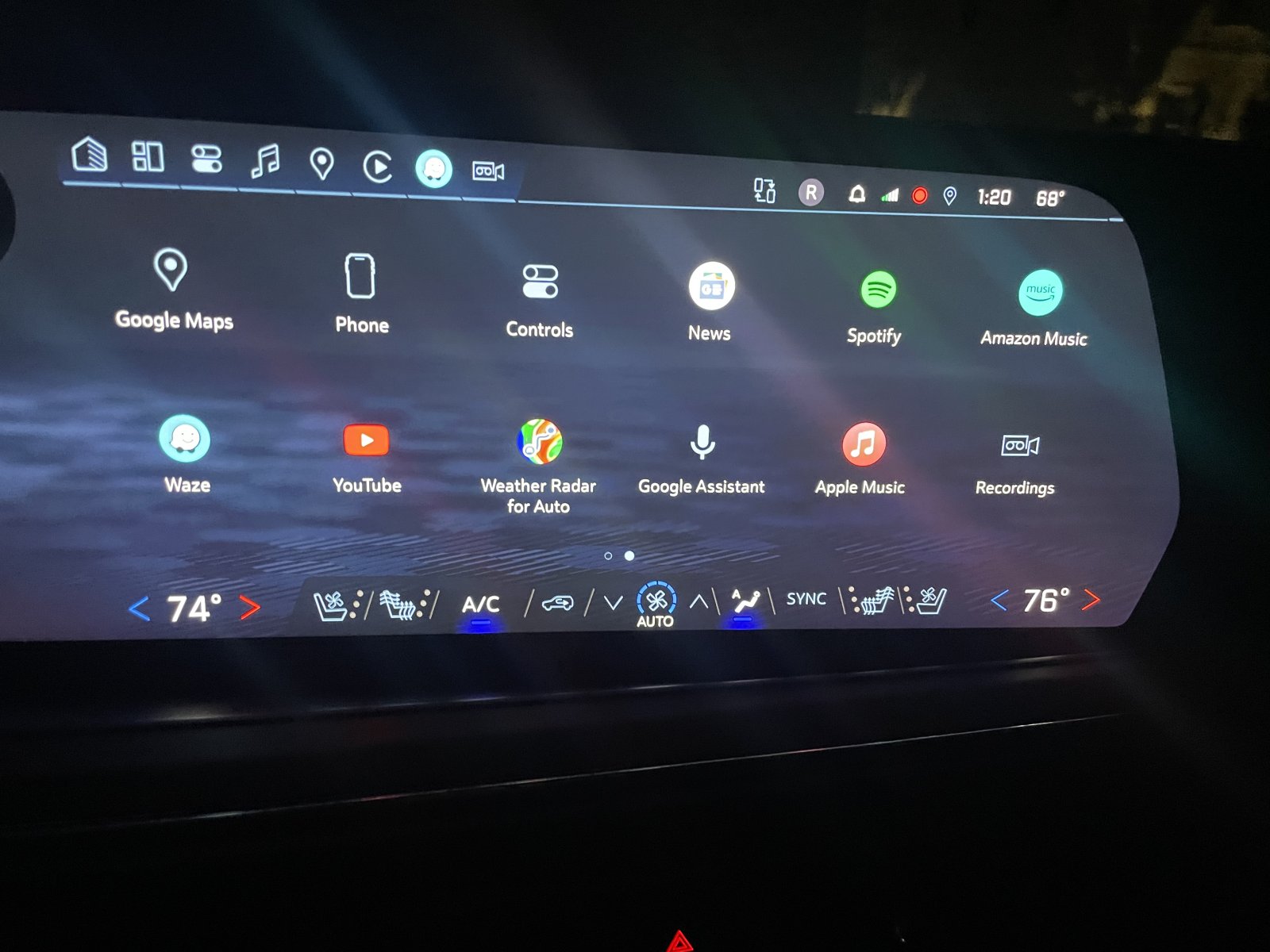

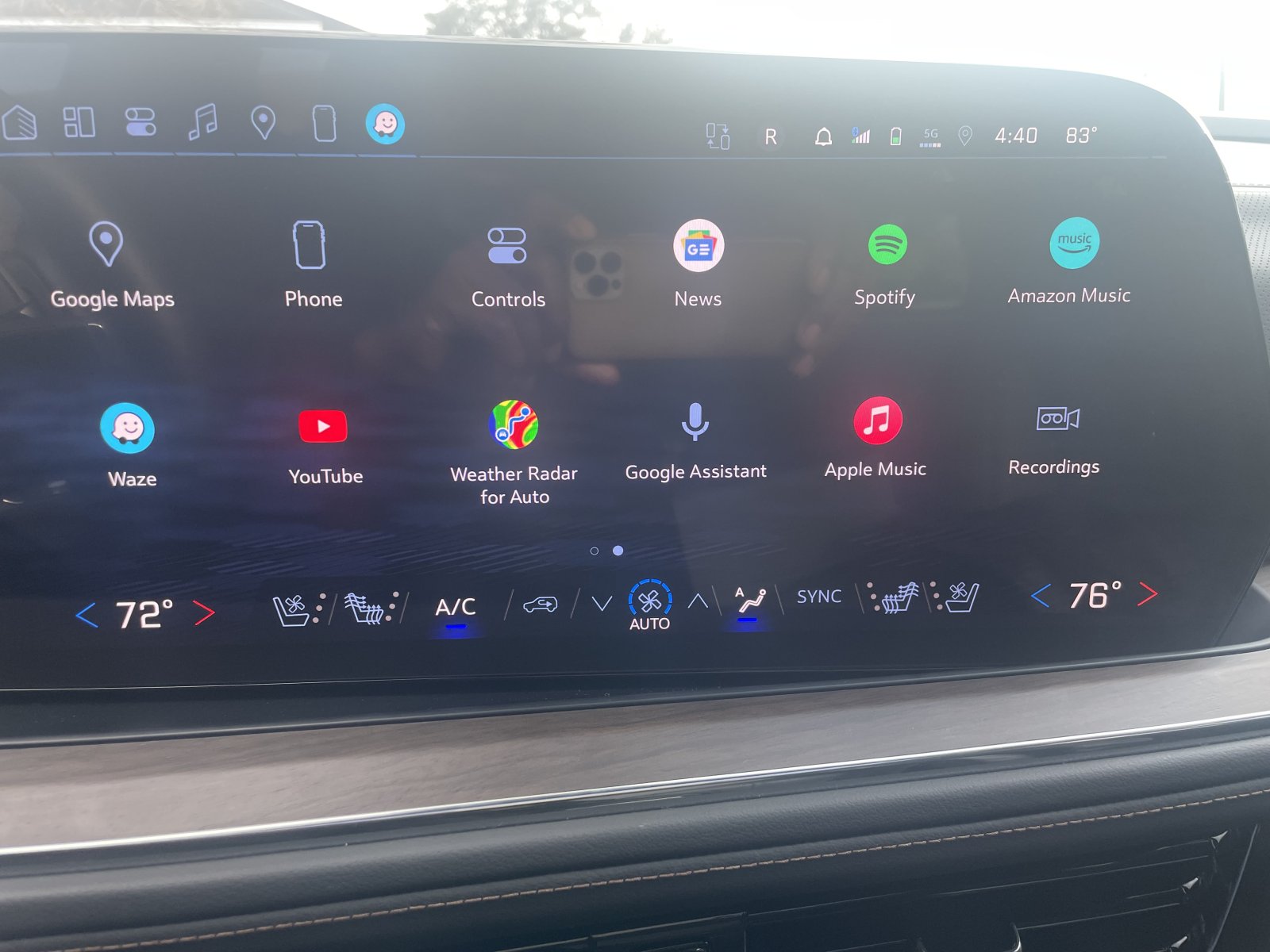

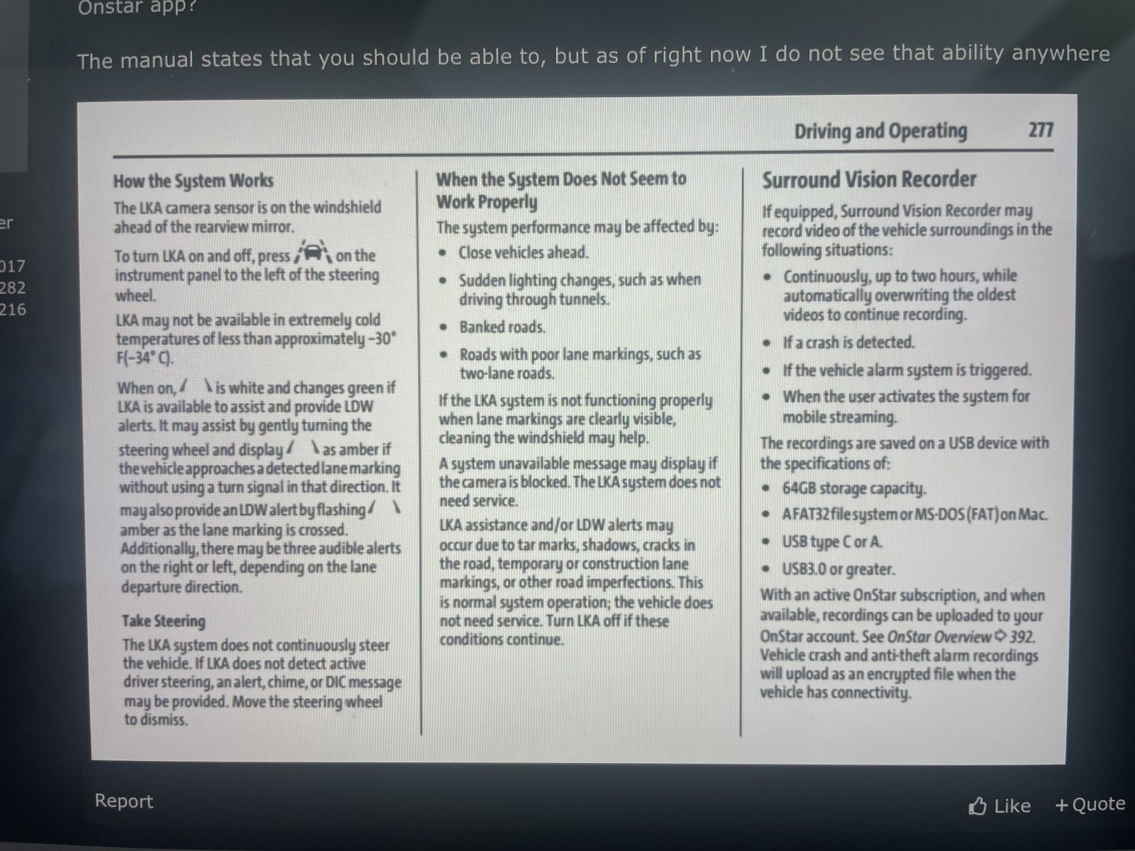

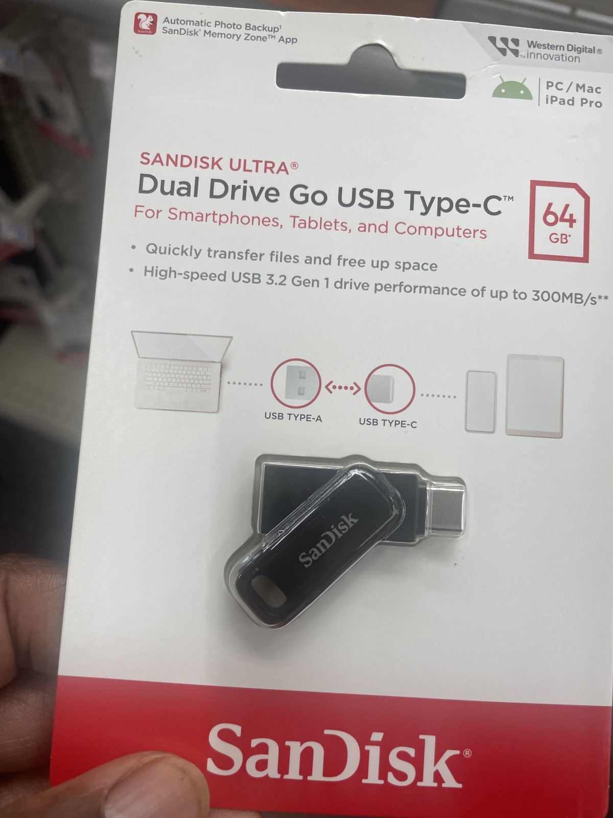

I just got my ‘25 High Country’s surround vision recorder to work after getting my android automotive version 14 installed by my dealer because my old version 12 from the factory didn’t allow it to be opened or operated but the app was in the system.
Thanks to everyone that helped myself and countless other fellow ‘25 & ‘26 Tahoe/Yukon owners get what was promised by GM to fruition.
I formatted my USB 3.2 256 gb dual drive (C & A) on my iPad last night and played around with the new recordings to make sure I had it right. The owners manual says it will record up to 2 hours before starting over but I think that will depend on how much storage space you have on your USB and it will make separate files each time the car is stopped and shutdown, I hope this helps.
A red dot at the top right corner of the screen indicates that the camera is recording but it will not record if you open the recording camera icon up while driving.
