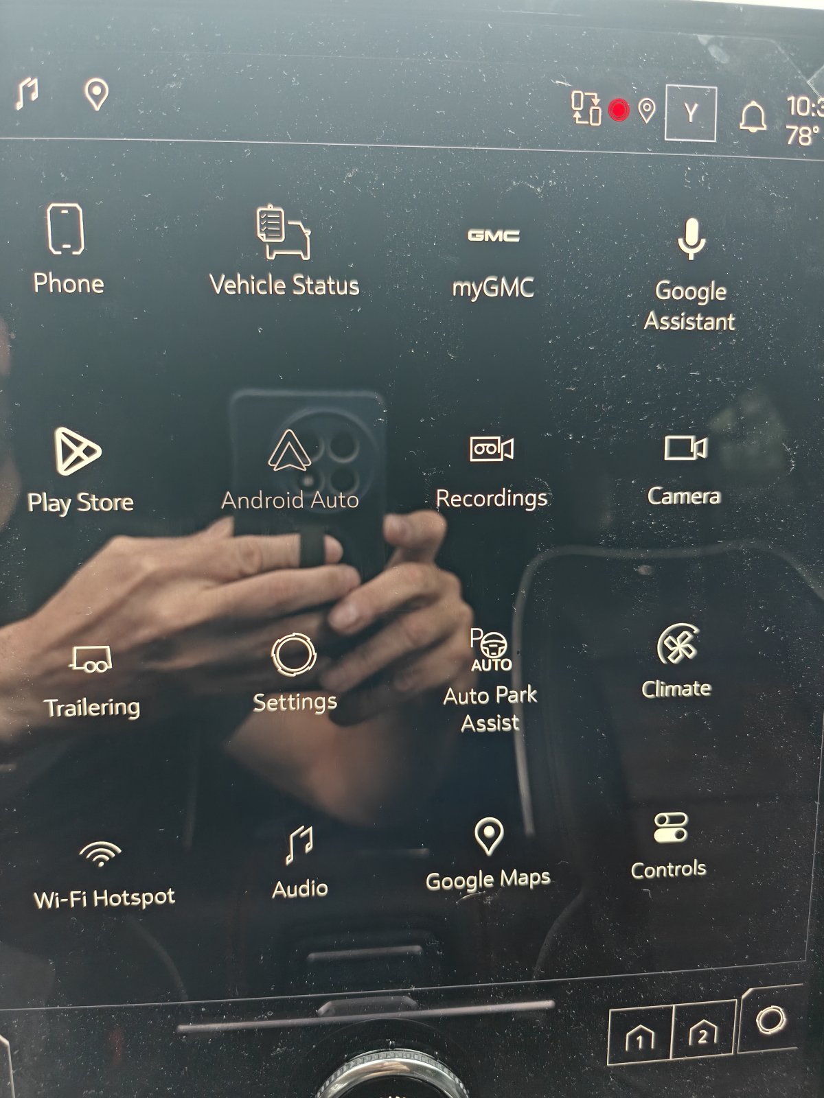

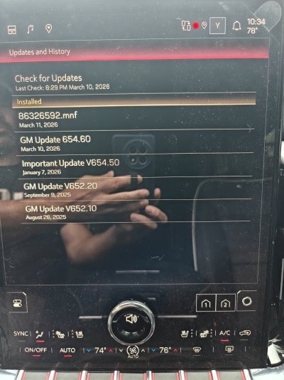

Surround Vision Recorder for 2025.
So I know many people have asked for the information which wasn't clear on many post. If your 2025 vehicle has the Surround Vision HD package you qualify for the Surround Vision Recorder update.

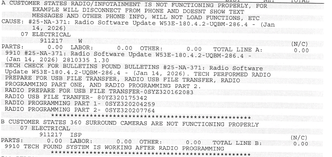

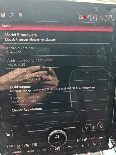

The actual update in the GM computer is
W53E-180.4.2-UQBM-286.4, which is listed on service bulletin 25-NA-371. I know there are many posts on this that say to have them update you to 86326592.mdf, but the dealer can't look up this number. It's by the software build version...the W53E number. I listed pictures of all my screen on my 25 AT4U.
You may have to tell your dealer that there are issues with the infotainment to get it covered under warranty.
For me, it was easy...I took the most recent OTA update 654.60 in the Yukon, and it broke my text messaging, my screen boot time, and put my Bluetooth into a disconnect/reconnect boot loop. Tell your dealer you have connection issues with your system.
This update brings your infotainment to Android 14 and has the SVR app pre-installed. No other update needed.
Android 14 is clean, smooth and every single issue is corrected for all the other OTA updates.
As you can see from the service ticket. This is NOT an OTA or GM computer update. The tech must download the software from SPS on a USB and transfer it to your car. The whole process takes about 6 hours. Hope this helps.

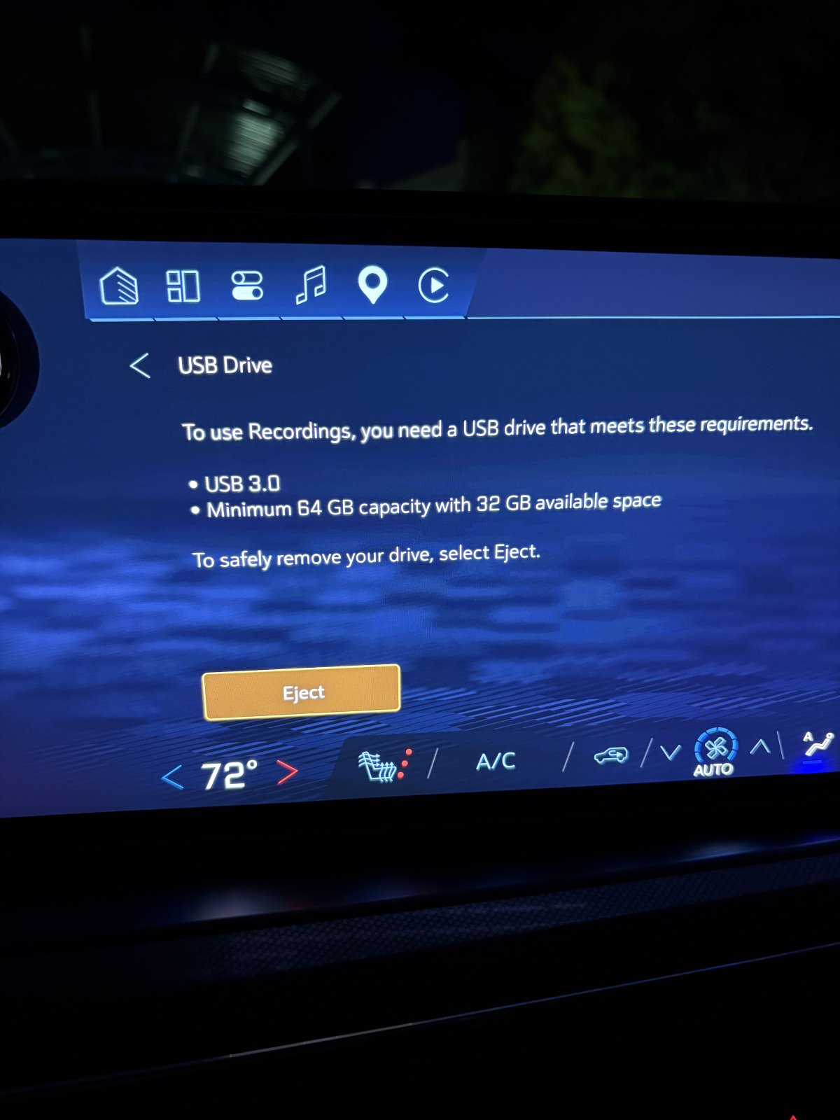

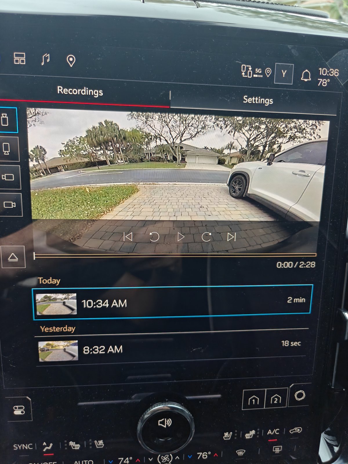

I was running a 1T Harddrive on a 2026 Tahoe To capture all the dashcams for about 3 week. I notice in my screen in the truck I can only review maybe the past day or 2 at most of video.
I hooked the hard drive into my laptop and see that there is only maybe 30gigs of video; it’s not filling up the 1TB?
Anyone else has this “issue” or is it normal?
Can you guys review weeks of video on your truck screen and on your Hard drive??
I also am not sure if the drive was a usb 3.0 device (could be 2.0) so I ordered a 3.0 drive today(256gb). Maybe that will help.
This is what the truck says about the drive:
Im
Thinking the truck only captures 32g of video and then writes over it….. but again not sure.
Im
Im pretty sure the system is smart enough to record whatever the drive has room for. Mine has more then 32GB of video stored.
ReaperHWK
Oct 14, 2020
990
1,229
I guess mine isn’t. Mine starts recoding over video after 32g.
Let us know if you can get over 100g.
I have a 256GB drive plugged in, but you might be correct, I'm going to confirm today.
