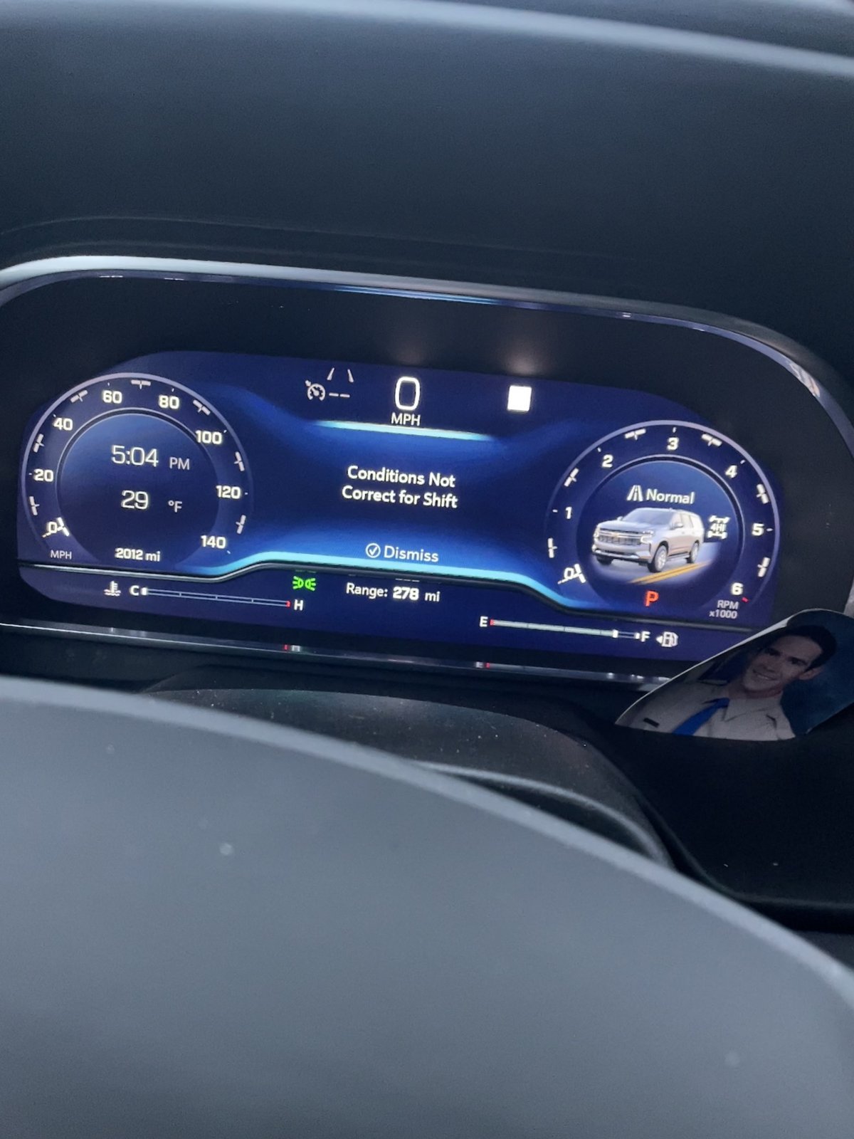

This exact thing happened to me yesterday. We were with our baby and toddler on the top of a mountain in the snow. ONSTAR was useless and after an hour told us they couldn’t find someone to help us. It took us hours to get help. Finally had a friend make it up to us to disconnect the battery and reconnect it and that worked.
I’m wondering now that it’s “working” do I take it to the dealership still? Is there a fix for it so this doesn’t happen again?
I put a picture of 1 of the multiple messages my dash was saying.
I put a picture of 1 of the multiple messages my dash was saying. View attachment 390802
No, you will still need to get the computer updated. If you still wanna use the feature before the update, just make sure you have a 10mm wrench, otherwise you are just playing russian roulette.
See Post #103 of this thread, you need a BCM firmware update. You also need a BCM firmware update for the DRL recall, too, so; yes, go to the dealer, get the latest BCM code....(BCM = Body Control Module).
