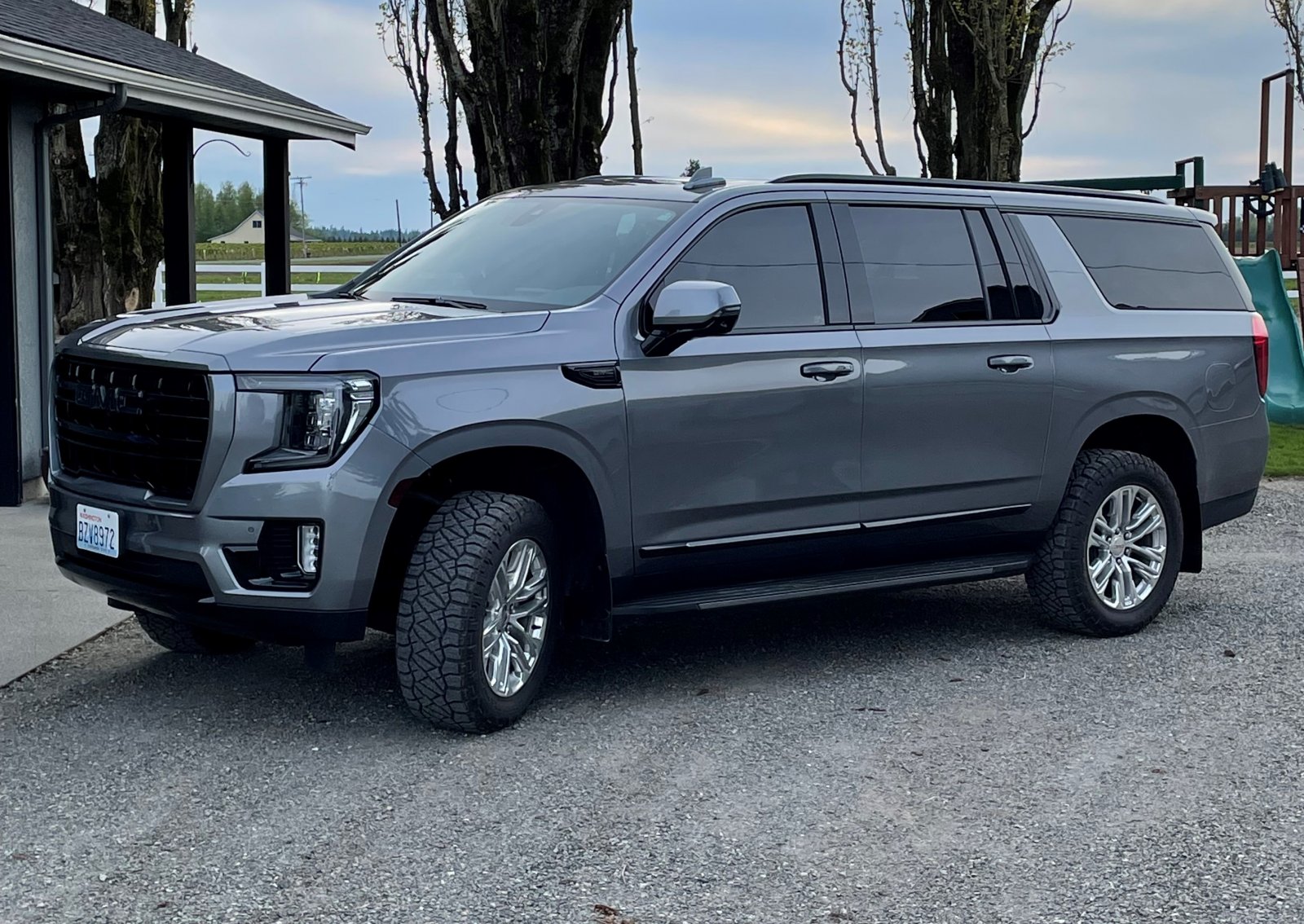

Bought it brand new in summer of '21 with 3 miles and here we are on warranty repair number 5 on this beauty This time it's the rear differential. The vehicle is actually out of warranty (63K miles) but the repair is being covered by our local dealership with little cost to us. It's been making a "humming" sound since about 55K miles or so and changing out the rear dif fluid did not help. That did fix the groaning noise when cold but not this annoying sound. It's at the dealership service department now and they told me the rearend was full of metal flakes. They also told me it's cheaper to replace the entire rearend than try to disassemble it and repair whatever is wrong. Should have it fixed by the end of next week.
Just a heads up it's another thing to listen for. If mine went bad yours could too. This vehicle does not tow anything ever and has just been used as a family hauler. At first it sounded like the rear hvac system was on full blast but that was not the case. I'm pretty observant to weird noises in my vehicles and I was correct to think it was something in the rearend

The service manager told me these difs are not easily serviceable and they would need to purchase special tools to work on it. He said it would be cheaper to just replace the whole unit than it would be to buy the tools and then repair whatever is wrong.
The paperwork says it was the front pinion bearing in the rear differential causing a howling noise and there was excessive metal in the rear differential fluid
