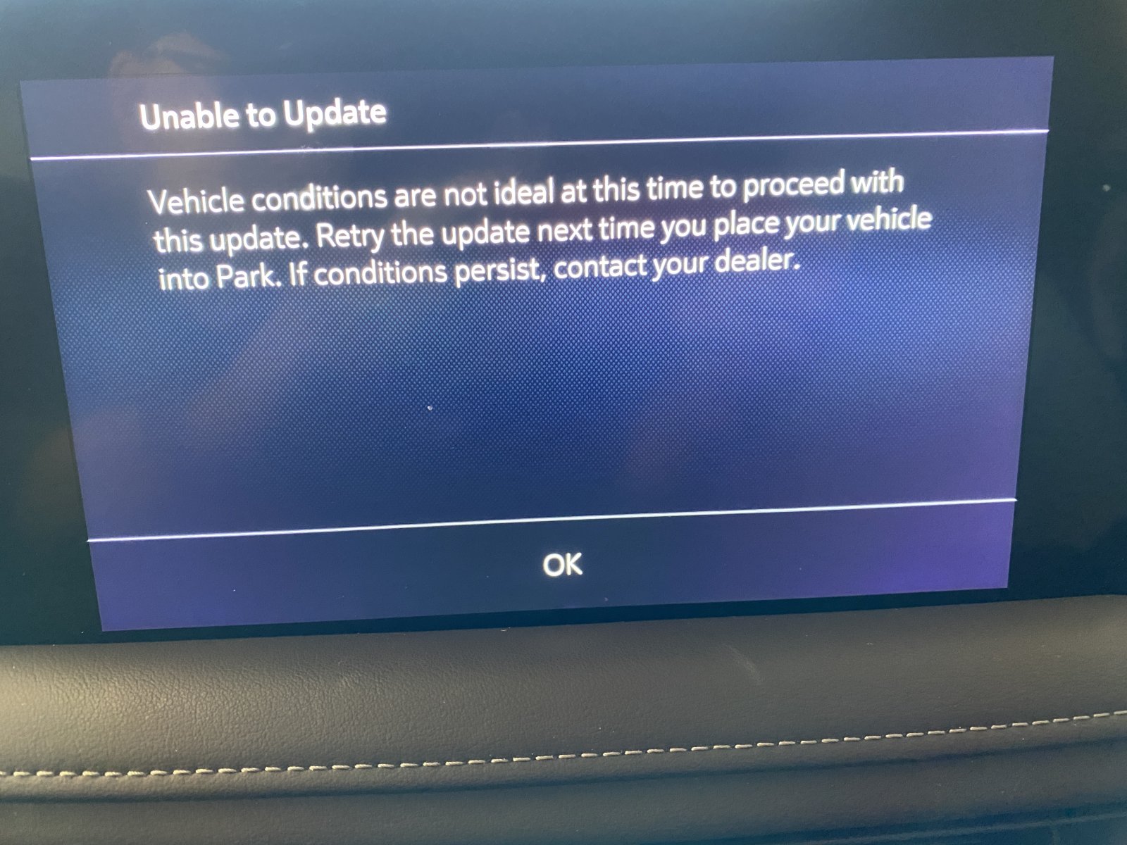

The first time I tried to update I got this when I checked back to see if it had been completed:
Tried for several days and kept getting the same message. So I brought it to the dealer and they said the infotainment system needed updating and they did that. Got it home and thought I'd check for updates again to see if it corrected itself and got the same message!! Tried it again for a couple of days and just gave up. After a about 6 hours of driving yesterday (roundtrip Oklahoma City to Dallas), today after a short trip to the grocery store and placing it into park, up comes the request to do the update!!! Parked it outside to make sure I had good satellite reception and it downloaded just fine. We'll see if all is well the next time I take it out for a drive.

@Thomas Schneider This thread has some good pointers on the updates.
Specifically, I'd read through this link from that thread. It mentions that the ambient air temp has to be above 14F. With the cold temps last week, that may have been the problem.
For my situation, the problems all started the last week in November and temperatures were well above freezing. I'm familiar with the article about the updates and followed all the recommendations. I'm starting to think it may have been a battery issue (State Of Charge), because it seemed to normalize after my road-trip to Dallas that may have super-charged the battery maybe?? However, I never had any problem with the 12V Stop-Start system, so who knows what was the cause. Anyway, I checked for updates again and it says I have all the current updates, so now it's just a matter of hoping they don't "brick" the system as mentioned in another post!
The downloads occur over the onboard Cellular Data connection. The only satellite data going to the vehicle is the Sirius XM radio and the GPS positioning data.
My mistake; I guess I should have remembered reading the owners manual better which says:
Downloading Over-the-Air vehicle software
updates requires Internet connectivity, which
can be accessed through the vehicle’s
built-in 4G LTE connection, if equipped and
active. If required, data plans are provided
by a third party. Optionally, a secure Wi-Fi
hotspot such as a compatible mobile device
hotspot, home hotspot, or public hotspot
can be used. Applicable data rates may
apply.
Since I never renewed the vehicle's built-in 4G LTE connection, I just assumed these OTA software updates were coming in by some other means. Now that I think about it, I believe I did enter my home Wi-Fi information in shortly after I bought the vehicle.
