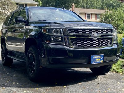

I cut mine to where it’s straight across. I got the idea from here.
