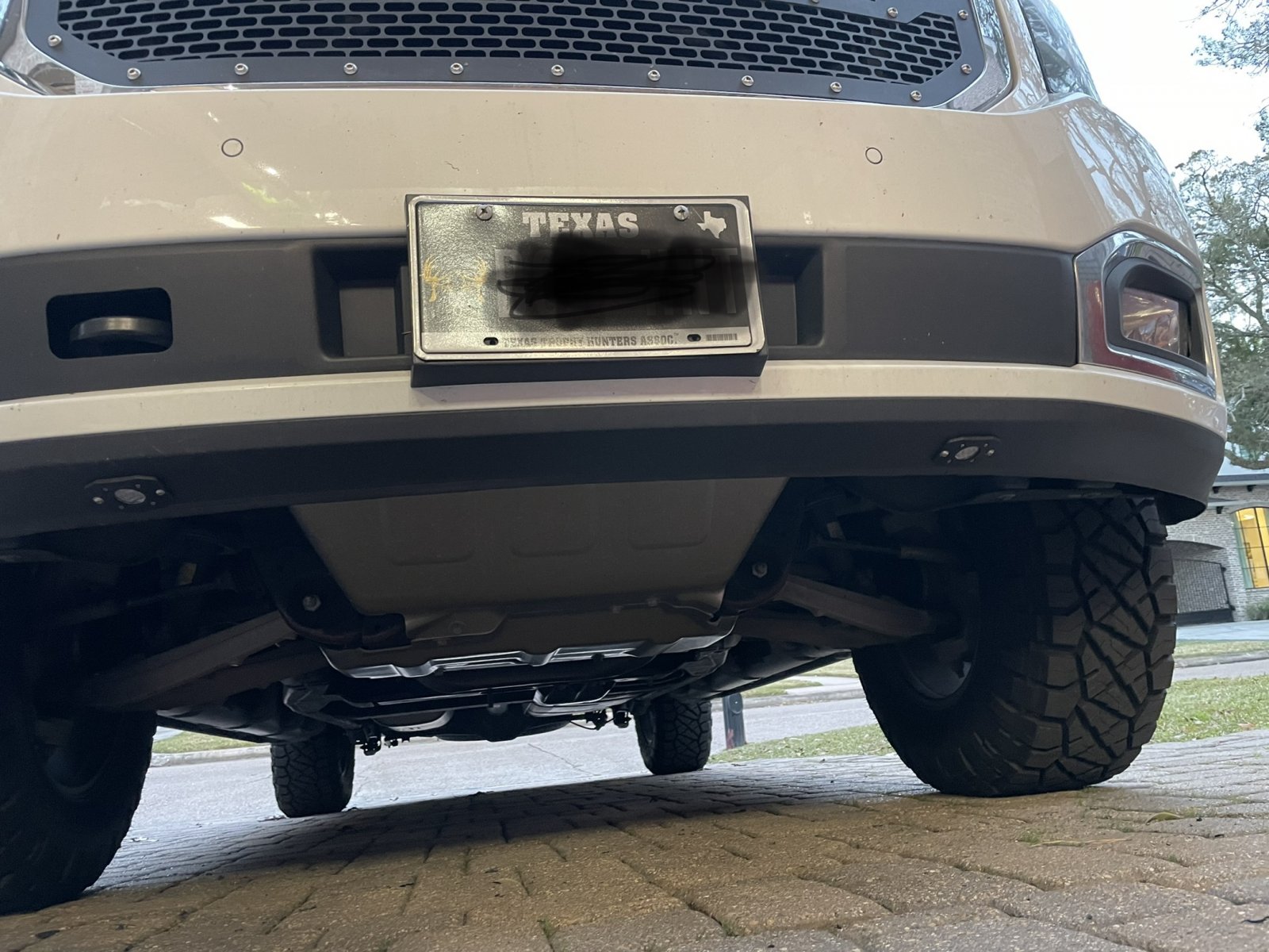

Mine was cut off and it probably looked better that way then those stupid ears hanging down on either end of it.
I don't pull up over curbs in parking lots so that's a non issue but it can drag in deep snow and other conditions.

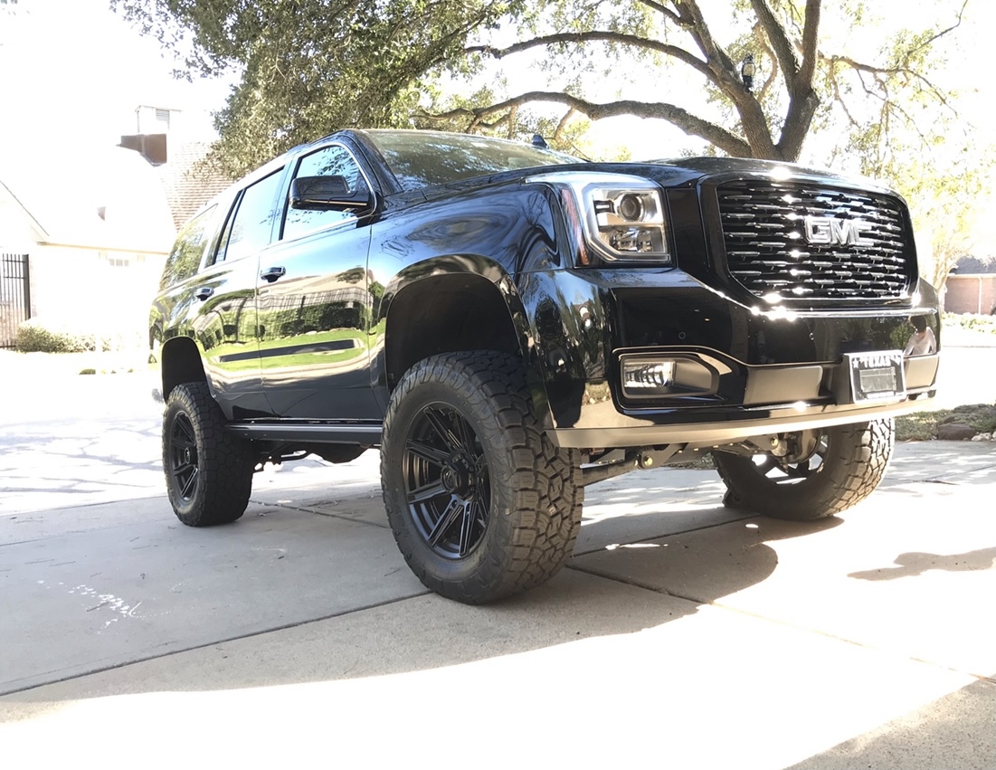

Like others have mentioned I ended up using painters tape, a dremel, and a sanding block to clean up the plastic cut edges. This was on my '15 Yukon XL Denali. I only trimmed off the outside lower portions in front of the wheels so that my air dam ended up just a level height instead of being lower on the outside.
There are a ton of different angle pics here you can check out:
Check out post #868: https://www.tahoeyukonforum.com/thr...-tahoes-and-yukons.86065/page-87#post-1756657
Here's another good thread for reference: https://www.tahoeyukonforum.com/thr...lance-that-comes-on-police-model.90043/page-4
Just measure twice and cut once. It's easy to do in your driveway.
