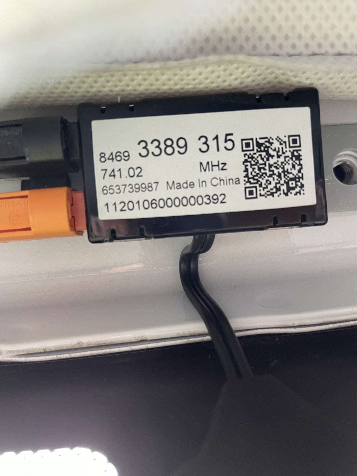

I got mine directly from the dealer, so assume it is GM? Here’s a pic.

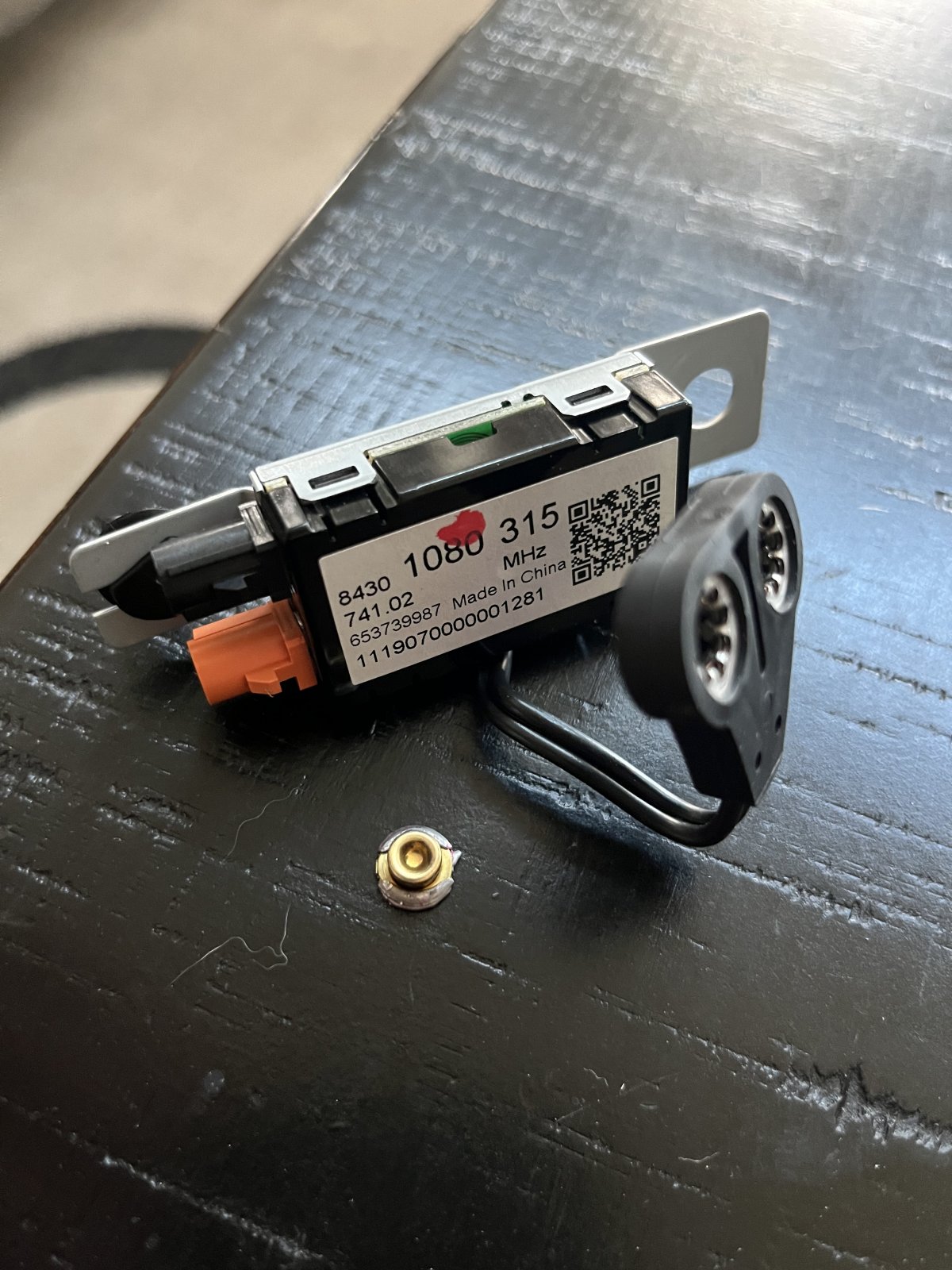

HA! My range blew on my 2020 Yukon and I just finished replacing mine. I was a good 300-400 yards or more away before it stopped working. So the question I have, you see that little button? It came off while I was replacing that sensor. How do I stick it back to the glass?

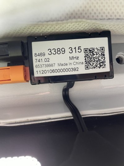

I believe you want to use a conductive adhesive. The metal button that came off the glass is connected to lines on the window (similar to the thermal ones for defrosting the rear glass)
I replaced my antenna and the range issue was instantly fixed - no reprogramming/pairing required.

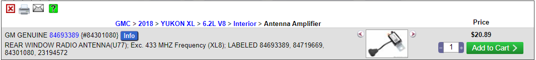

I have the U77 RPO code as well, 315MHz and ordered a replacement antenna from RockAuto

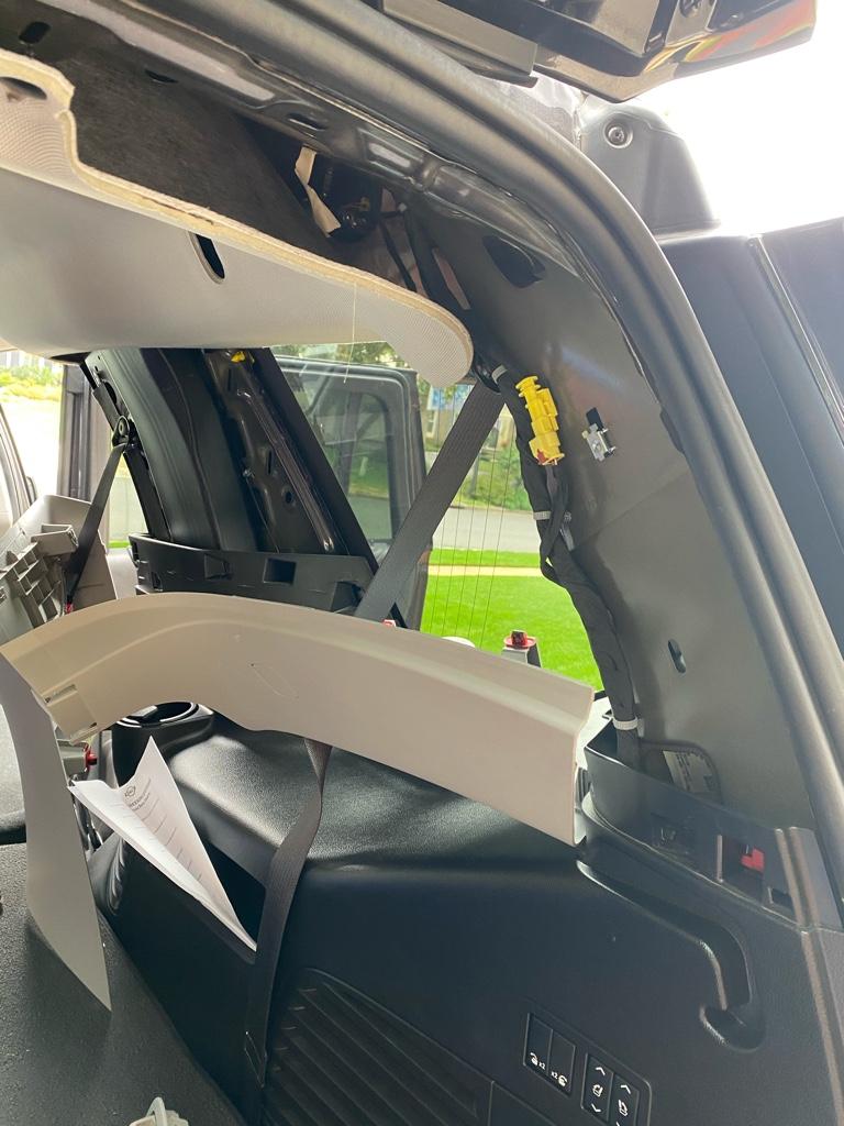

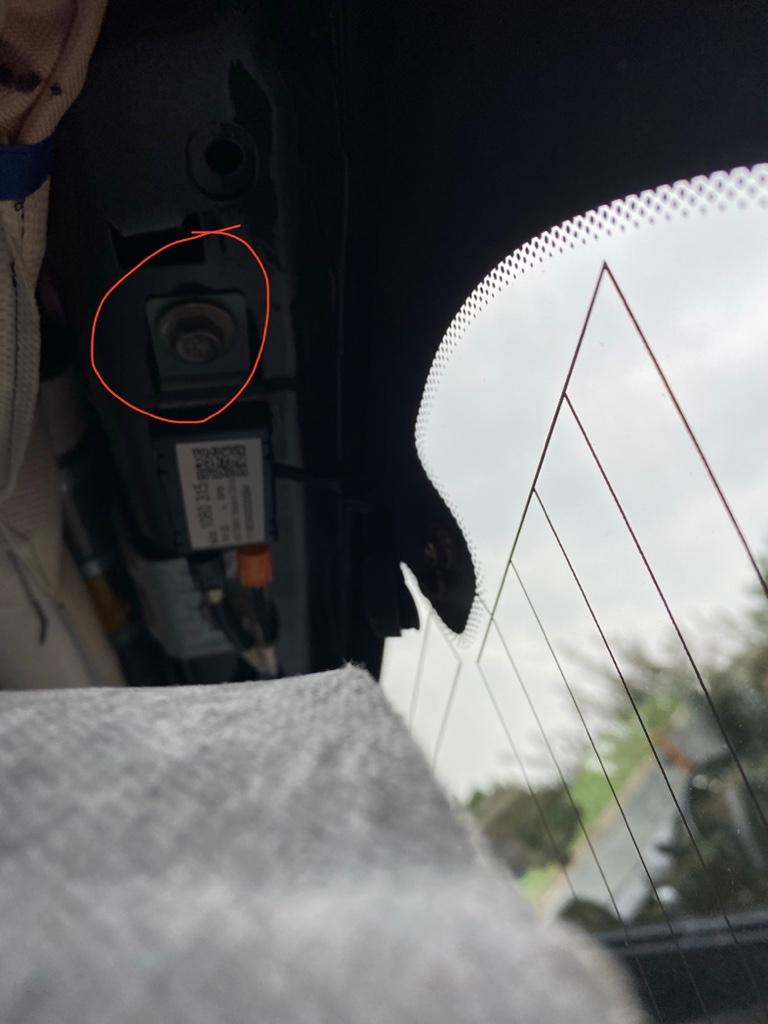

Others have said that replacing it is easier with the Yukon XL since you don't need to take as much of the headliner down. I removed the rear pillar plastic trim (the piece w/the speaker grille) and the top + side plastic of the trunk opening. The headliner came down a little bit but I still had a hell of a time getting the screw out, new antenna plugged in screw reinstalled. The rear seat belt bolt was in the way and I didn't want to remove that...which may have been the reason I had trouble...but o well.
Overall, very pleased with the fix!

None of the part numbers available on rockauto match mine. Decided to order from GMpartsdirect.com instead. Gave them my VIN, so hopefully they send me the correct part. Part was the same price, shipping was a little more but worth it if it fits.

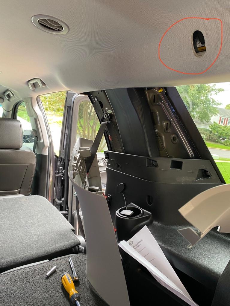

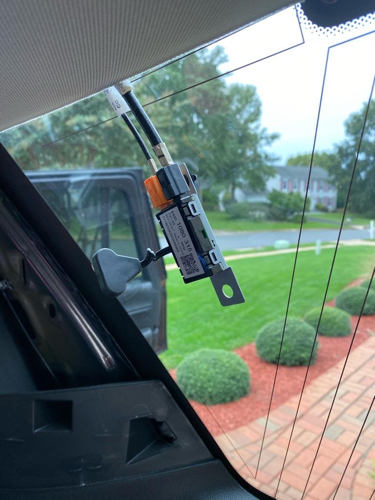

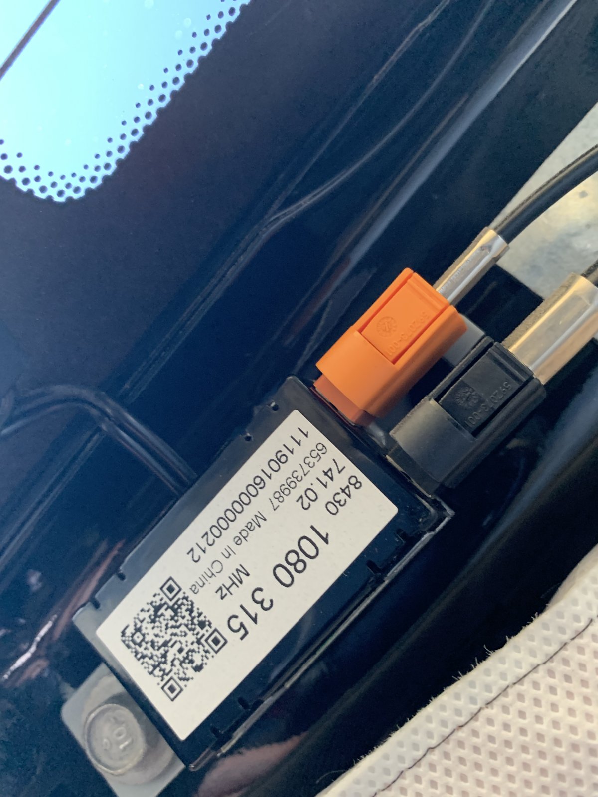

Ordered the Antenna Amplifier from RockAuto and installed it yesterday. Took a while to find it because I thought it was under the headliner right above the tailgate glass on the passenger's side, but was finally able to put eyes on it when we removed the headliner over the rear passenger's SIDE window. I thought the plastic piece that covers that rear speaker had clips like everything else did, however, I ended up pulling it and the piece ripped/broke off easily from where it was glued I suppose.
After swapping out the Antenna Amplifier and putting everything back...tested it out and was able to unlock/lock/remote start from the back of the house while it was parked in front of the house at the end of the driveway. So far, that seems to have solved the poor range issue. Also, went back with clear double-sided tape where that plastic rear side panel ripped to see if it will hold it to where it looks flush again.

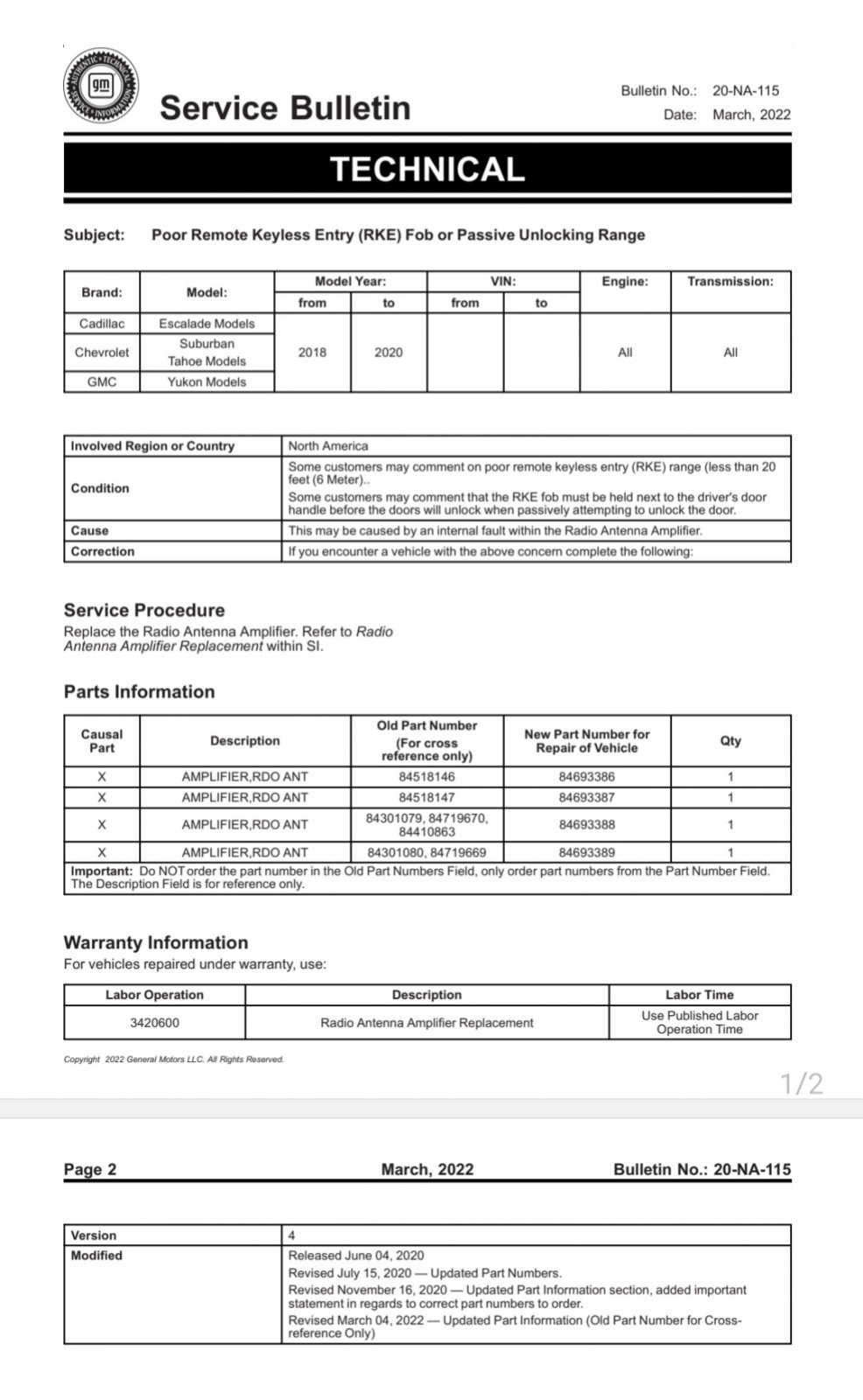

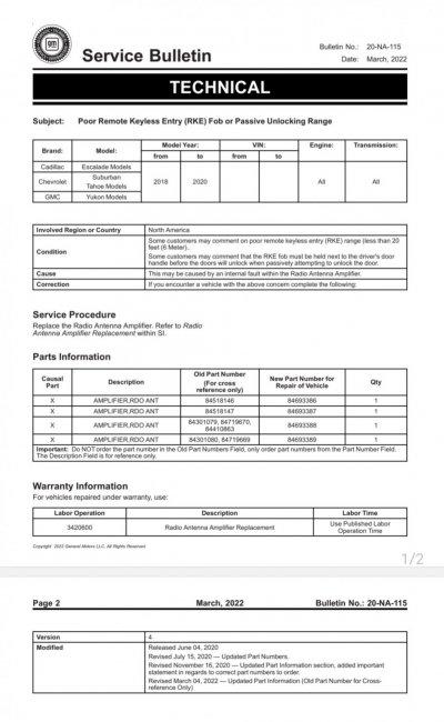

I'm a newbie, I bought an 18 Tahoe RST Tungsten Metallic RWD on 9-8-22. One owner, clean Carfax, 22k miles! We discovered it has the no distance remote issue. I found your forum and your & solution with internet search, thanks. I have the amplifier on order now. I also located a TSB on this issue. I'll attach it.

No need to take entire headliner down. I changed mine myself in 20 min. It’s 20 dollar part. Just need to take some side panels off to lower the back corner of headliner. If you have a burn or xl I think just the back pillar panel needs to come off given there is more play in the headliner.
