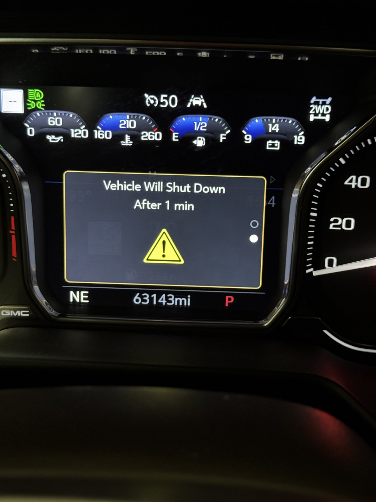

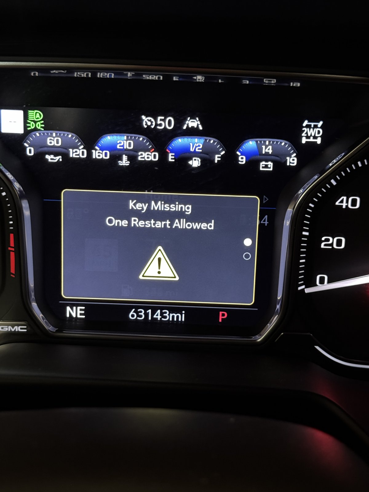

When I went to shut the truck down I got two messages on the cluster.
1. Key Missing One Restart Allowed
2. Vehicle Will Shut Down After 1 min
Now the truck is dead again, it wont start with either FOB.

Here are the two messages I got on shut down.
